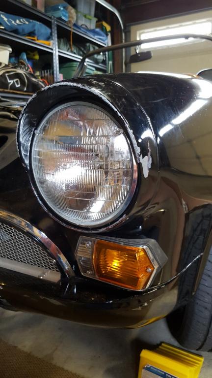

I joined the club of having my headlight bezel fall off and had the joy of running it over myself!!!
Does anyone have pictures of the retaining screw modifications? Or how to properly install the clips from Sunbeam Specialties?

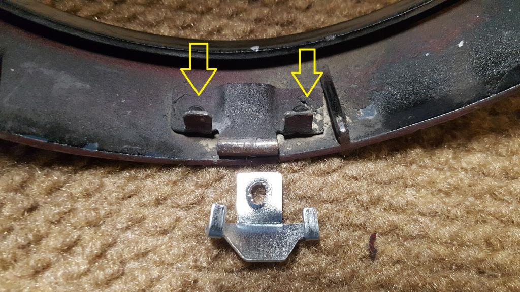

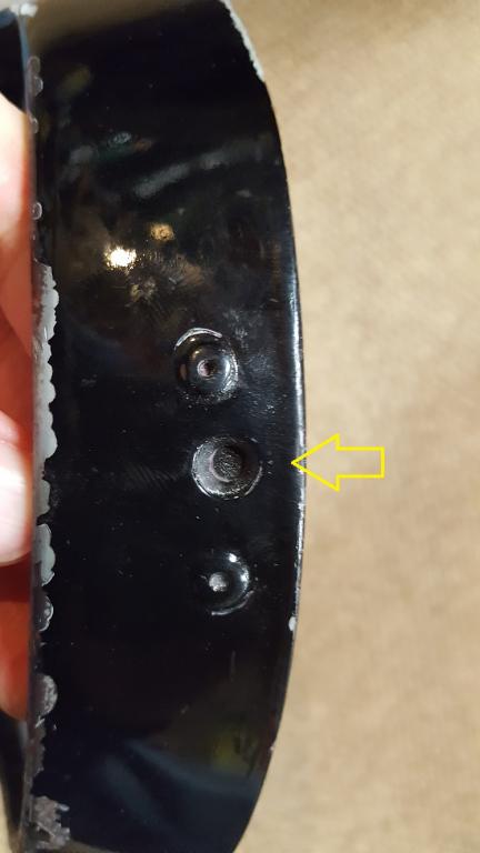

Here are pictures with yellow arrows...not sure where the new clip is supposed to attach... am I supposed to remove that riveted spring clip thingy from the inside of my bezel?
Looks like I have a hole drilled in the center between the rivets already... I'm not sure how the clip is supposed to attach to the headlight...
any help, with photos would be greatly appreciated.

I can't seem to splain it without looking at your pictures but I'll try.
The new clip little holes hook on to two little prongs .
That's what I remember I have a box o buckets try to snap a few pictures today or this weekend.
Long time
Remove the old clip by unfolding the little tabs. The new screw type clip has small tabs that go into the little 3/16" holes. I think I crimped them tighter and cleaned and put a dab of epoxy. I also use the same JB weld to fill old riveted holes thend a little Bondo. I marked the position of the screw hole with two pieces of blue tape to mark outside edges of the screw. Use the smallest pilot drill and a small ruler to shoot for the center of the screw hole in your new clip. Go slow and the soft zinc bezels drill easily.

I think part of the problem is I don't know where the I am supposed to drill the hole in the bezel, is it coming up from the bottom where my bezel already has a hole?
0AmcHI3tcmEmX18bWolAPCZf4YGo9FPTZxBMe0JWbtc-taco5QCPLCR6oBNRTr3fDZOGDSgt8ycj7xncFi7Ku_hS7EG8y59Y8YNo6bxvYWOrFi9O97cxNNQXmSTSNkHCFog4GaFiQ-39EajF54DdB0XaEJ9L1fMatEIiiGrYLKICo4uVd_MYkTezgVVU0Au_QnTv4mZNl6MeghQwqTJ2K5A0D97PbZs820FW-nktMIIO13yBAztB3FjRsjS0WUXou6QNOmyMxqrI_yDtgTiPHRLAykxgREsJWSKZqkYHZHaKe50jleOdCfPpstJcEibdqLP8ANAB5Su49qY_1FyTvKWnIm-w9XLdz2n6xhppLpXFUKcnq-Rq_OnQ5PnF9wWN43mLf-IKkFh_wKiL_VrS7a_iZq-UrX5YZ8wVRH0I6WOS2yX-2JtZMQ0syjXuxe3ay8I-3bb9nqBFdbc7Zz8rD2h9YfdC8fo2H23Yu98KeC4ypM8Xoow3HUguisLNOgfCgf6fZcI4_oQugHnAc8dDgx-qz_sBWXqsqLITWeSPSi8tiNa3e0TqB95EgFXwUvPVOE__4rarJlGLilT1sCA6YrqM-3QkFkwEXrcYSfHfcaFPjwX1FE8ihTqbw13BZ2y5FREKTn_S4QJ0lEVMIiMmxjWVSSGO9r_2yI3GnpQuN-GqaW9IxrDZ1RxX1X-2wQKX=w824-h800-l75-ft
Do I remove the tab that is riveted on the bezel and use the hole it is covering?

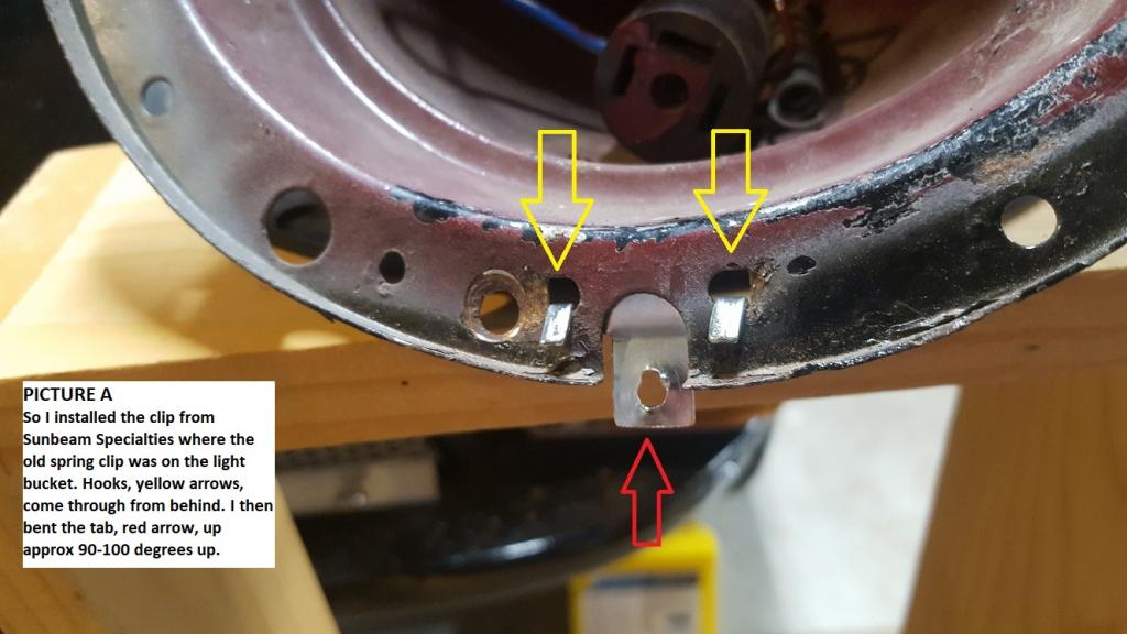

Is this correct placement of the tab on the bucket? Do you bend tab up, red arrow?
Roadpir8
24
bezel saga continued...

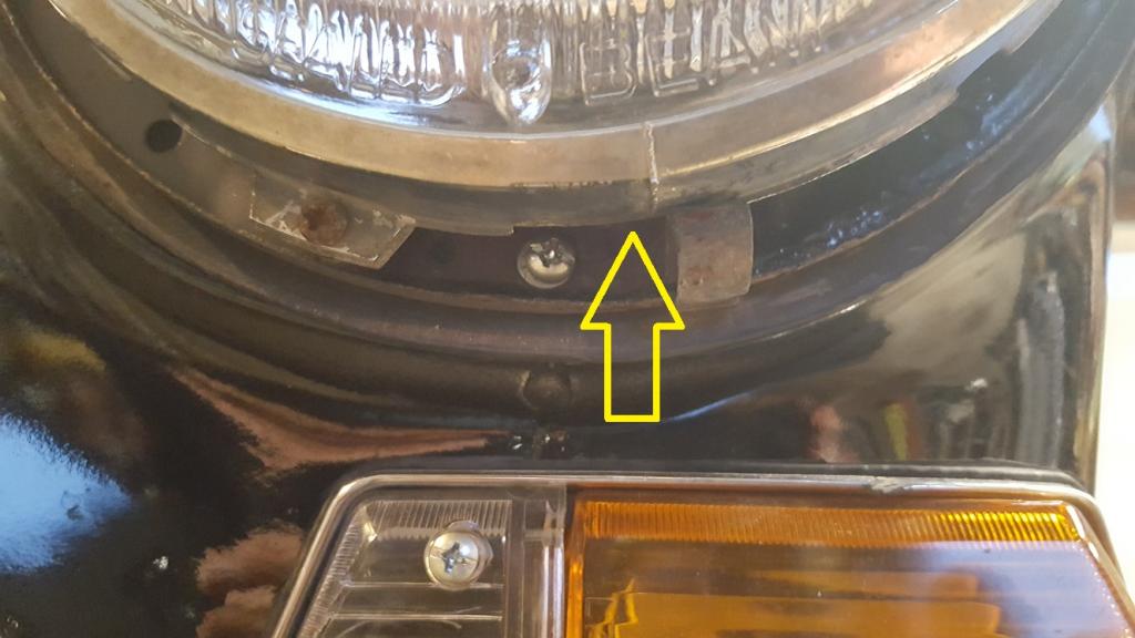

So I installed the clip from Sunbeam Specialties where the old spring clip was on the light bucket. Hooks, yellow arrows, come through from behind. I then bent the tab, red arrow, up approx 90-100 degrees up. PICTURE A

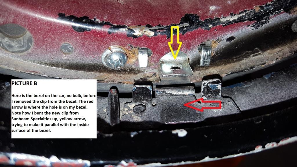

Here is the bezel on the car, no bulb, before I removed the clip from the bezel. The red arrow is where the hole is on my bezel. Note how I bent the new clip from Sunbeam Specialties up, yellow arrow, trying to make it parallel with the inside surface of the bezel. PICTURE B

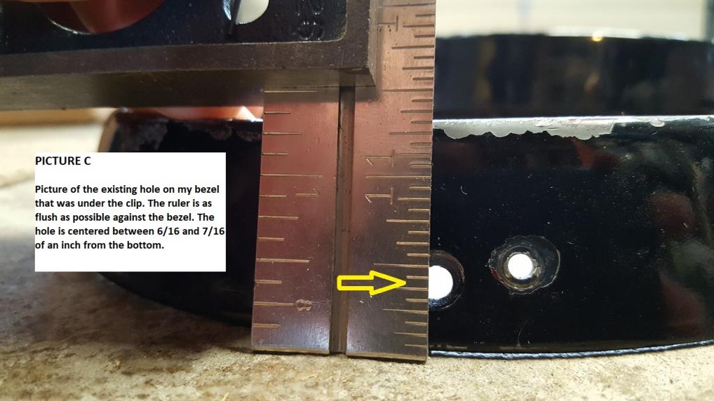

Picture of the existing hole on my bezel that was under the clip. The ruler is as flush as possible against the bezel. The hole is centered between 6/16 and 7/16 of an inch from the bottom. PICTURE C

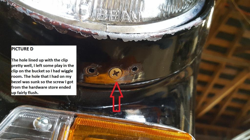

The hole lined up with the clip pretty well, I left some play in the clip on the bucket so I had wiggle room. The hole that I had on my bezel was sunk so the screw I got from the hardware store ended up fairly flush. PICTURE D
Finished! I am gonna test it and see if I can shake it loose before I repair and repaint it. Hope my saga can make it easier for others!!!

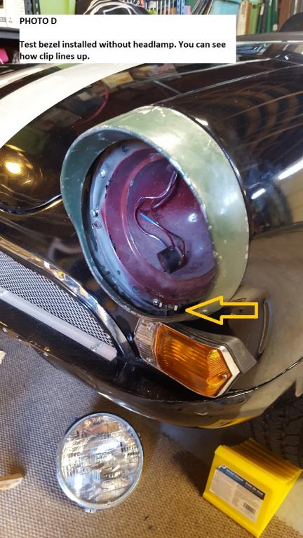

First a picture of how the bezel looks installed without the headlamp so you can see how the screw comes up into the tab, I forgot to post this one before. Attached Photo A.

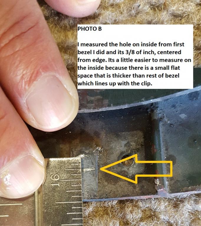

Next an easier way to measure for the placement of the hole. After drilling out the rivets and removing the clip, I found a thicker portion of the bezel centered between the rivet holes. On the inside it is flat so its easier to press a ruler against it and get an accurate measurement. The hole is centered 3/8" from the edge of the bezel. Attached Photo B.

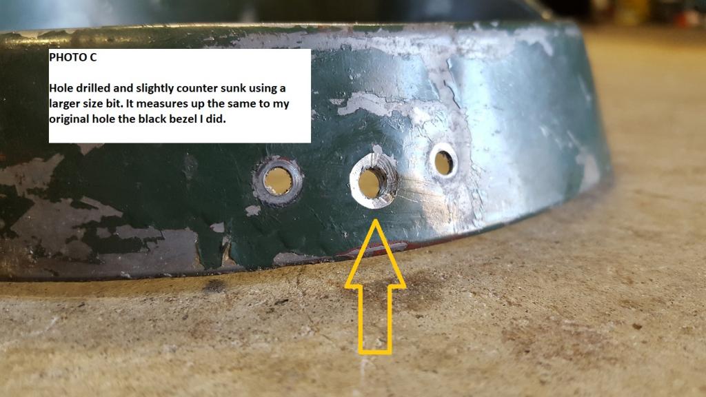

I drilled the hole and created a slight counter sink using a larger bit. CAUTION the bezel is very soft you have to very cautious not to drill right through!! Or just skip this. Attached Photo C.
Installed bezel with no headlamp so you can see the clip and screw. Attached Photo D.
