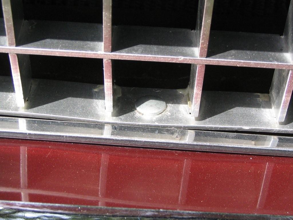

See attached picture of 2 MKII car 135 Unrestored ????
Stainless?
Or polished aluminum? looks like the same size as a 64 Falcon trim ..

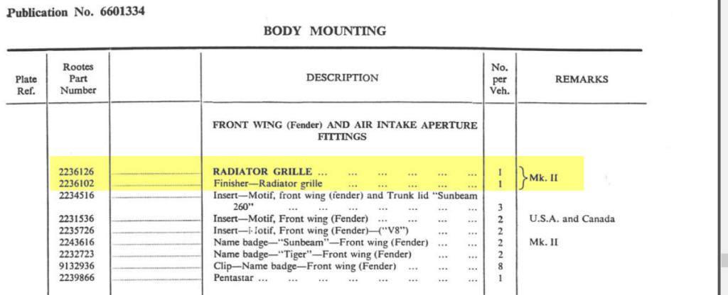

The Sunbeam Parts Manual for 260 & 289 Tigers seem to indicate that the lower finishing strip on Mk II Tigers was the same as that on the earlier Marks and Alpines. We all know that the upper finishing strip was different on the Mk IIs. Sunbeam did not publish a complete Tiger parts book, but published one that supplemented the Alpine parts manual. So if the part was the same as what was used on the Alpine, the part was NOT listed in the 260 & 289 Parts Supplement manual.
Attached is a screen shot of page XF1 of the Tiger supplement parts manual. You will note that there is no upper grill finishing strip listed for the Mk 1 or Mk 1A. The same is true for the pieces making up the Mk 1/Mk 1A grill bar and emblem. That is because those are the same as what was used on the Alpines. However, it does list a grill and finishing strip for the Mk II. Since it lists only one grill finishing strip and we know that the upper finishing strip on the Mk IIs is different, the conclusion can be drawn that the Mk II lower finishing strip is the same as what was used on the Alpines and earlier Tigers.
