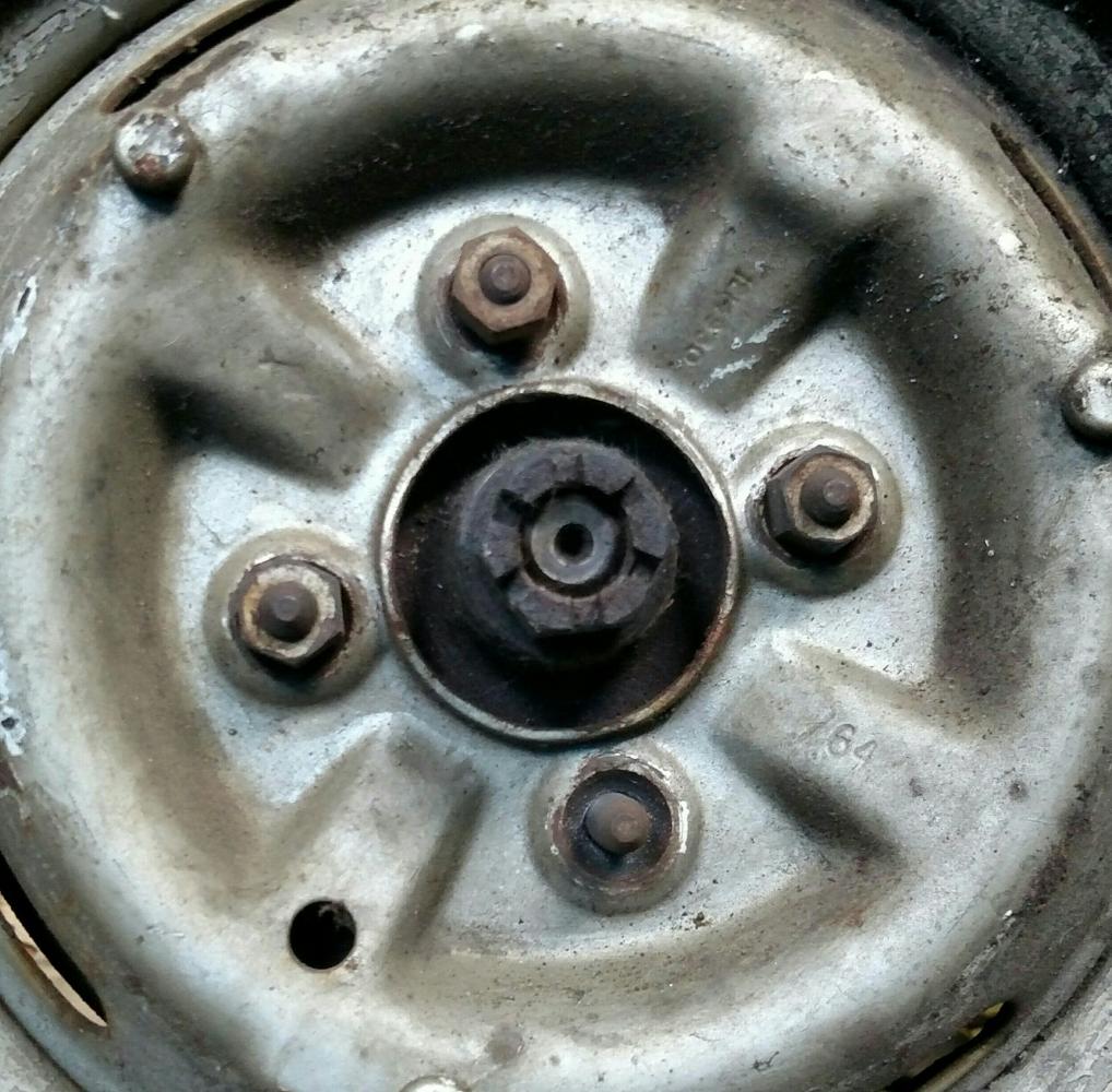

Getting closer
My car, B9471713, arrived with the original steel rims (dated /64), without the strengthening ribs. If Alpine 260 has 1784 with ribs attached that suggests sometime in early 1965 the wheels were updated.
Cheers, Lance.

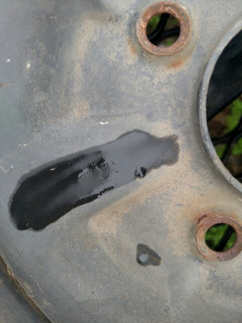

Well for what it's worth, here's my contribution.
This is a loose spare wheel that came with my '66, MK1a (550).
Cheers,
Paul
The "X" isn't actually an "X" as you'll see in one of the next photos, it's part of a diamond shaped logo.
These are from my spare tire, I believe it's original to my car, can't see the part number though.
