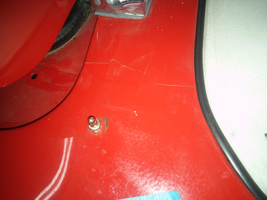

My MkII his at a body shop for a paint refresh.
The body line are cracked around the trunk lid
Is the body line on a MKII should be filled. ( trunk area)
I have looked at many picture with no success.!!!
Clould Please help !!!
Thanks
Gilles

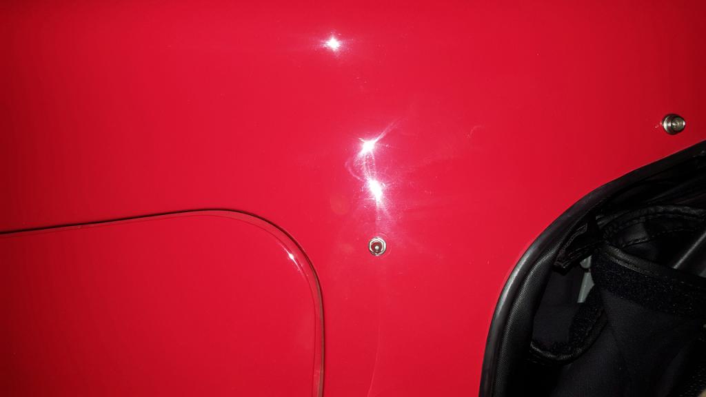

Gilles,
As promised, here is a photo of the left hand side of my Mk II, showing the area was filled in.
Without stiffening things up as Michael suggested, I am not sure of what else a person can do. I would think that plastic filler (Bondo) is more likely to crack than lead is.

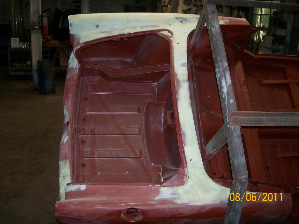

crack line
The lead does crack but there is a solution to the problem. Doug Jennings has restored a couple of my cars and many for other folks. He has always had the bodies dipped and after that he removes the lead from the seams. These seams have only spot welds. Doug welds the panel joints solid which eliminates the flex and after a small amount of filler the cracking problem with the lead is gone. He also added welds to the X frame and other areas where flex could come into play.
