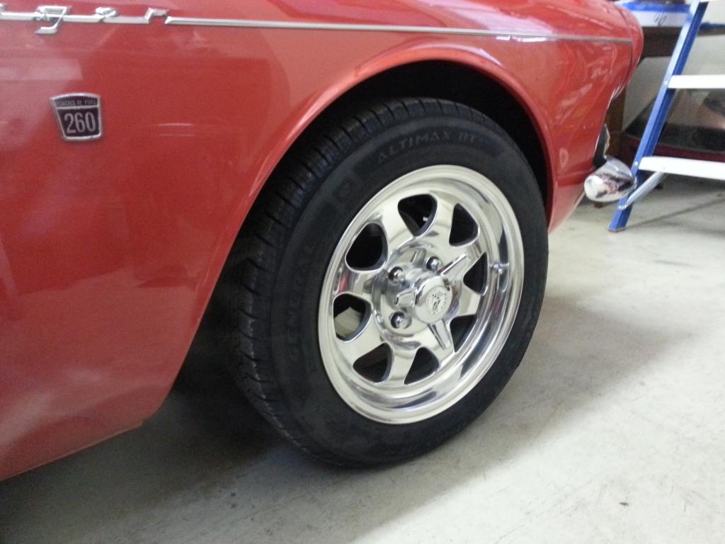

Here's a sample.

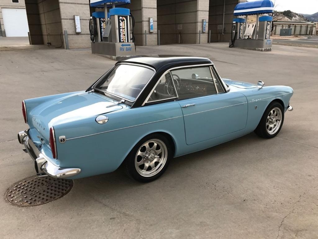

ahetzel
105
Thanks for all of the replies. I got my LAT 50 15" wheels and have them mounted. A few comments. In a perfect world these wheels should have had more backspace. Stock steel wheels are about 30-33 MM offset and these are 20MM. The look isn't bad and the fit in the rear is OK but the wheels in front don't sit in the wheel well, they protrude slightly past outside. I started with a 195/55-15 to try and sized the front down to a 185/60-15. I wish the wheels would have also been offered in a 30MM offset. It would have expanded the options for tire sizes and centered the wheels in the wheel well. These wheels were made by VTO for Sunbeam Speacilties. They do offer other style wheels for the Tiger with a bigger offset.
