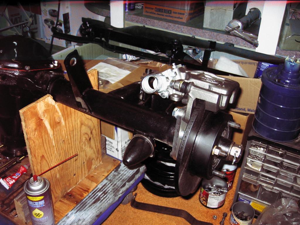

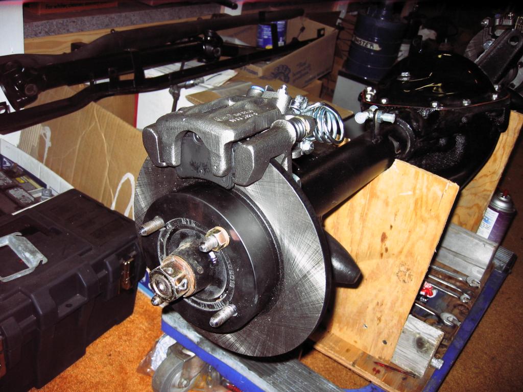

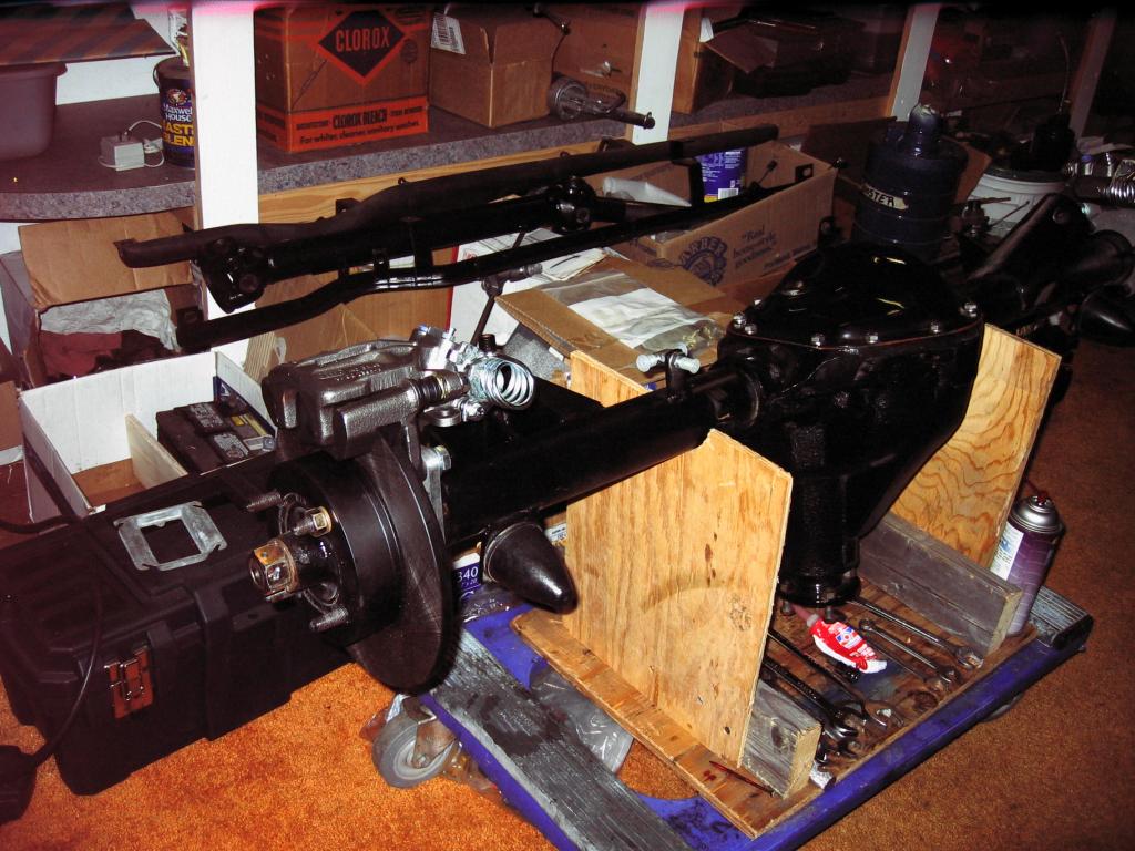

Mustang II discs methinks ??
Did the Mustang ll not use a front hub/rotor combo? Or is this an aftermarket rotor

Those are Must II stock rears with the E-brake lever/cable, etc.

The units in our photo came from Dale as a kit. It both fit and worked quite well.
Hoghead
570
What was the front brake did you use with these rears?
Did you use a proportioning valve?
What did you use for handbrake cables?
