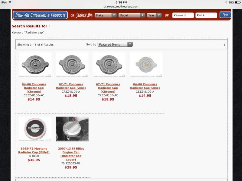

12, 13, 13, 14 across that top row. I'm not even sure which I'm running.
Interesting, they also show the 67-71 being correct pressure
Ah the Mustang supplier Scott Drake. I'd seen some other parts in the past along with Dearborn Classics. Since I can clean the sofa and pay for a cap I'll try em again. Wasn't really impressed on some of the other things they sold me.

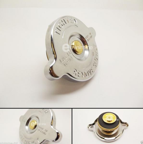

13lb cap
Look for a 1960ā€™s Austin mini 13lb cap, brass rivet in the centre, identical to what was new and fits.
