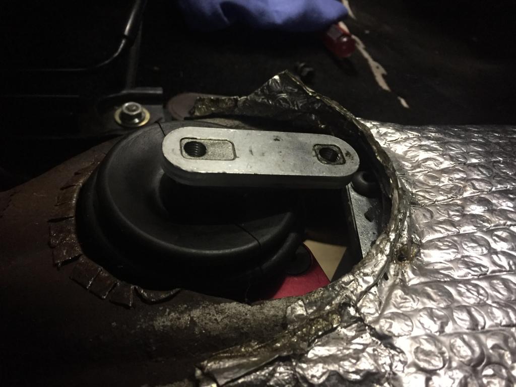

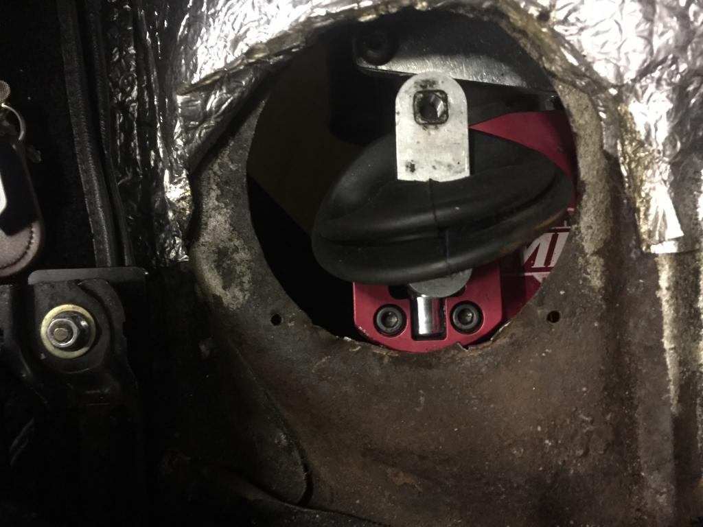

The ONLY tunnel mod was I had to open the shifter hole up at the back 3/8" to prevent pinching the rubber boot that came on the 600. Suspect there could be that much variation from car to car. Did use stock shifter. I didn't measure the height but can't tell that it is any different from stock.
