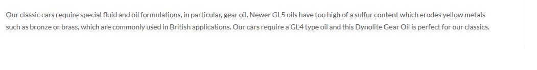

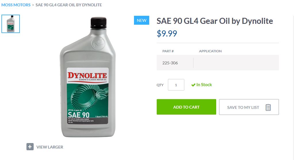

I imagine everyone heard off Moss Motors ( British supplier
They Sell GL4 90 perfect for vintage car
Gilles
