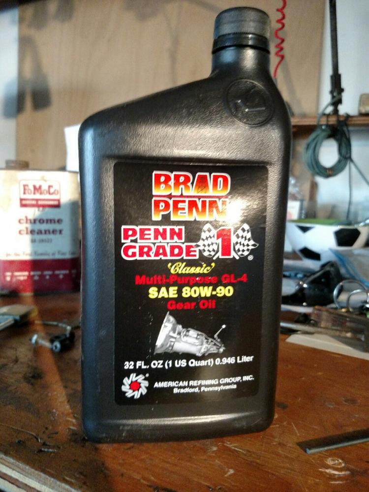

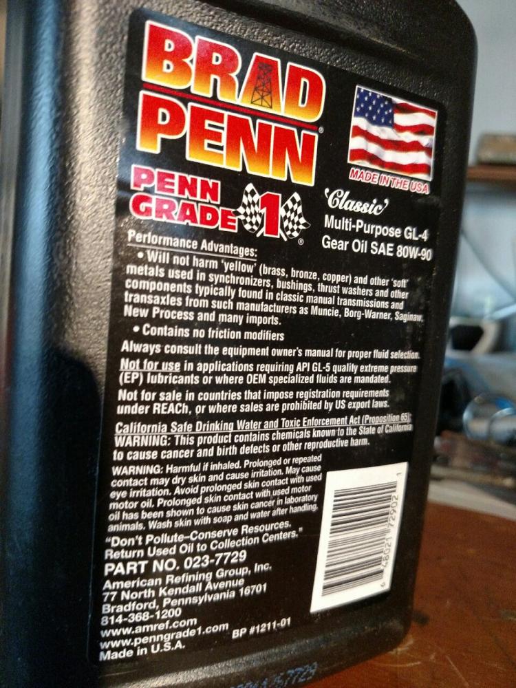

A professional Cobra guy and Paradise Wheels owner, who recently bought a local member Tiger, suggested using Brad Penn 80 to 90 gear oil as it's best for the brass in the top loader.
From the label of the product... Will not harm yellow brass bronze copper another soft Metals used in synchronizers bushings thrust washers and other components typically found in classic manual transmissions and transaxles contains no friction modifiers .

When I googled the Brad Penn I got some hits from Amazon and Walmart. I'll add a picture of the bar code on the bottle.

Also claimed is that they do something​ to the sulphur oils to make them not attack the soft metals, believe it or not. For a few bucks more and given the Federal case it is to R&R a Tiger trans, it's a no brainier.
I have a fresh wide ratio transmission for the new Brad Penn oil. I won't ignore the advice of a builder like Craig.

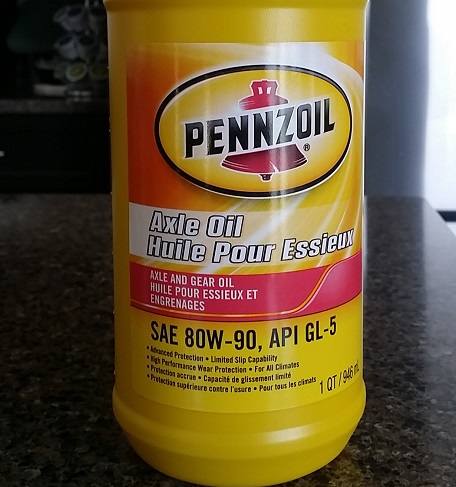

Spent most of the day talking to a half a dozen parts guys and mechanics, one being a guy who spends most of his time working on classic cars, I got 6 different opinions.....lol I trusted the classic guy the most, and he uses Pennzoil 80W90 API GL-5. (see pic) This is a non-synthetic dino oil, as he warned never use synthetic oil in the older cars. I bought some from his supplier and came home with it late yesterday. Then I poked around on the internet some more and came across this article on GL-4vs GL-5 oil. The article is at http://www.widman.biz/uploads/Transaxle_oil.pdf This is an excerpt:

Even though I have tremendous respect for the classic car guy, I got nervous about Pennzoil in my tranny after reading the above and ended up ordering the Brad Penn GL-4 classic dino oil from Amazon. I'm going to use this in the tranny. Now debating whether to use the GL-5 Pennzoil or the GL-4 Brad Penn for the rear end. I was told to use the friction modifier with both of them. I'm leaning toward the Pennzoil, as I drive fairly aggressively, my Tiger has about 370 hp, and I don't think there is any yellow metal to worry about. (shims maybe?) I've never taken a rear end apart so not sure if there is an issue.

Think about this. A lube with a GL-4 spec is intended for use with hypoid gears operating under moderate speeds and loads. The GL-5 is intended for use with hypoid gears operating under various combinations of high speed/high shock load and low speed/high torque conditions. This is the API Lubricant Service Designations for automotive manual transmissions and also for drive axles. I would suggest that you give this some thought based on how you use your car. I won't tell you what to use but let's leave it at this. I have been a lube rep selling to all aspects of the lube business for 30 something years and have been thru lots of training schools of all of the major lube companies so if you find a gear lube regardless of brand that meet the above spec based on how you used your car, buy it and use it. I use conventional engine oil in my trans and 80/90 in the rear axle. This is based on the use given to my cars. If you have a L.S. rear be sure to use the L.S additive.
