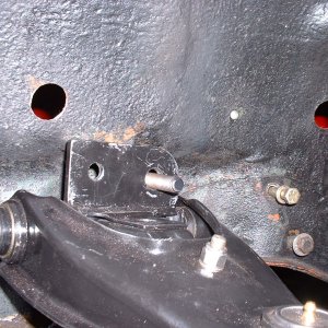

Crossmember brace

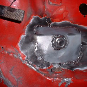

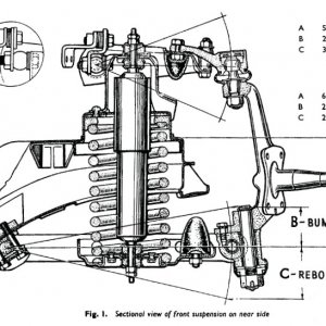

You can see in the 2nd pic that the early Alpine and others have a brace back to the body. Mine is mounted higher yet so will have more leverage to keep the crossmember from flexing. The unknown here is whether the frame rails flex when cornering with the extra loading.
