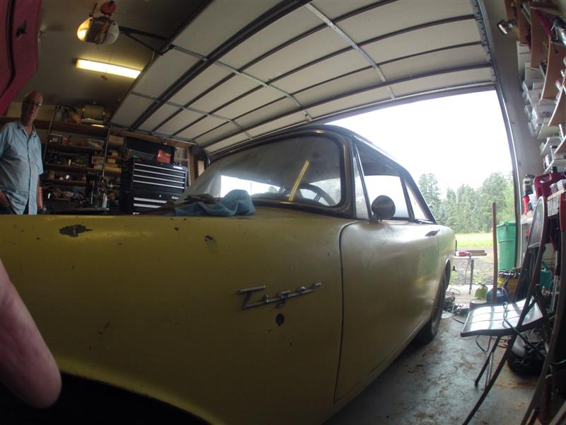

I got to take a look at the car when it was in Pinetop. Looked like it had an interesting bunch of parts with it and not too bad of shape. Good luck with this come back to life project. Looks like you have already made good progress.
Thank you for that picture Charlie! You got Jim in it too with makes it special.
Jim mentioned that he had talked to a few Tiger people, but I thought that I was the only one that had seen his car. Clearly I was was wrong.
I am lucky enough to have Jim's car as a second Tiger and just hope I can bring it back to stock as I think he would have liked me to. I don't think I can do a full restoration, but with all of the options it has, I will shoot for a 'tastefully modified' presentation. Are you the guy who lives in Phoenix but visits Show low during the summertime?
