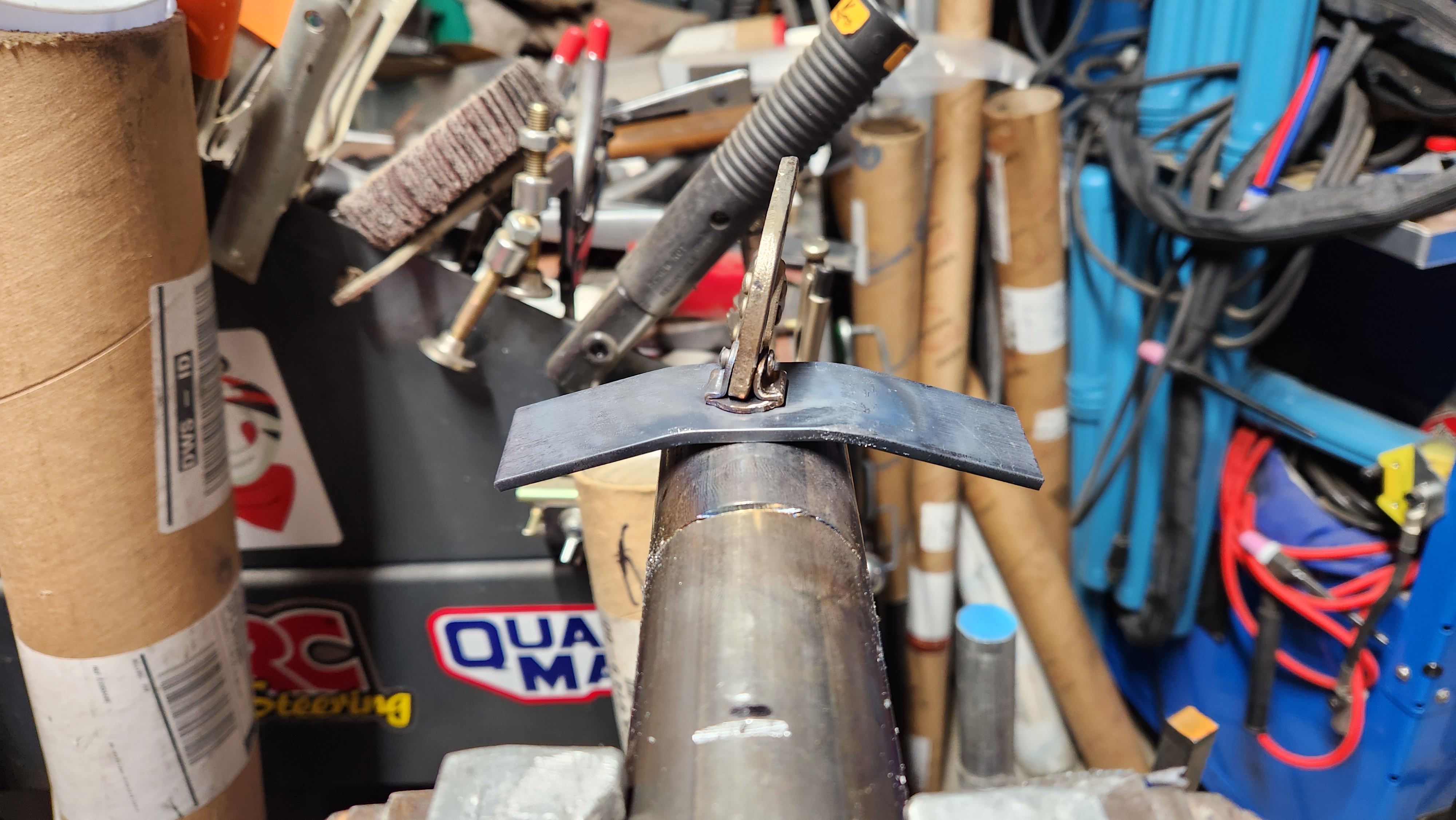

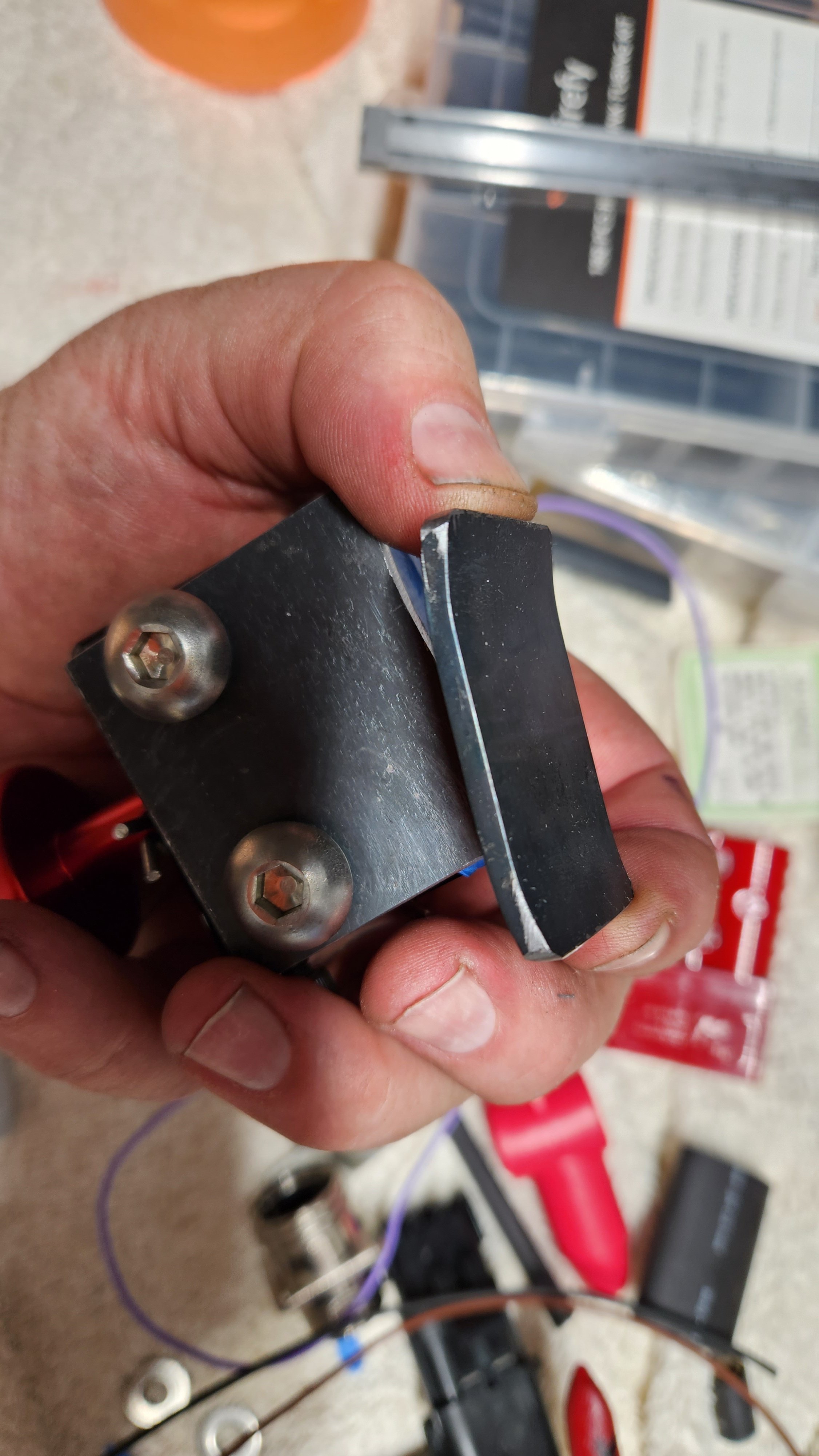

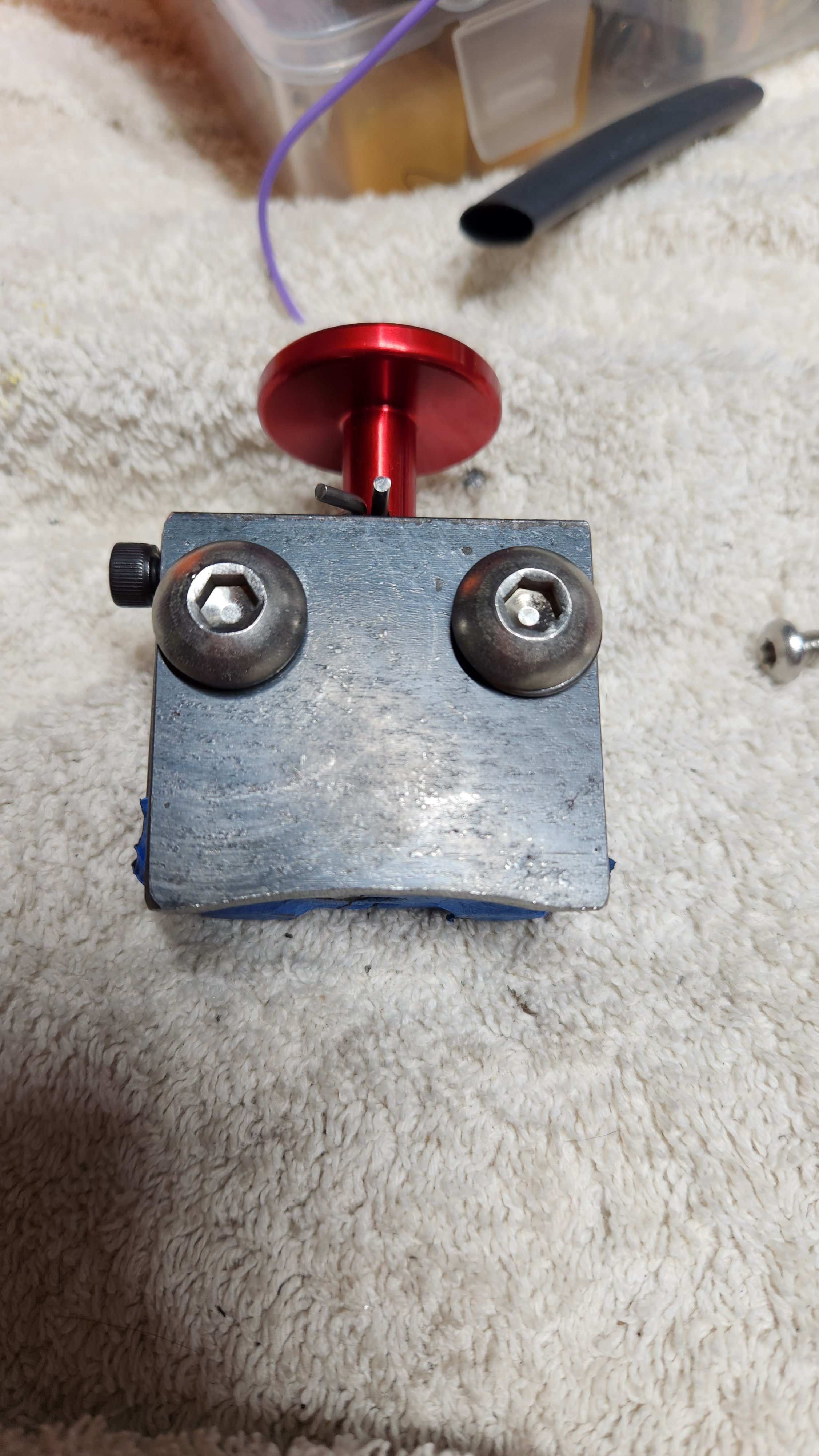

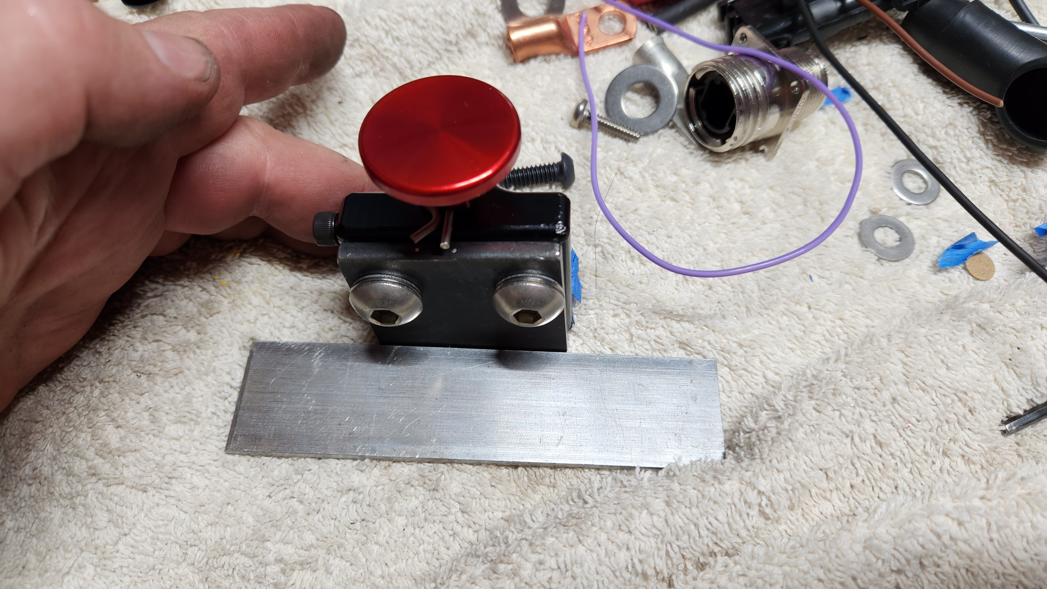

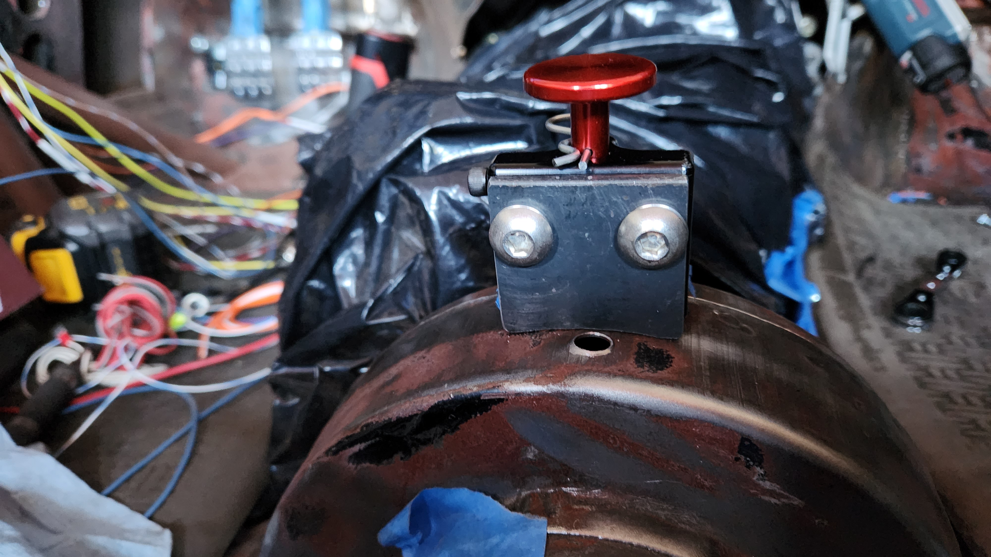

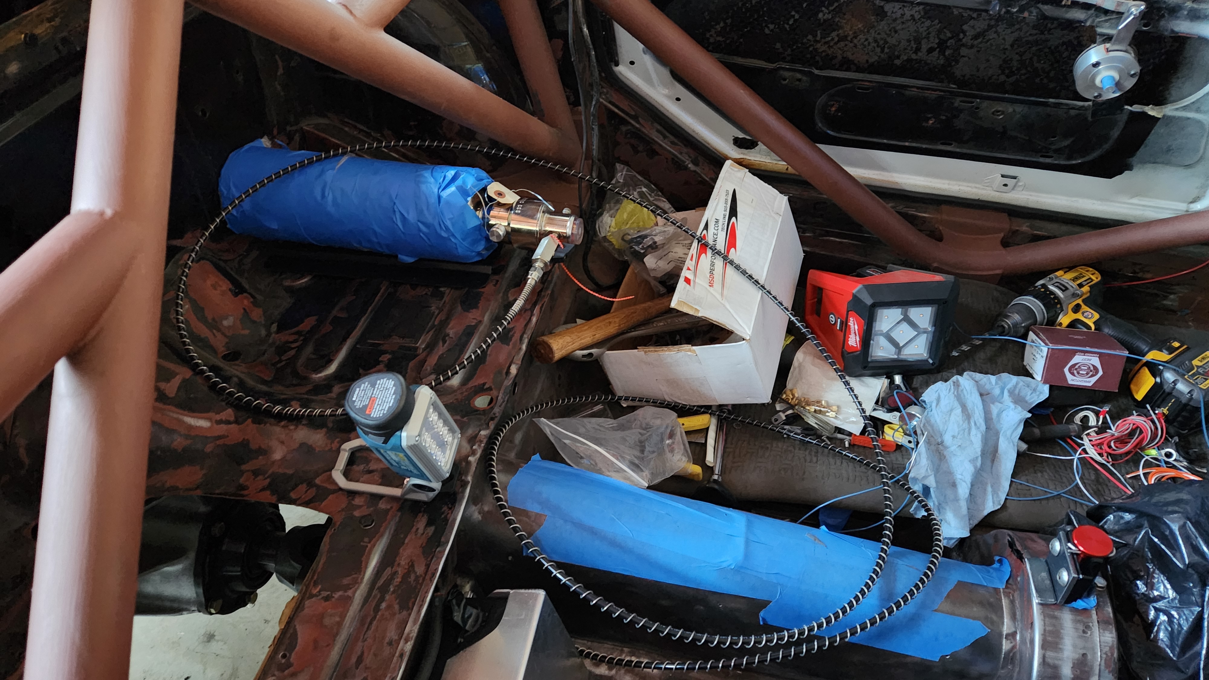

Blue tape wrapped tank is filled with a magic liquid fire suppressant. The tank and a heat sensitive pressure line wraps around the driver area and if the tube melts the system releases. The manual control is a button that simply pierces the pressurized heat detection tubing. Making a mount for that. In easy reach means transmission tunnel. Mount need to be strong as this will take some abuse in the event of a deployment. Mount has 2 holes for 10-24 screws but not strong enough going through the sheet metal.

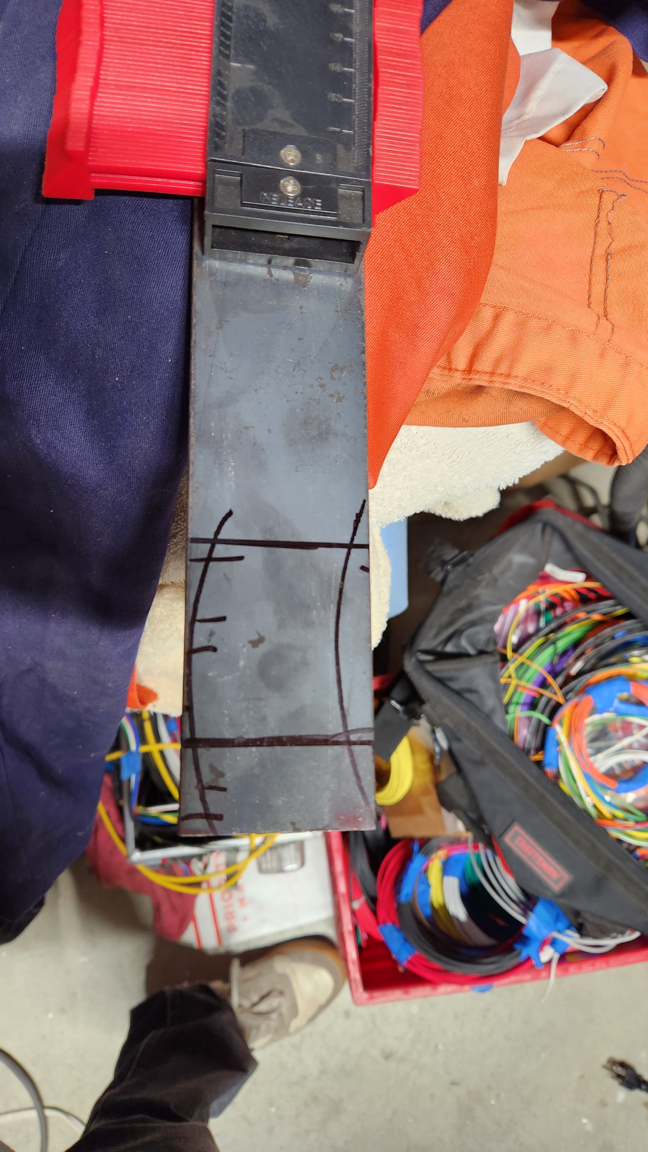

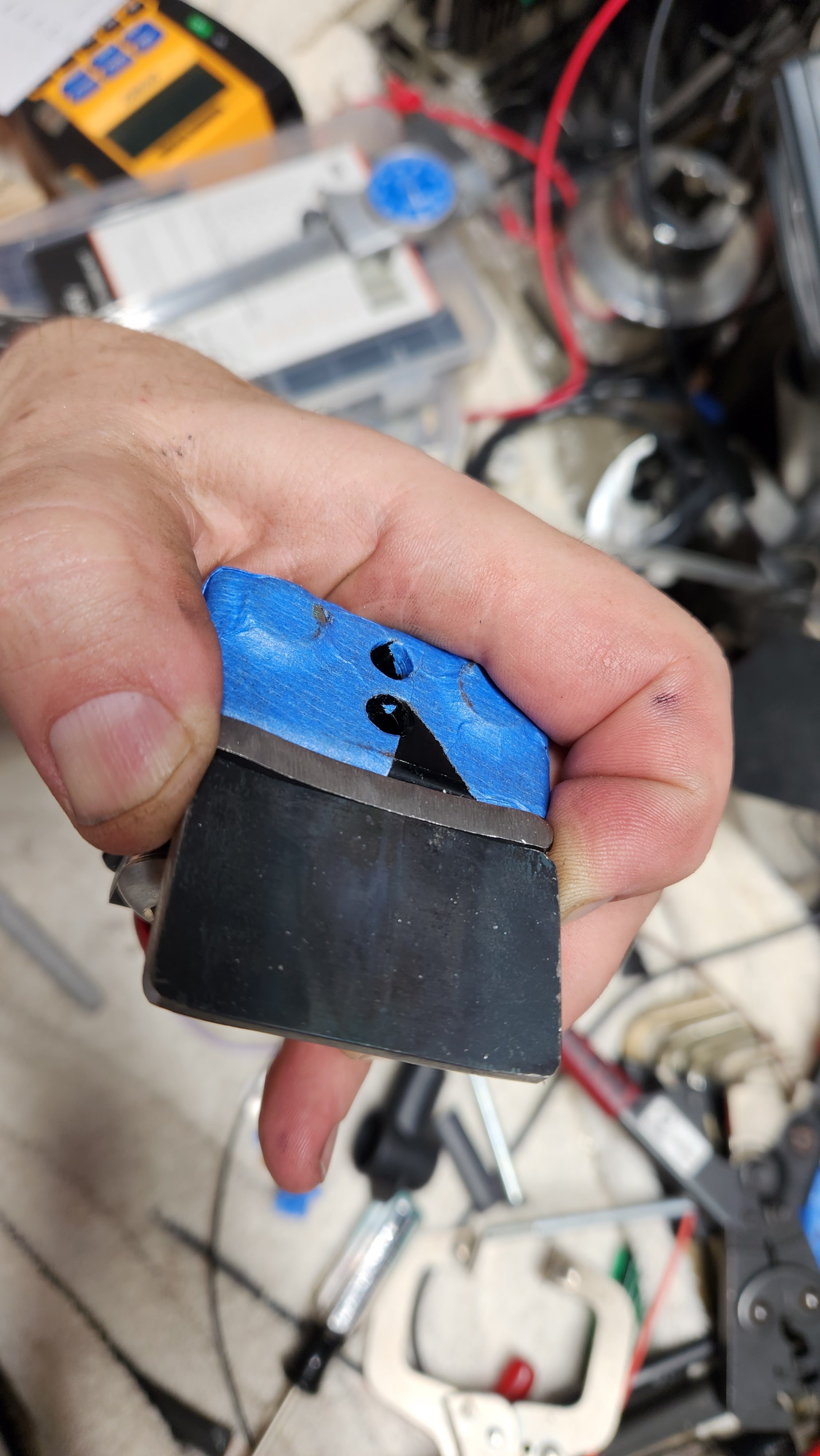

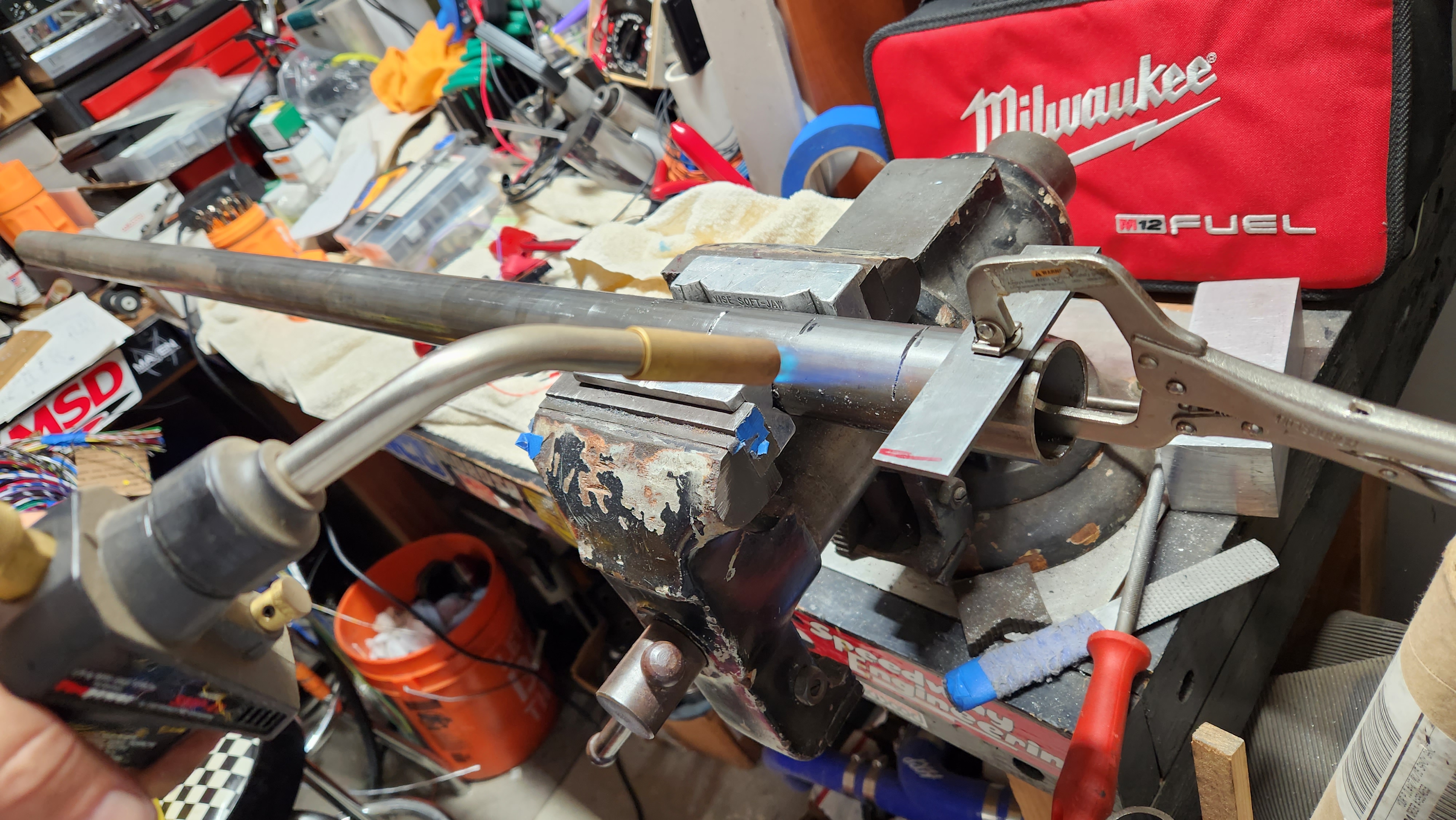

Adding a bracket to the existing holes in the button. Need to curve things a bit, drill some holes, weld and paint still, but seems good.
