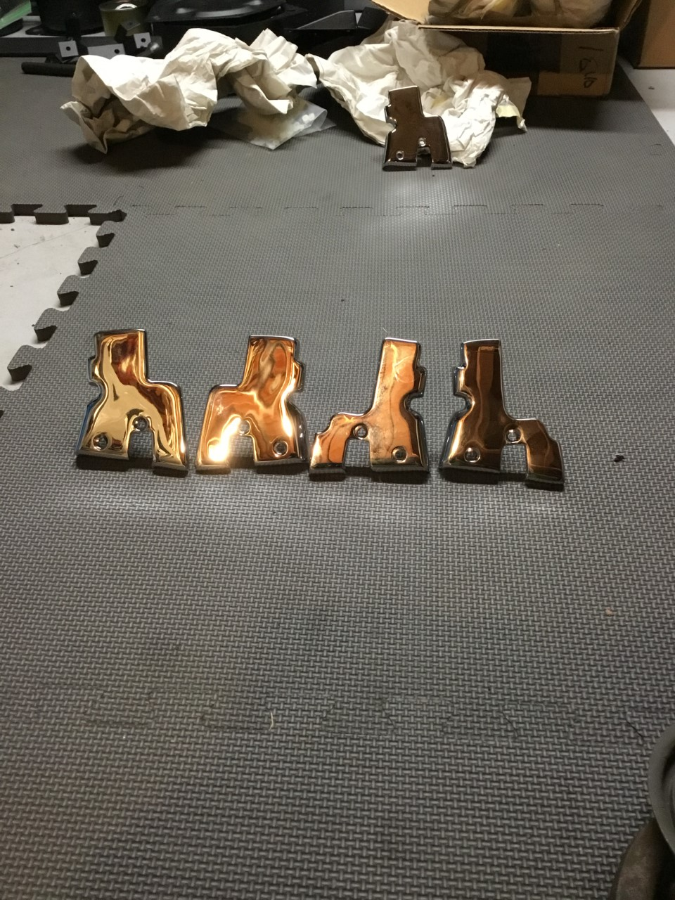

Over the years I have seen both widths of B-Post caps on early & late cars. Was there a cut off date or serial number change?

Yes... If tbey are on an early car its a retrofit either due to availability or someone not wanting shipprd door tops.
The thinner verison was introduced at the start of series V alpine... So MKIa tigers. The B32 cars are the first ones to use them. The cross body cars still ran the thicker B post.

My parts books shows the change to the small one was made with B395004201 for ST Alpines and B382000379 is listed for 260 cars which I guess would be a Tiger reference.

Ponder this: Our original (from new) B382000078LRXFE came with the narrow caps. In the barn is B382000004LRXFE with the fat caps. I have found several drive side narrow caps that are cracked or broken where the fastener screw hole is so close to the edge.

Randy, the narrow B post do have a habbit of cracking where the screw goes through as the casting isnt as strong as the early style.
As stated the SV and MKIA had the narrow ones as a design change. I would assume this was to stop slight door misalignment causing the B post to chip the door paint.
Its possible your very early mkia Might have had the early style caps fitted ..but i would think more likely they were replaced at some point as you often see late style on early cars (even s3 alpines) and even mixed sets.
As a side note rootes also had 2 types of B post on the early SI/II alpines... Either they were really bad at getting B post design right... Or were chasing the perfect B post cap šŸ˜›
