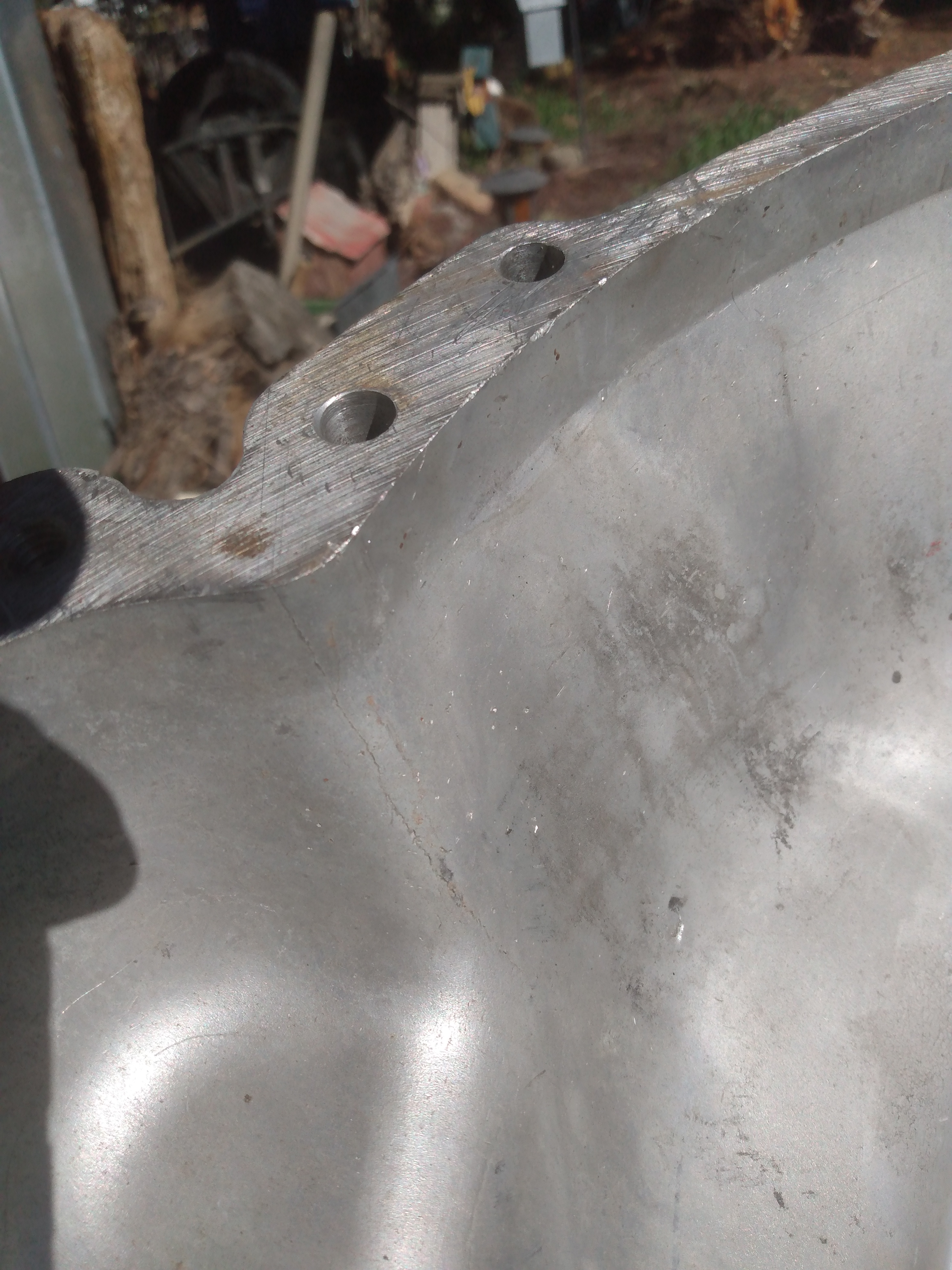

spmdr
367
Exibit C or F
I call this a casting flaw. It's very common on 5 bolt bellhousings.
DW
Tiger67
14
Yes on the casting flaws. When I cleaned up my housing I thought it was done for. On closer inspection, not one of the "cracks" went through the casting.
