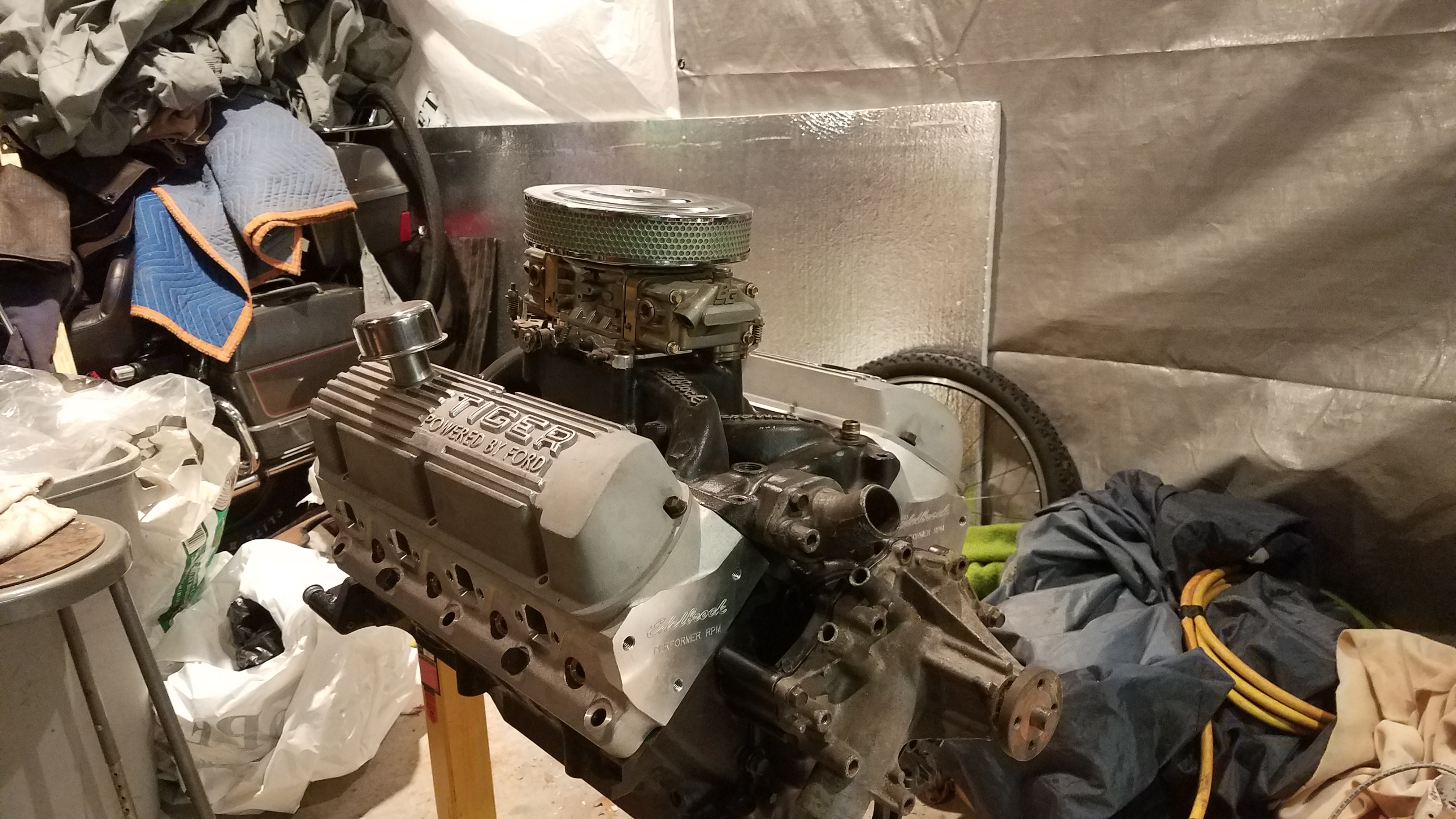

Got the heat going in garage today starting to work on motor again should have been done last winter but still waiting on my comp cam (back-ordered) new estimated time end of January. Have an aftermarket water pump I took off a 1964 289 motor and need to have the hub pressed back for pulley alignment I'm not sure if you press the shaft or just the hub where fan attaches. I still need to install crank and assemblies to see how far pulley is off but wanted to install cam before crank. I know the reg and fan pulleys are off Iam using Edelbrock aluminum heads but wouldn't think that should matter. The fan hub on this water pump is the same distance as the one that was on my 260 motor that had a water pump from 64/65 c5ae-8505-c don't think pulleys aligned than either Thanks Kevin

You do want to move just the hub where the fan attaches. I figure the distance I want the back of the hub to be from the nose of the housing and use a block of that dimension to temporarily sit there and press the hub against it.
pfreen
420
You need to press the hub. You also need to support the shaft on the impeller side so you don't press against the bearings.

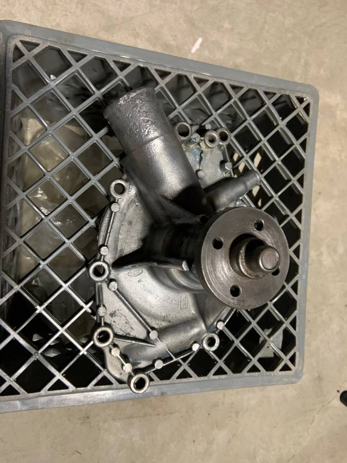

Just wondering if this would be the correct water pump for a tiger. It has a 1-inch sleeve on it.
Have not seen this one in person looks like it might be pressed on, if its correct for a Tiger thought I'd pick it up since I don't
have one. My Tiger didn't have one when I got it so have never seen one. Thanks Kevin

Randy I'm going to take your thumbs up as a yes for tiger pump or at least the adaptor is correct for
a tiger fan pulley/fan. The hub has also been pressed back who knows if it's correct. Last question can
the adaptor be used on another pump Thanks

Yes, it's a correct hub and they were pressed back to about the distance of a nickel. I WOULD NOT trust the seals in that old critter. The hub can be carefully recovered with the correct press tools and installed on a new pump. CAUTION to press bear only on the inner shaft so that the shaft & seal position is not disturbed. I have extra Tiger hubs if needed.

Thanks not planning on using my fan is 5/8

"The hub can be carefully recovered with the correct press tools and installed on a new pump."
Be careful, not all the shafts are the same diameter, if off too much the hub can crack.

Add Note: The press tool (aka clamshell) should sit closely around the shaft so that pressure is not exerted on the outer flange area. You are correct in that improper press tool location will (not maybe) crack the hub.
