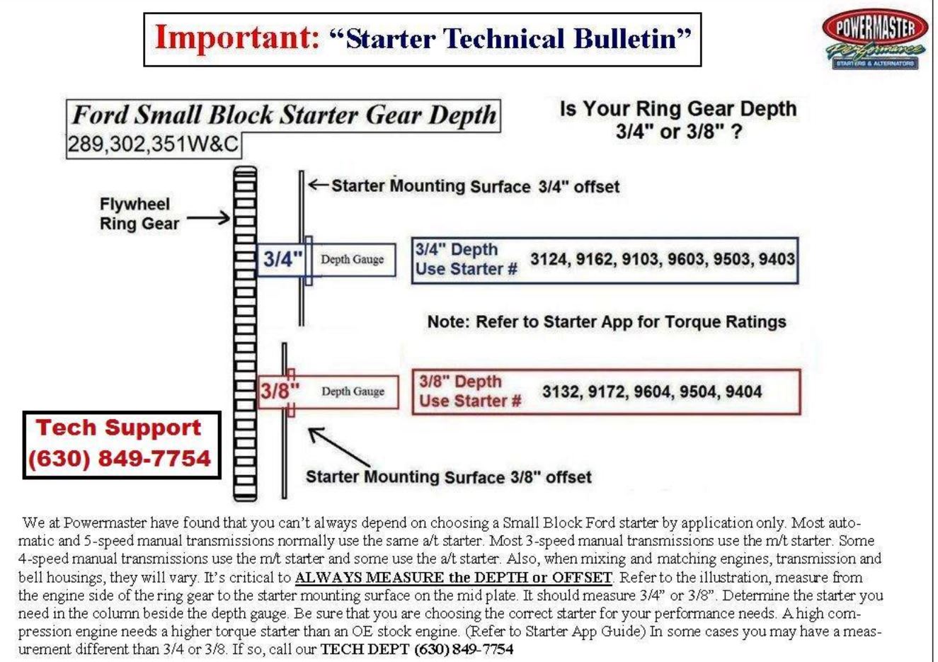

I went with the 9603....
Thanks for the replies. After talking to a tech guy named Tom at Powermaster... he steered me to either the 9103 or the 9603. I opted for the 9603 which I found for less than $175.00 delivered and no tax.
If you take a look at the attached image... you will see a straightforward explanation re. fitting one of these mini-starters to a SBF. Lots of potential flywheel / bellhousing, engine combo, etc. But... in my case, the key is the 3/4" offset (measured from the surface that the starter mates to - to the front surface of the ring gear). Some will measure 3/8".
The 9603 is "clockable" and all you need is a jumper wire of the correct gauge to link the two terminals on the starter.
Hope this helps others who might be looking for a new starter.

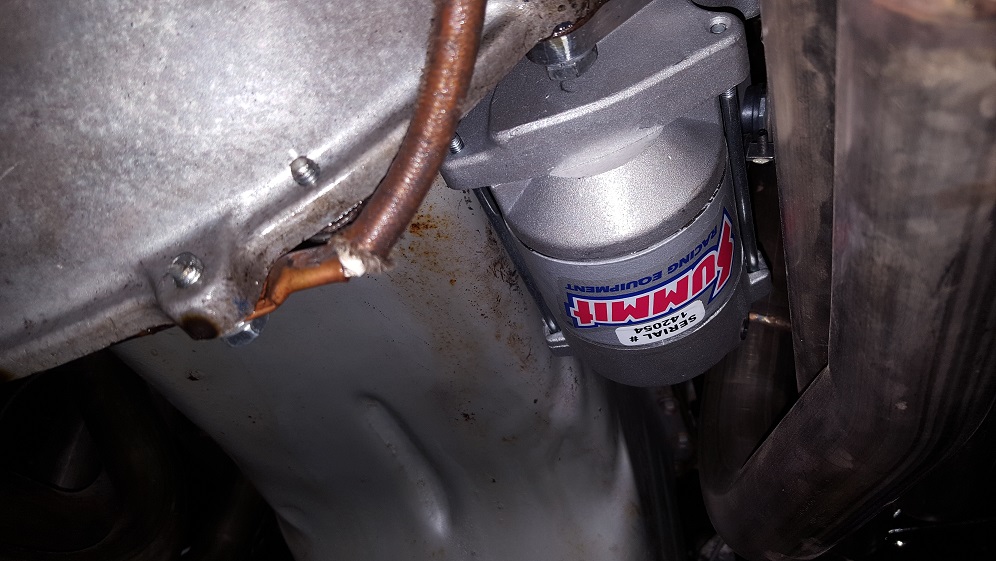

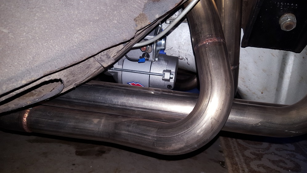

I went with the Summit Racing® Protorque Starters, SUM-820055, when I installed my CAT club headers. I have a 6 bolt 289 in my Alpine Tiger conversion.I have had it in since about July of 2017 and have not had any problems with it.
HTML:
https://www.summitracing.com/parts/sum-820055
