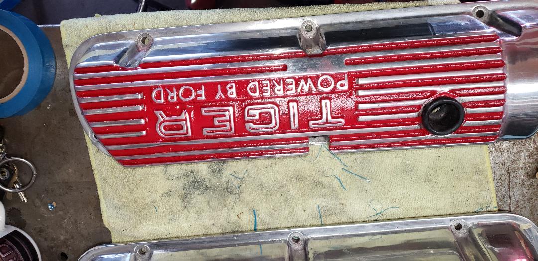

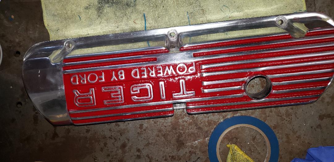

maxwell smart
28
I polished and painted mine. Some final clean up and I can reinstall them. It was a fun project.
