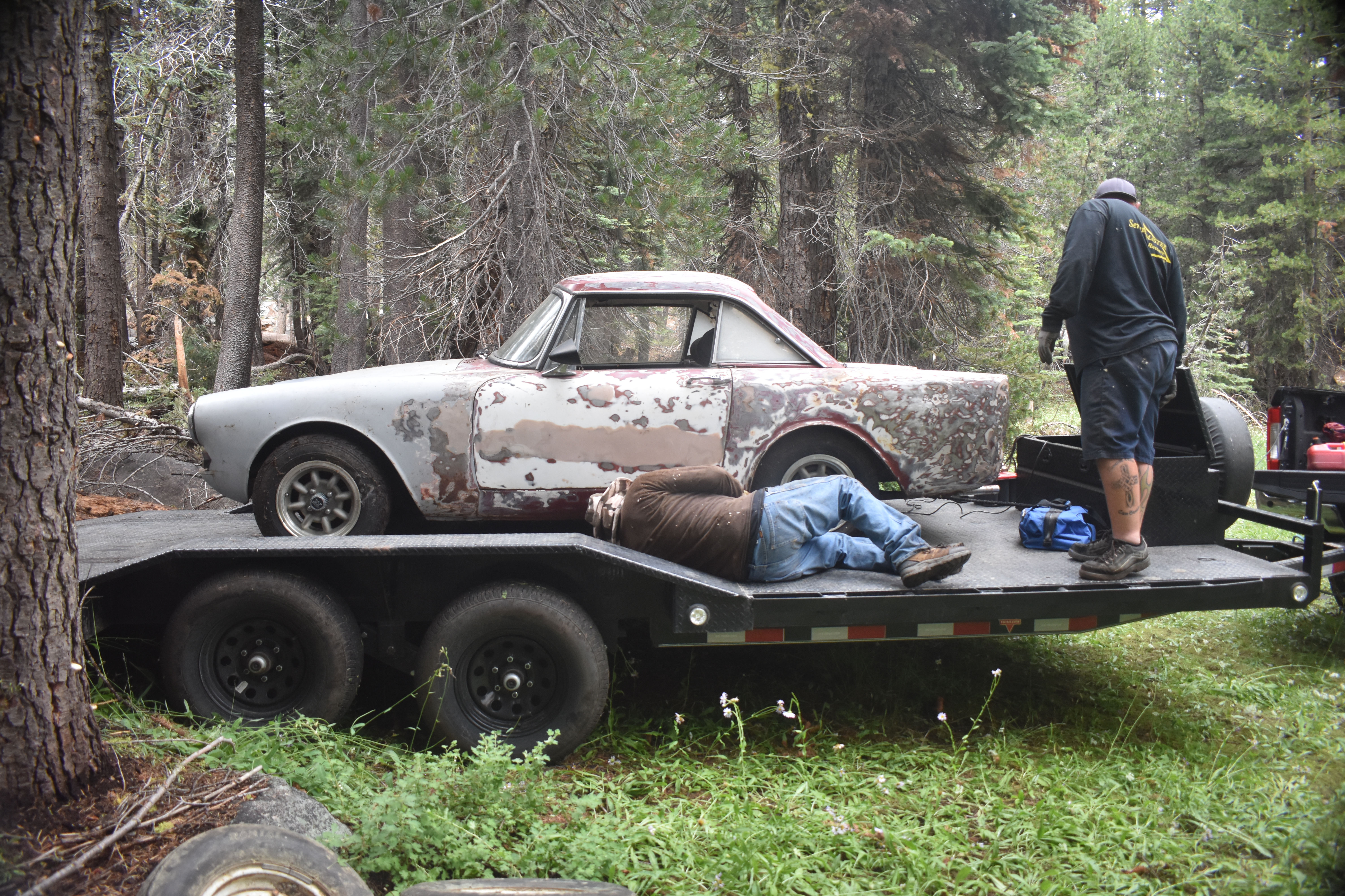

New guy, Mr. Bob here. Recently rescued my deceased brother-in-law's '66 Mk II from 30 years in the Sierra Woods. I was hoping it would be in better shape but it's quite rough. I would feel better about it if I could get the hood open & see the engine. I think the hood latch should be under the dash, over your left knee. I see nothing. Help?View attachment DSC_0026.jpeg

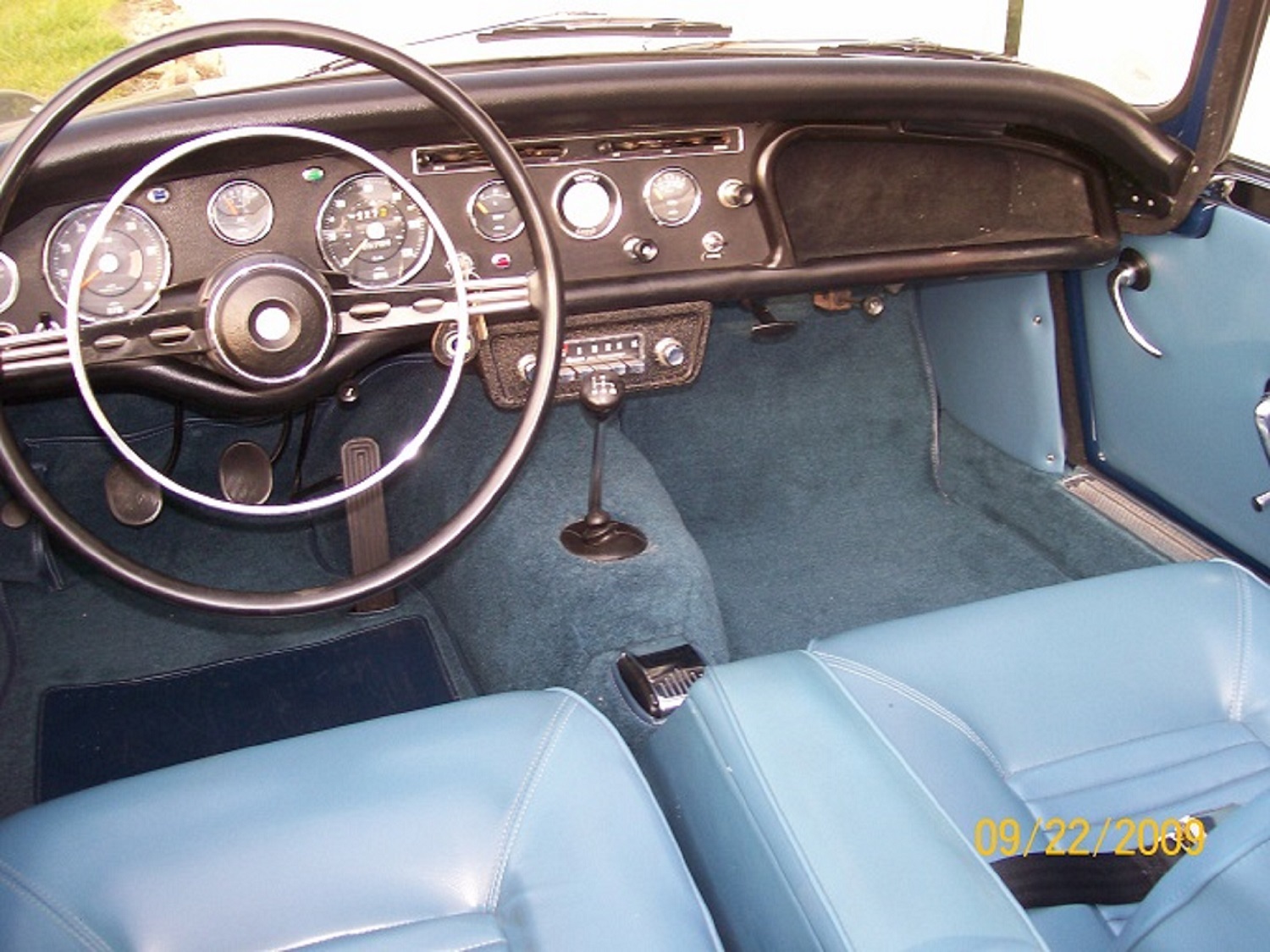

Mr. Bob,
The hood release is right of center of the dashboard and the support for it bolts to the right side dashboard brace. Look for it there.
1,841
Hood release is just to the right side of the radio in this photo. It's the same on all cars.

Thank you. Makes since these were originally right hand drive. Engine is ugly, no carb, all of the fluids except engine oil seem to have 'disappeared'.
