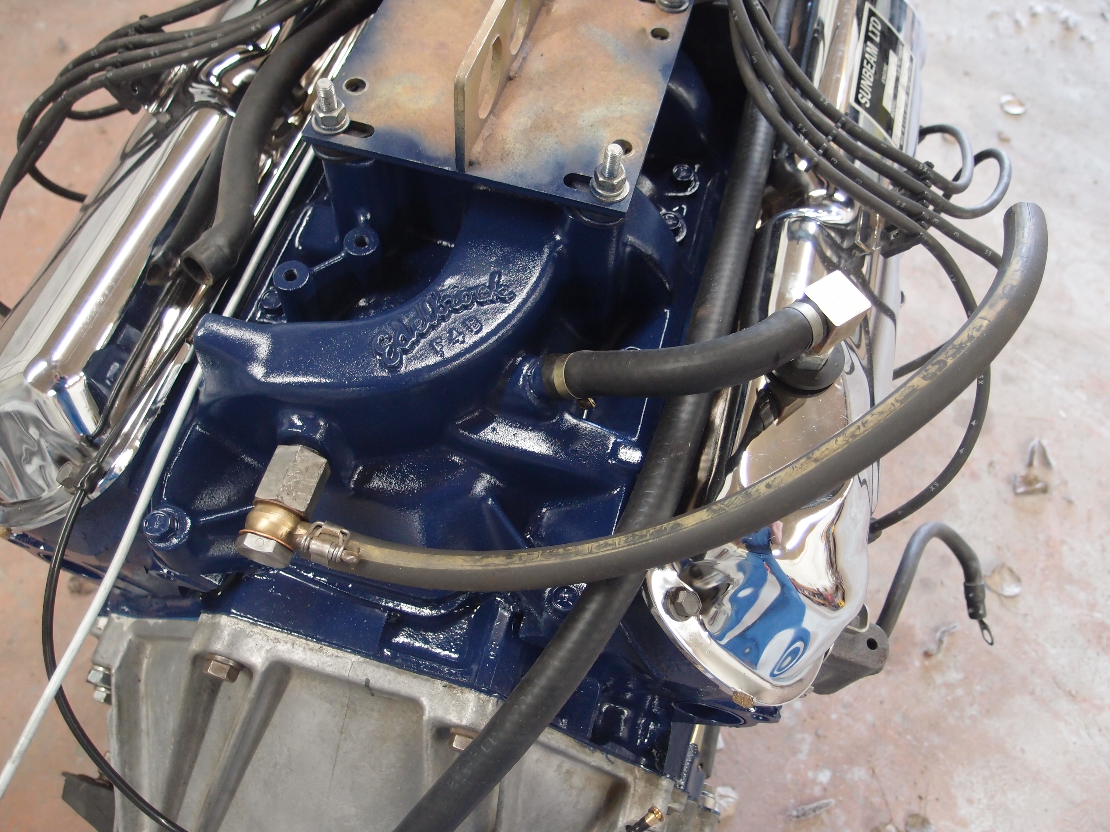

I've never worried about bleeding the oil pressure line to the gauge, and it's never been an issue. There are 2 bend clips which secure the oil pressure line to the front and rear inside valve cover bolts. I get these from NPD part #37766-SK you can just make out the rear one in the attached pic.
