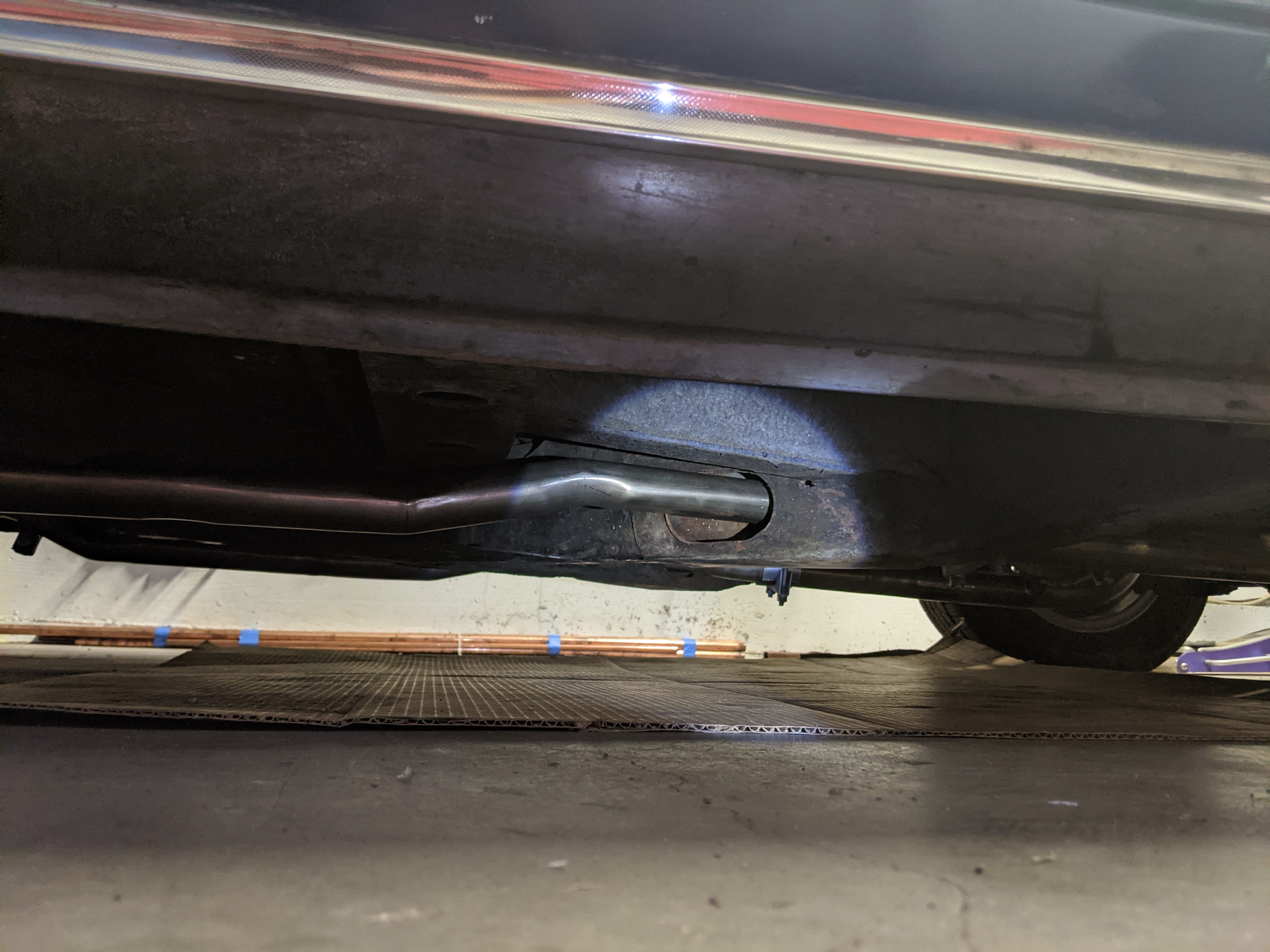

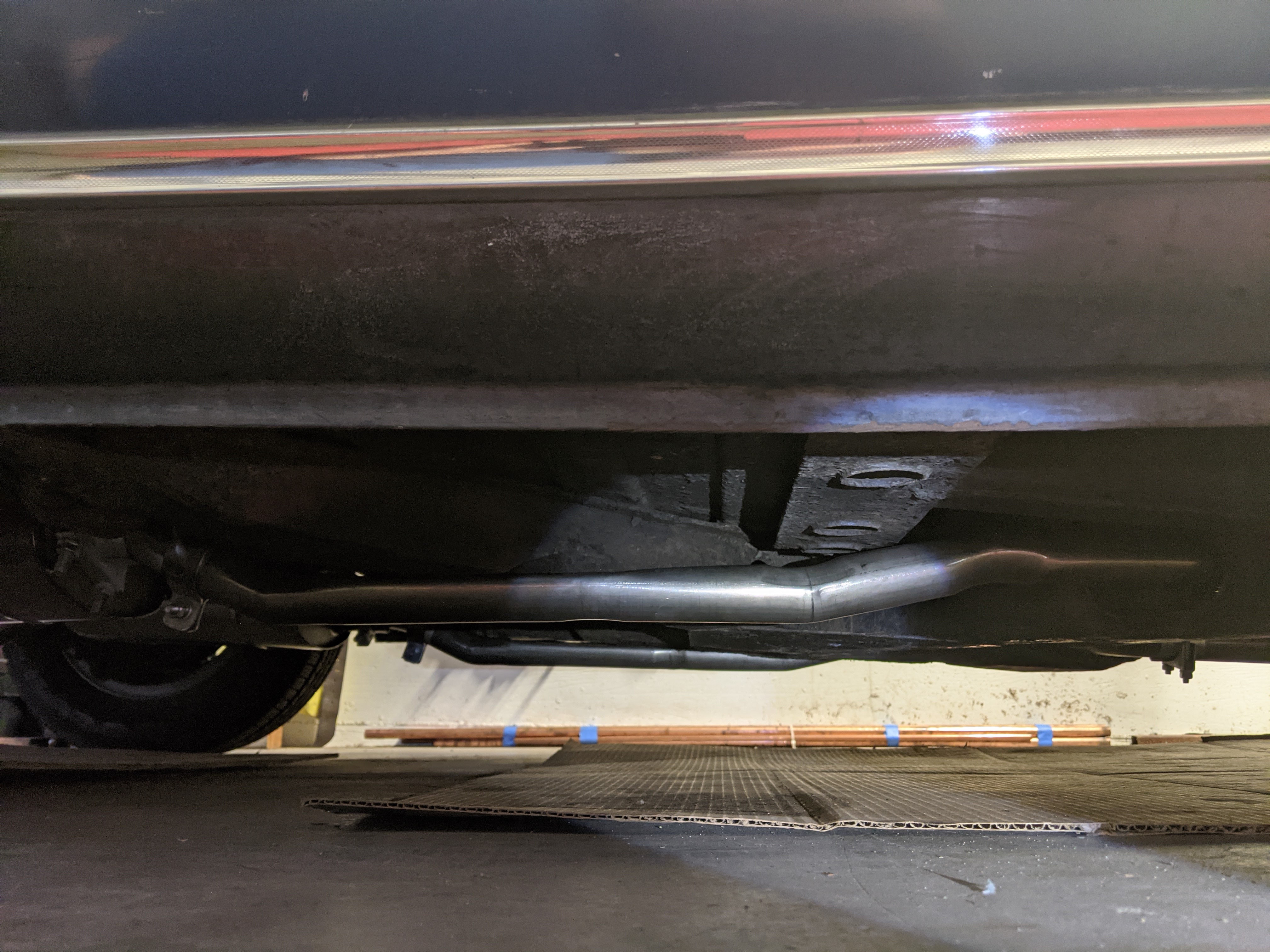

After a brief report from my buddies doing a 5 speed swap , I still believe one size should fit all. The SS stockish
exhaust is pretty darn quiet and likely would not have a blub with a crossover pipe. As installed this kit from SS took
considerable secret sauce dribbled on the top of the bolts with a recycled dogg med syringe and extension tube.
Since this looks to be the 2 time the down tubes were off and one had been replaced it was challenging. The end result is very close to not being blower than the X frame.
Oh and the neighbors like it better I'd bet.
