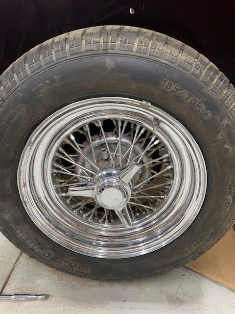

Sorry for the delay all. Here are some pics of the front hub as well as the wheel for reference. Again, any help is appreciated!

Front hubs have been redrileld.
What kind of wheels are you wanting to switch to?
4x4.5 offers a lot more wheel choice because of the JDM market and also the BMC and standard triumph cars... So not a bad thing
If you want to go back to 4*4.25... while a bit more $ . If you are going to 15" wheels would could get some stock hubs front and rear and buy the modem Willowood disc kit and upgrade brakes all round

Thanks for the info everyone. I think I will look at some wheels in this size and go from there and there are definielty more options in this size. I was thinking of something like the minilite style, or something similar, but not something I spend too much on either since I have plenty to spend just getting everything roadworthy again.

You can get the American libre wheels (petal) in 14*6 and 7 in 4.5 pcd quite easily.... minilite style are everywhere....
