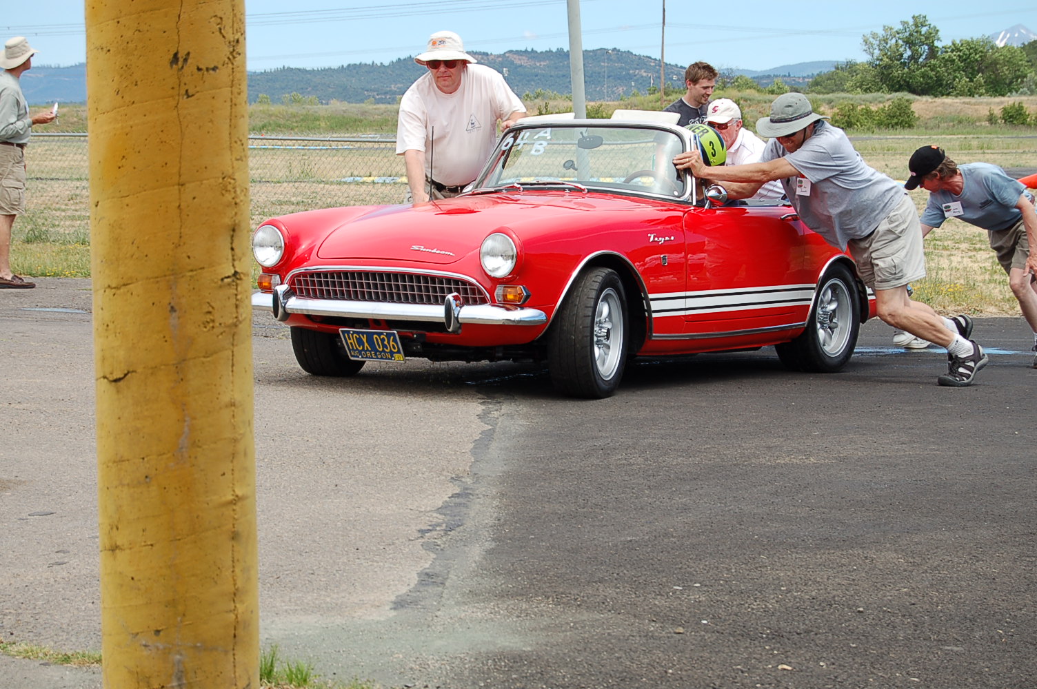

Speaking of Gary H. ... I hope he doesn't mind me posting a pic from years ago at Grants Pass.
The old 'fan blade through the rad' trick :O Ouch!
Believe it or not, car was repaired and at the concours next day!
