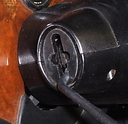

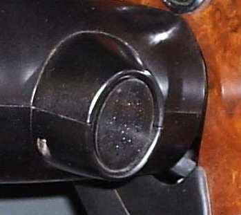

I replaced my stock broken steering wheel years ago and had to provide a new horn button toggle switch under the edge of the dash board. Lately I have relocated a push button switch in the unused opening opposite to the turn signal lever on the steering coulmn.
I'm curious, was there a small boot or plug closing the opening around the base of the lever where it enters the steering column? Or was it just left open?
I believe when the steering was moved from the right to the left side of the car the turn signal lever stayed on the right side of the column giving the passenger a peak at the inards of the steering column if there was no boot or cover.
I relocated the turn lever to the left side for ease of use being similar to my other cars. CAT has (had?) a rubber piece for the unused opening on the steering column but the one I received was too small and kept falling out so I replaced it with a piece of black acrylic. If I remember correctly the size and shape of the piece worked out nicely to be a 1-1/2" 45* ellipse. I've mounted my new horn button in the center of this piece.

I dont know anything about the CAT part, but this is the one from my 67. It is the original. I think its cool that we can put our turn signal lever on whatever side we want.
Hope this helps

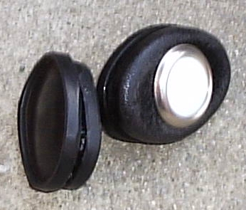

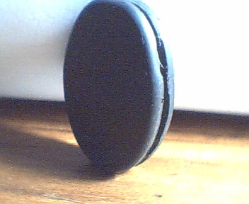

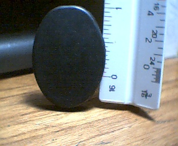

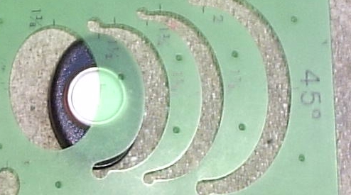

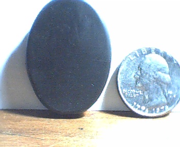

I thought the CAT steering wheel column plug looked familiar but never reached over the windshield to compare. Looks like it was a windshield washer nozzel body grommet without the hole punched thru.
Next to the CAT part is a 3 piece acrylic plug for the opening opposite the signal lever on the steering column. Still looking for a better horn button.
The opening appears to be a 1-1/2" 45* ellipse which is 1" wide.
What I was really trying to find out about is how is the signal lever opening concealed or is it just left open with the lever sticking out? When the lever is adjacent to the door the opening doesn't show. Not a big deal, just curious.

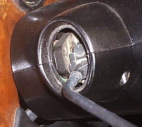

The levers are held between 2 x convex shaped metal plates that fill the hole. and the round nut srews down on the opening.
XTIGERX
501

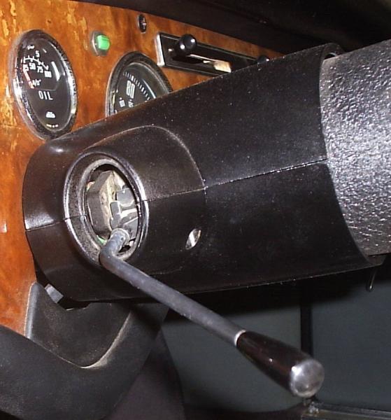

This is the turn signal lever opening that I have been asking about. I have been trying to come up with an acrylic plug but was curious as to what was there originally or what others are using. I am guessing a rubber boot was original.
Thanks, Justin

Well, my thanks guys. I think you've helped me solve my horn button problem:). It was right there in front of me.
I believe the original signal lever only moved up and down but the replacement lever, which I have, moves front to back as well and is spring loaded and wired for 2 additional momentary contacts in those directions. I can hook the horn up to one or both (and will probably be honking every time I reach for the turn lever) :eek:
Thanks again, Justin
67 Tiger
298

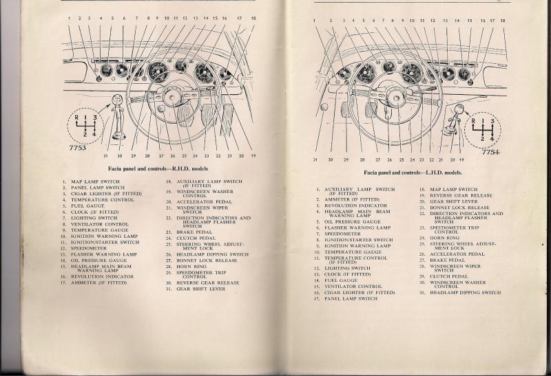

The back and forth movement is for a headlamp flasher. Ive been trying to upload the pages out of my Tiger 260 owners handbook that show the placement of the lever (right side on LHD), along with the discription, but it's not working.
