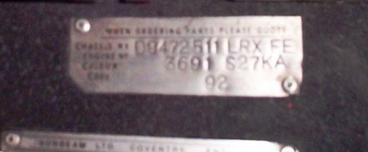

The resolution is so poor it's difficult to say, but the biggest give away is that the tag is massively distorted from surface stamping. original tags just are not distorted like that because they were pressed and not smacked with an individual stamping die.
