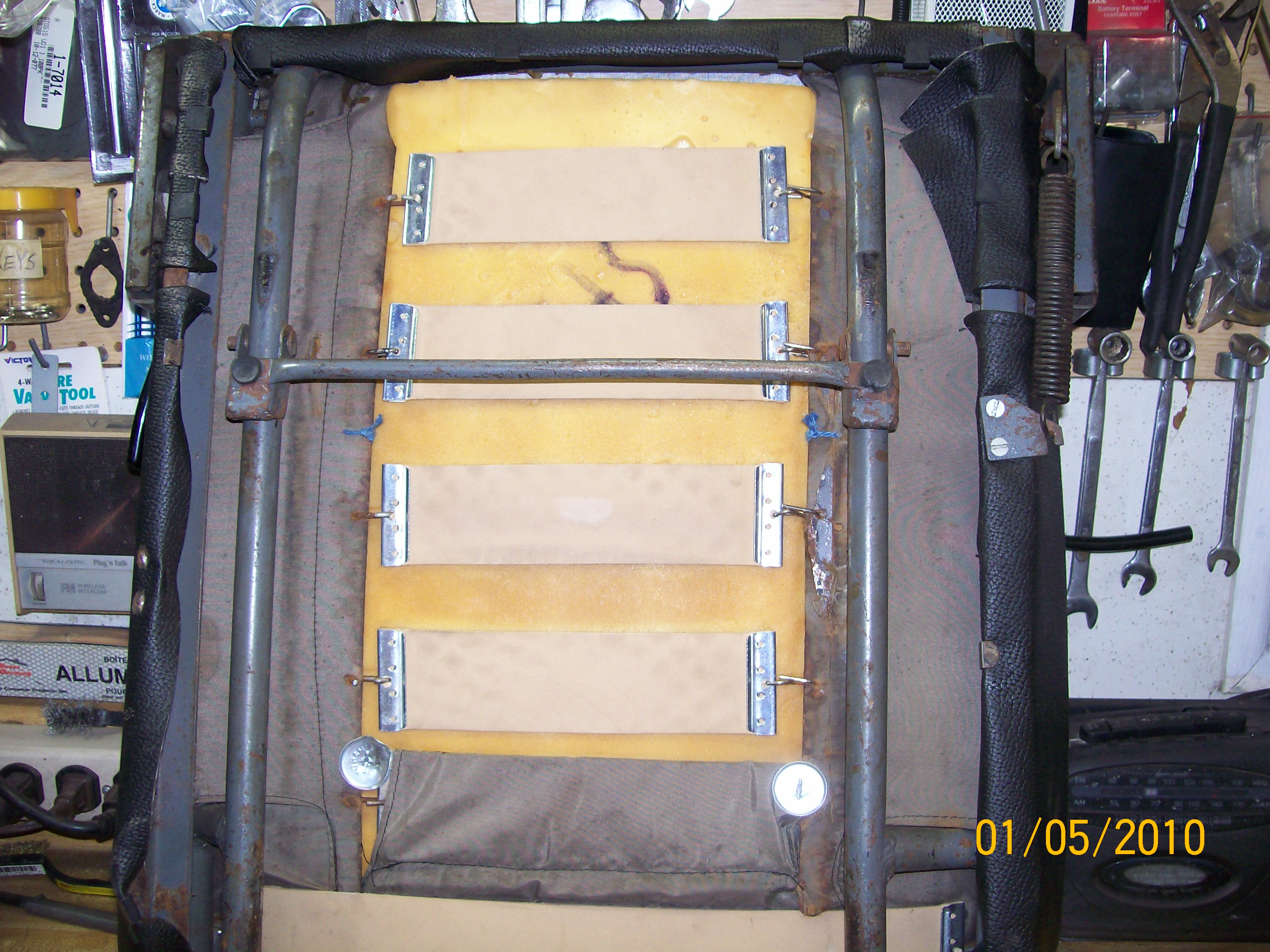

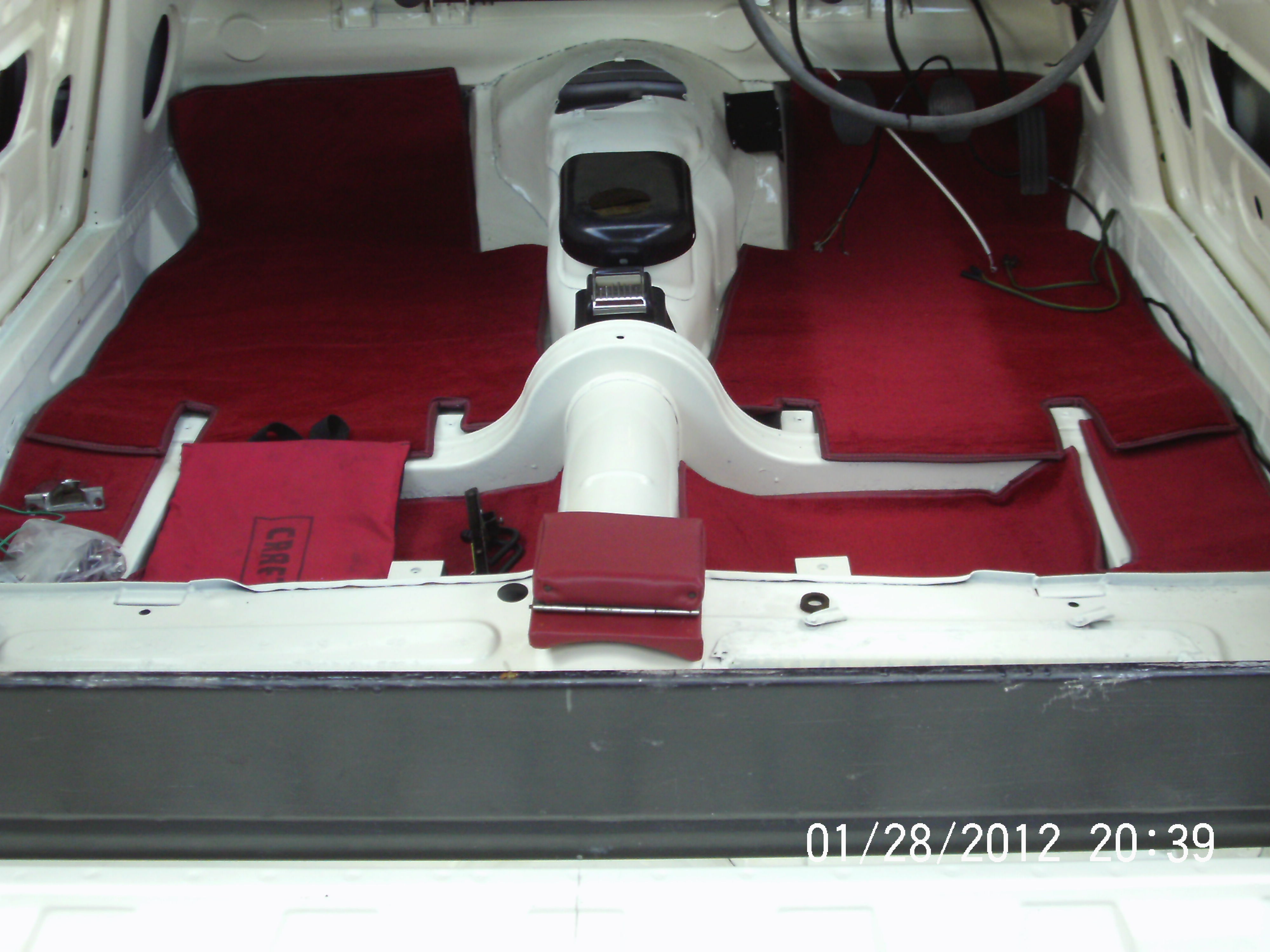

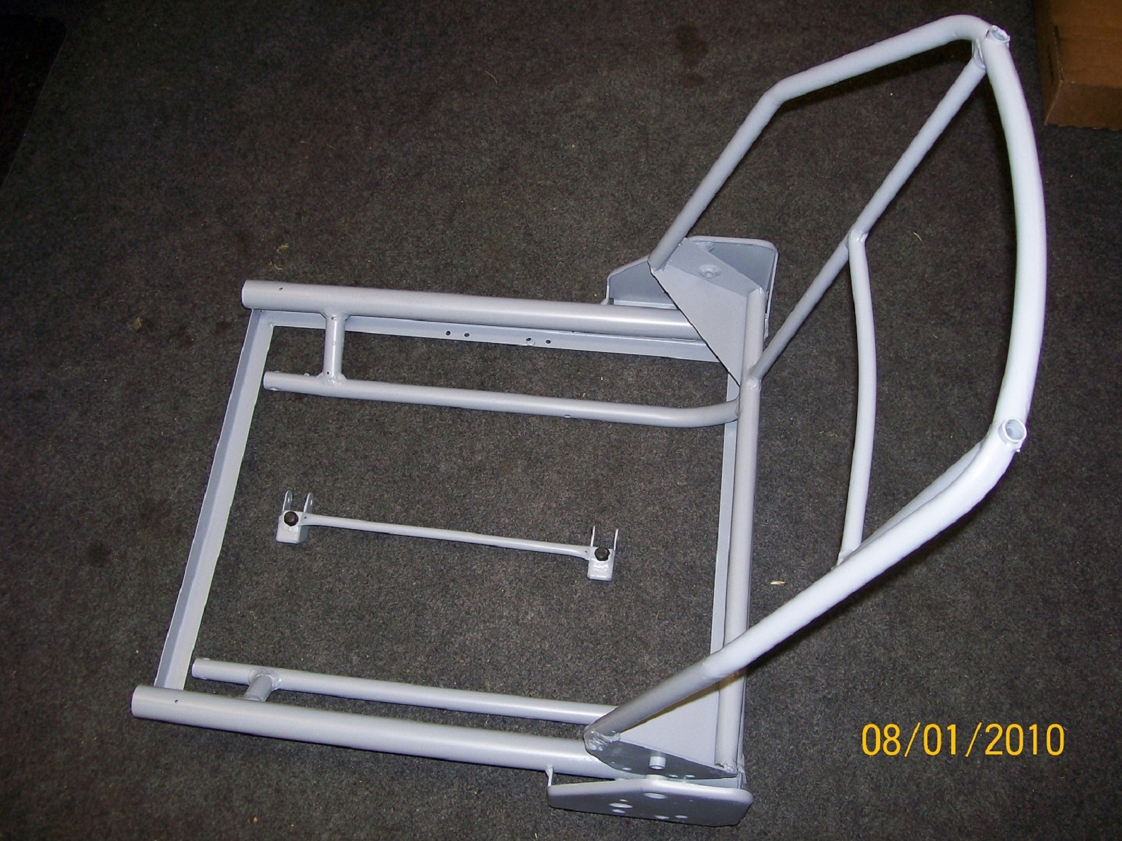

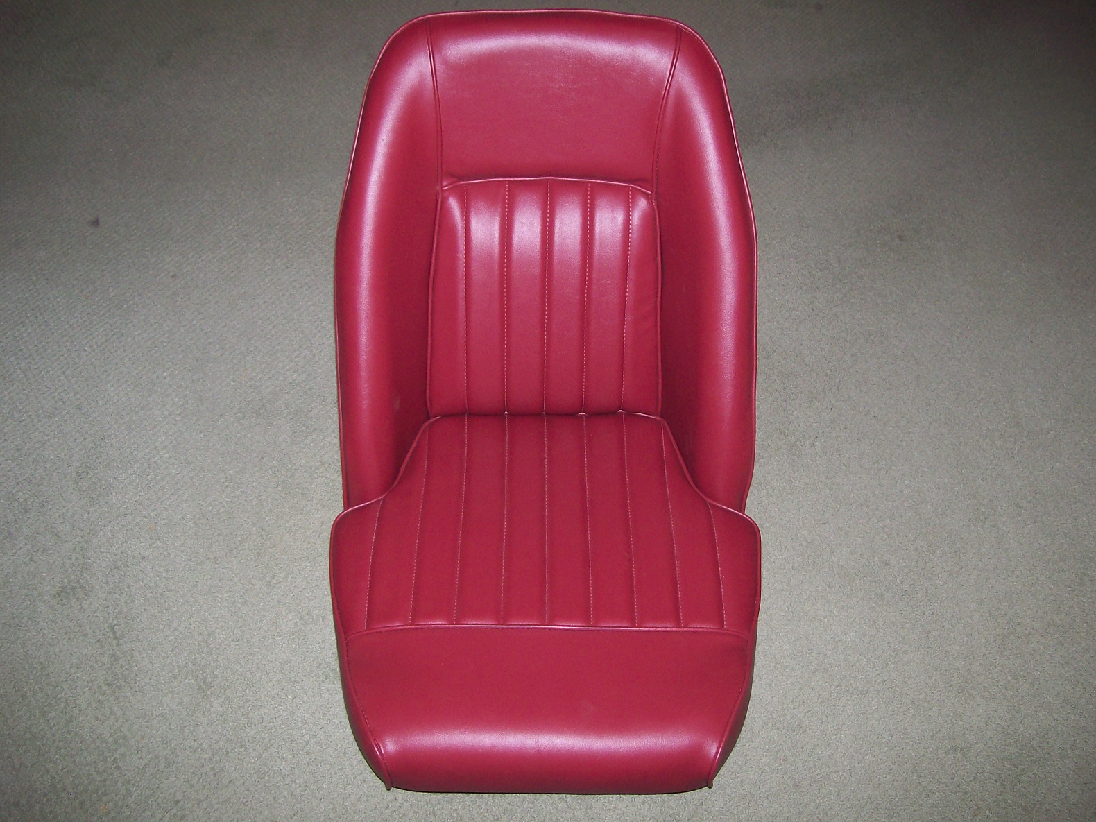

The photos of the red seats are for the LeMans. The frame is a one piece unit with the bottom cushion having flaps on three sides with snaps to fasten it to the frame. The seat frames without coverings are for a series 4 with the loose flap back. The black seats are the finished product. The fourth photo shows the straps used under the seats for a series 3 or 4. This photo was taken prior to the restoration of the frames. The series 5 used a similar two piece seat frame but had a one piece rubber diaphragm under the seat. Series 3 thru 5 had what could be called an adjustable back or tilt back in todays words.

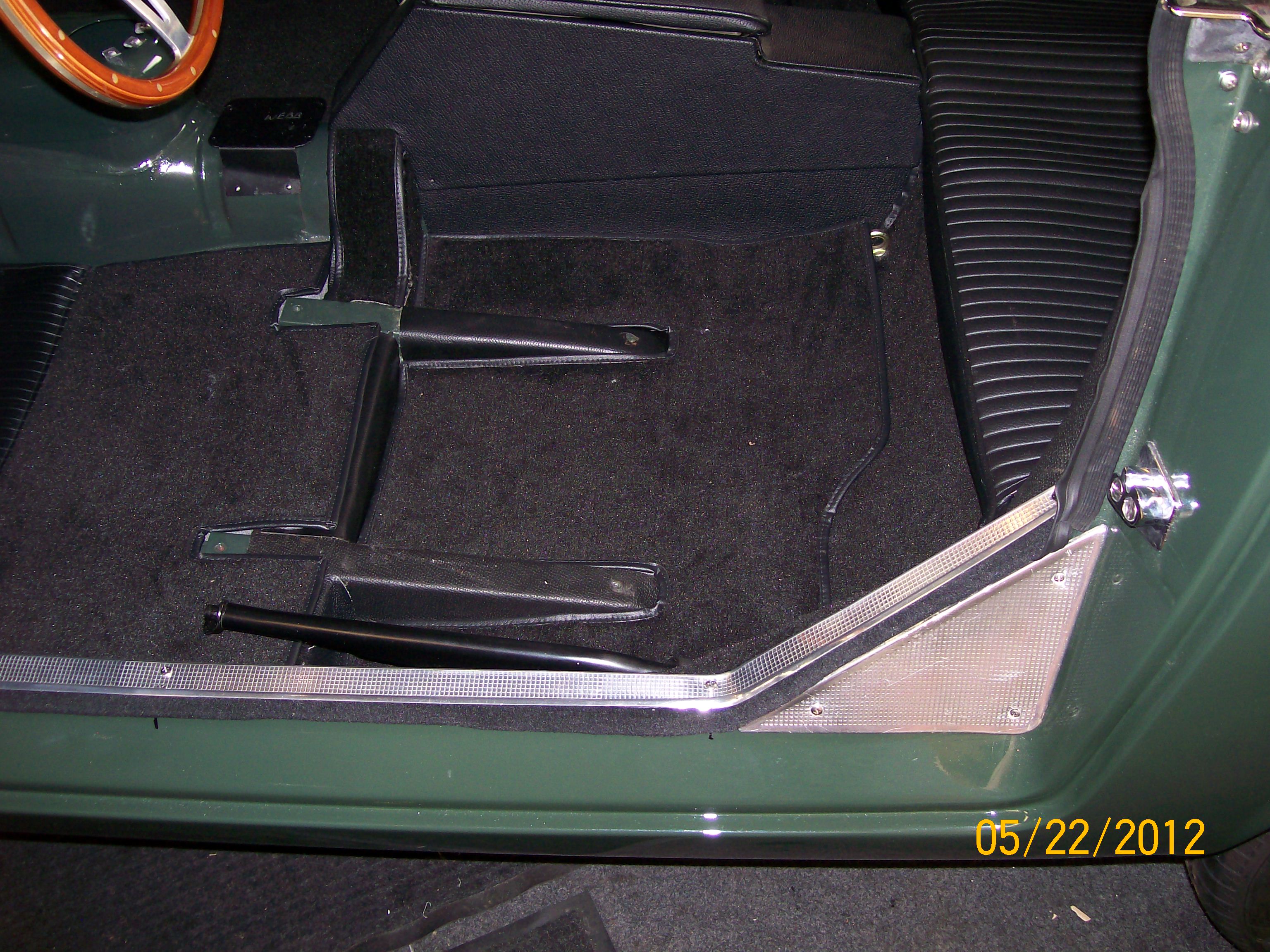

The photo of my green series 4 shows the seat mounting frame. The photo of the white car is one of my LeMans showing the seat mounts. The track bolts to the floor at the front and the back of the seat track bolts to the square bracket welded to the under seat floor. This mounting was used on all series 1 & 2 Alpines.
