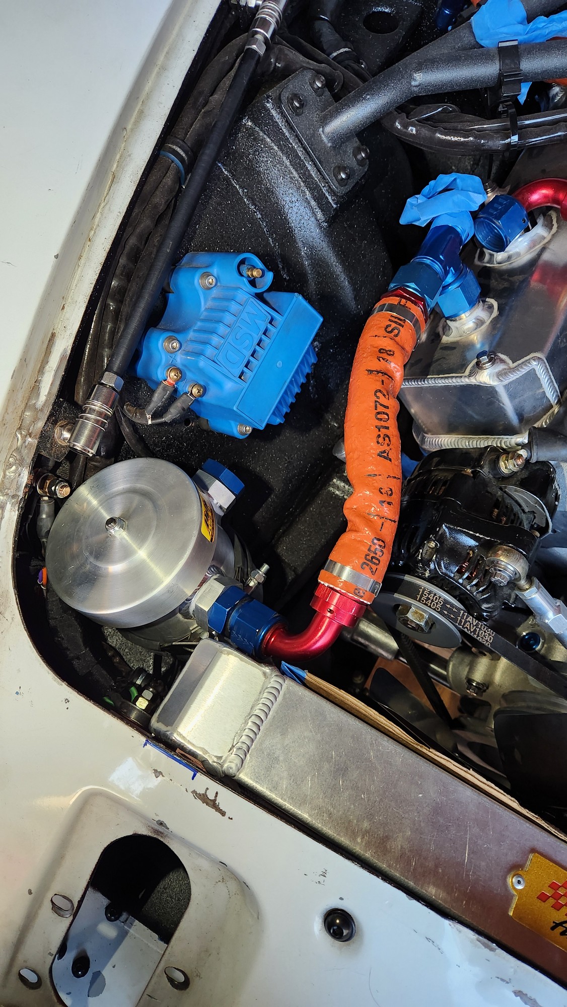

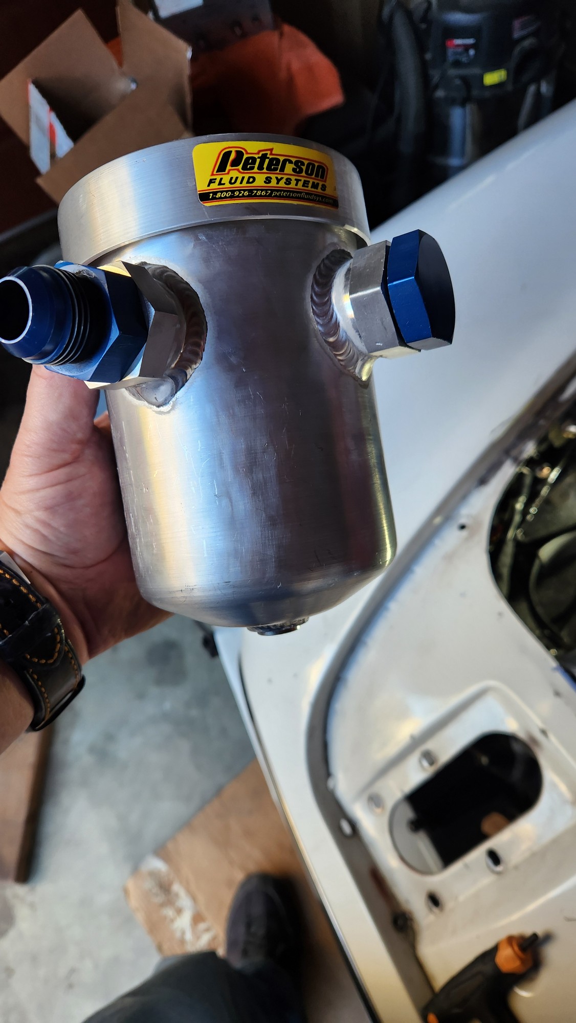

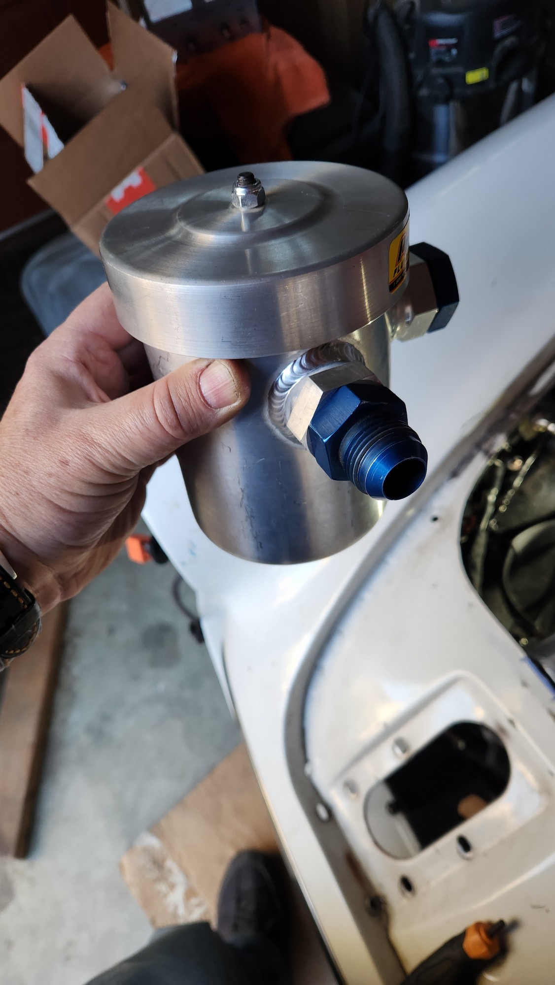

Getting a lot of the little stuff done... well really putting off trying to get the headers installed, but got the oil catch can installed. Had to sort out the main ground bolt and wires as it's behind(ish) the oil can. Trimmed the long bronze stud and got to the can.

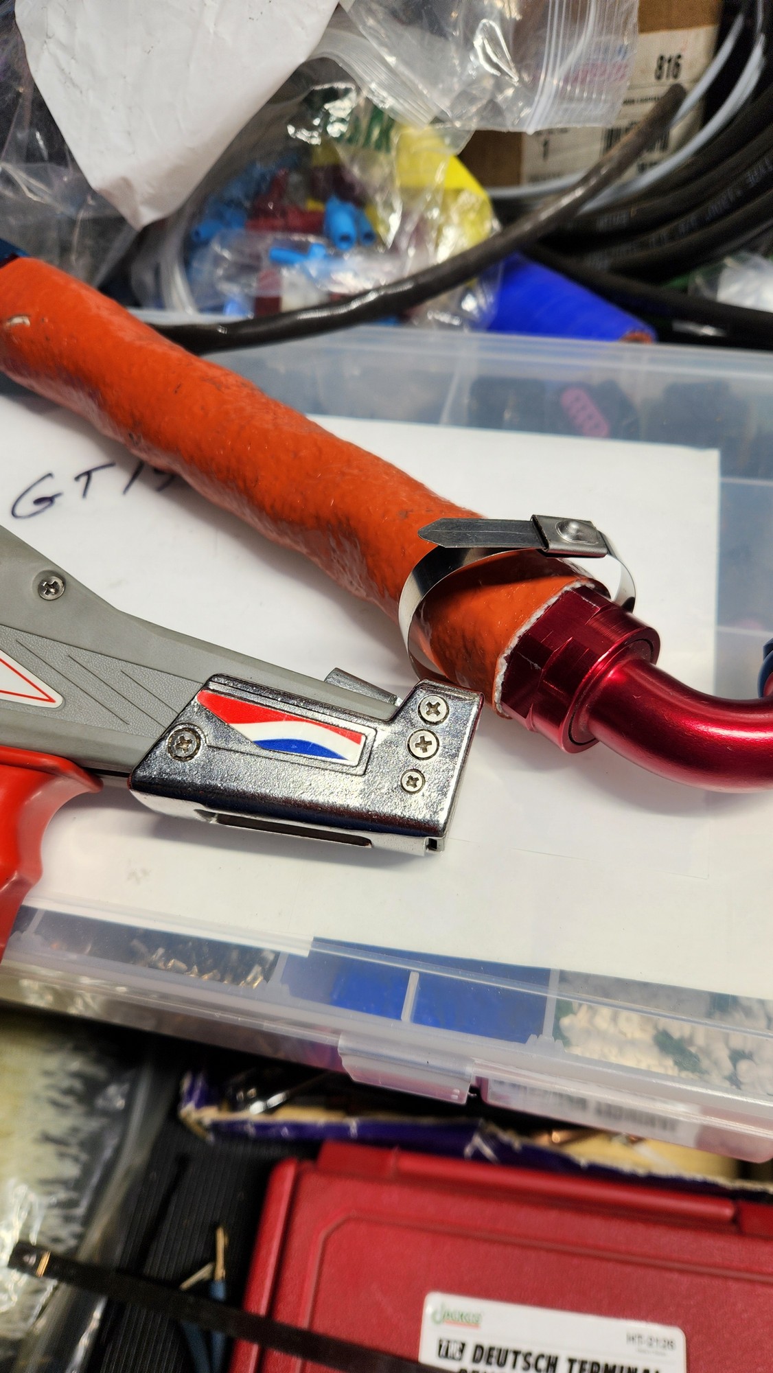

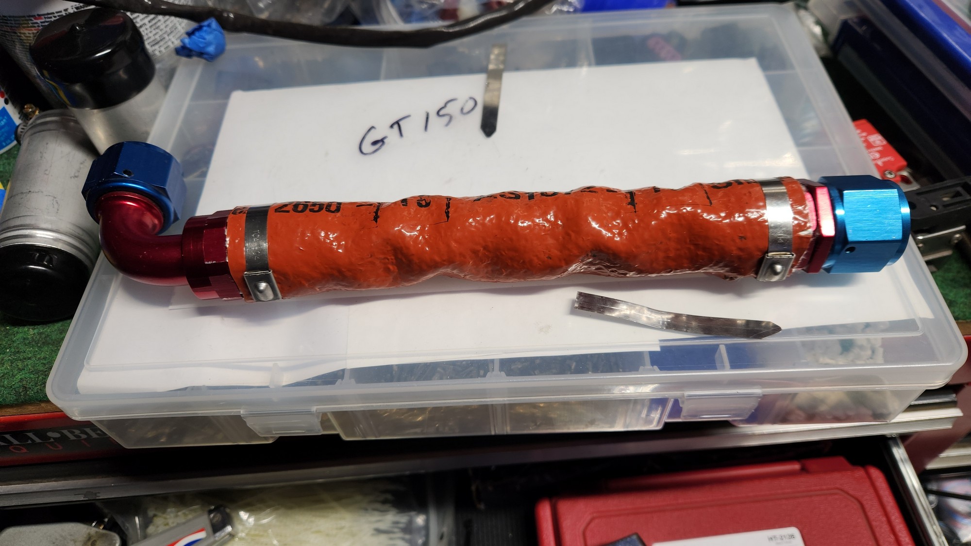

Dropped in easy, and had to make a -12 line to the passenger valve cover. -12 is easy to deal with when assembling fittings oddly. I measured, cut, added a fitting, and then covered with fire sleeve. Sorta' an easy one to wrap up the day.

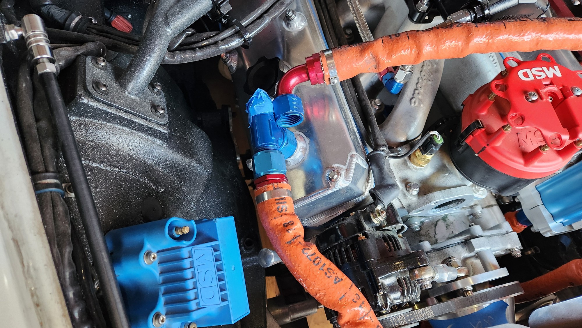

The driver side breather line is just a bit short so will have to dig up some more -12 hose to get that done.
