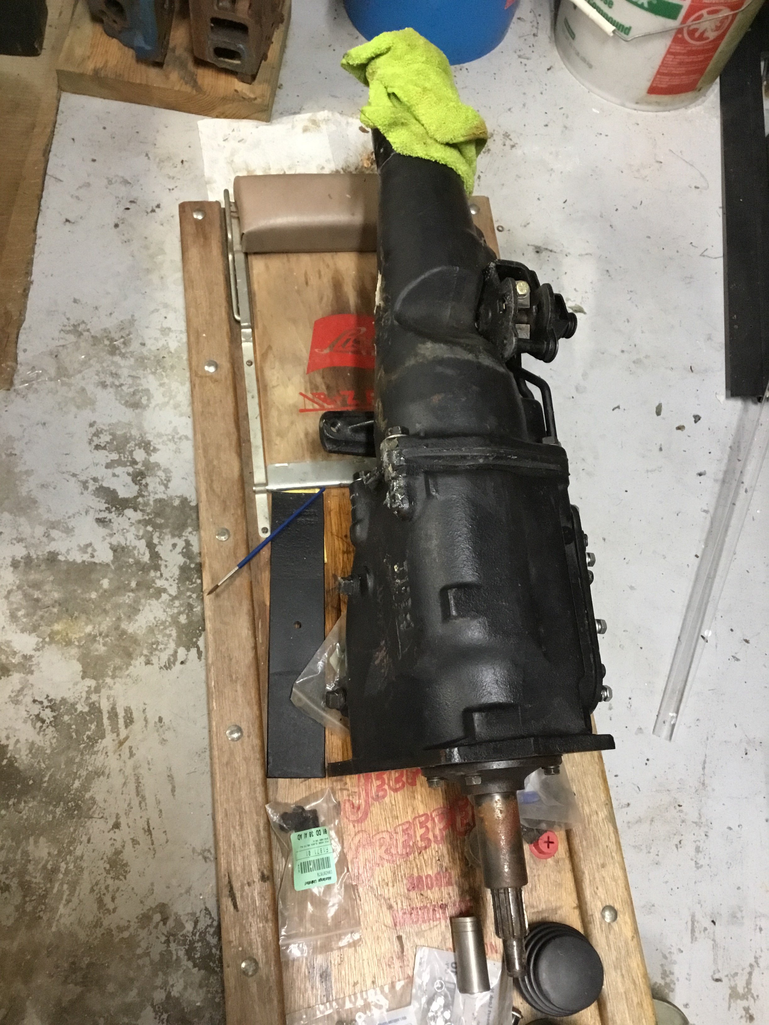

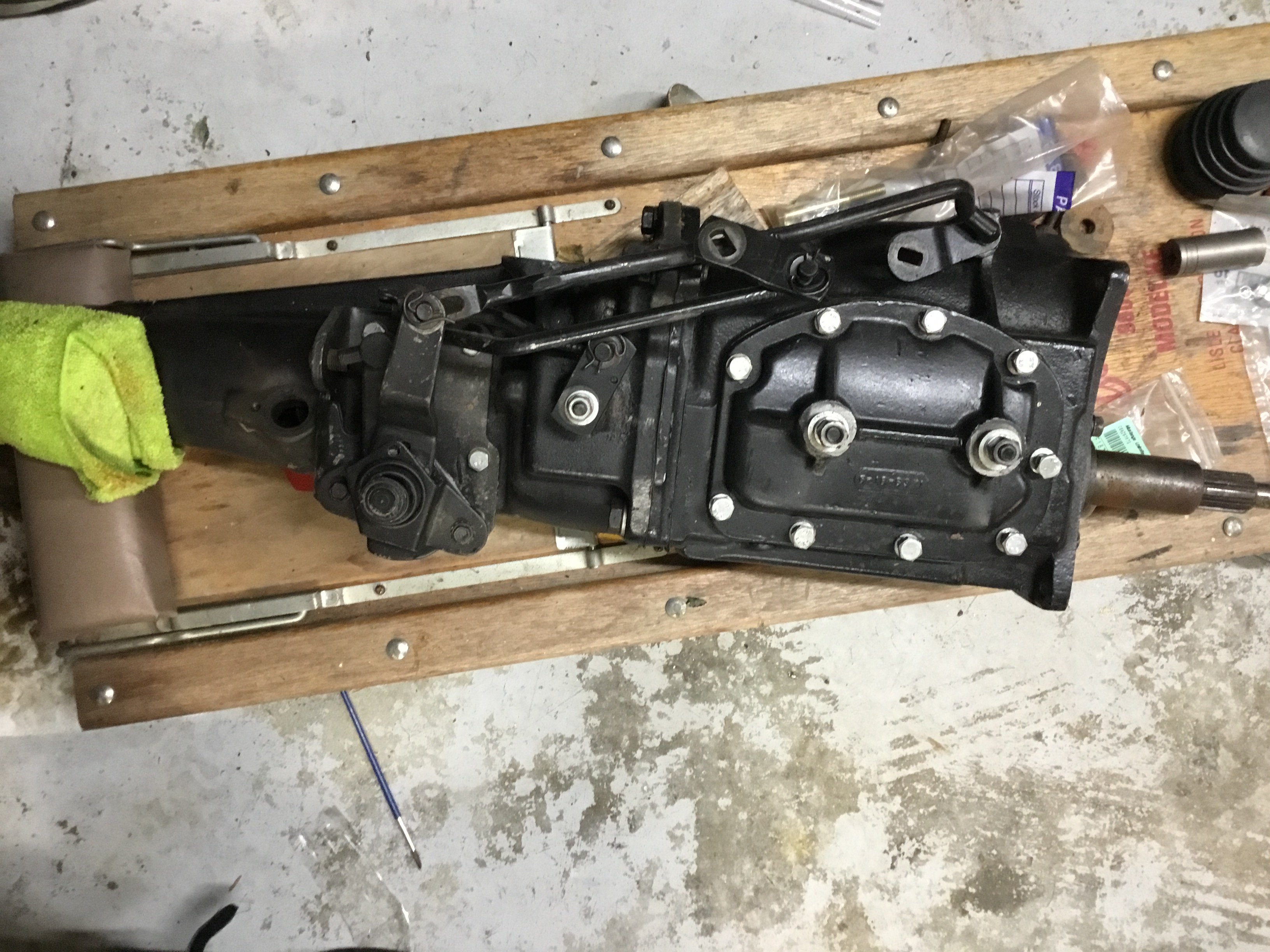

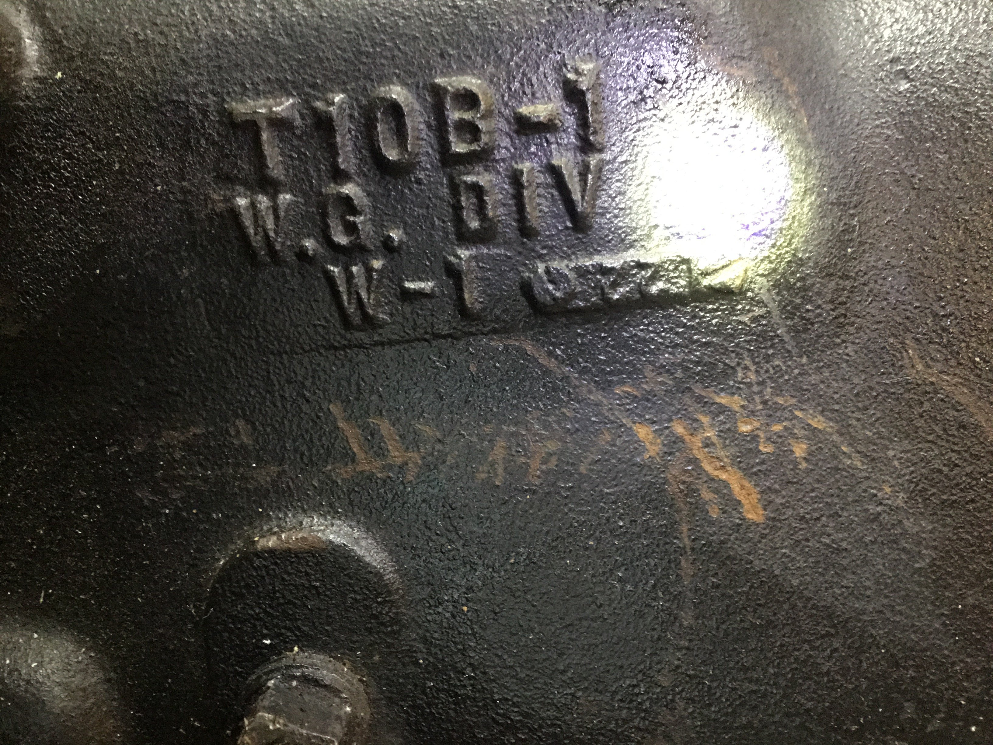

This T10 was pulled from a very early unmolested Tiger. It has the Left side speedo cable aperture and narrow case mount.

Thanks Randy!
I've only seen the later ones for the Shelby GT350 and the 6 bolt bellhousing. looking at this T10 there would be no issues using the very same bellhousing as those used with the close ratio top loader. As such, the slave cylinder bracket would not need to be changed to suit the BW box.

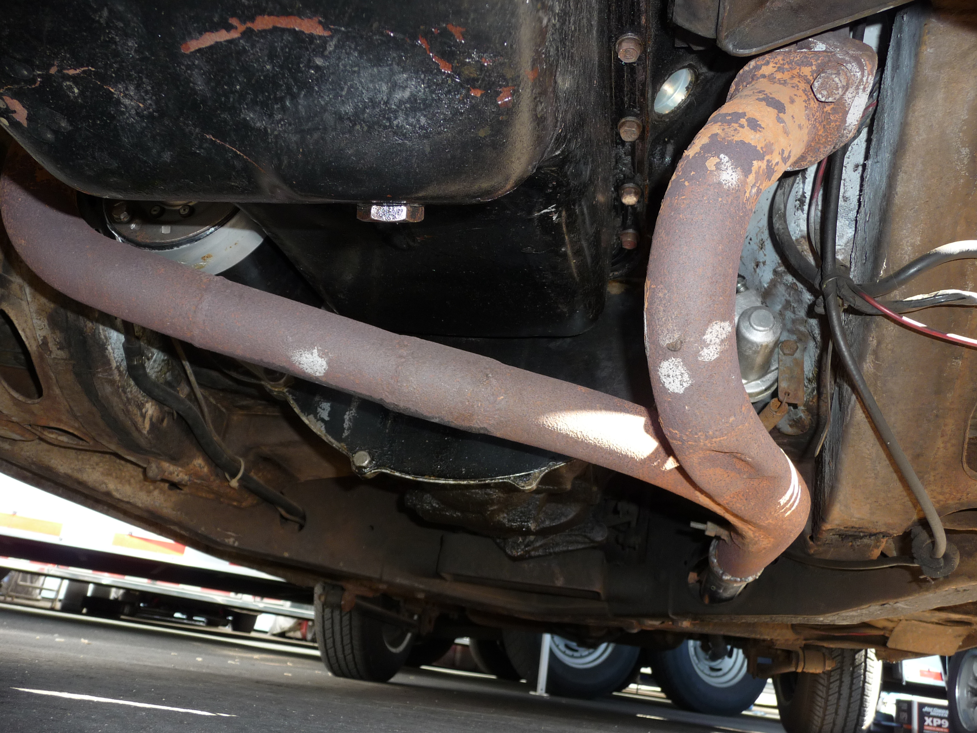

Last time I saw the Shelby Prototype Tiger I took some
underside pictures. Here is the only one showing a
part of the clutch slave cylinder.
It looks very close to a STD Tiger 260 clocking.
DW

Good picture, thanks for sharing - it shows the return spring bracket of the Cobra clutch bracket.
A picture that shows the casting's webbing would help with this determination.
Did AC have this bracket made or did Shelby American make the Cobra Bracket?
The Tiger bracket, I believe, is the Rootes version of the Cobra clutch bracket and it would be clocked similarly which is determined by the slave cylinder casting orientation.

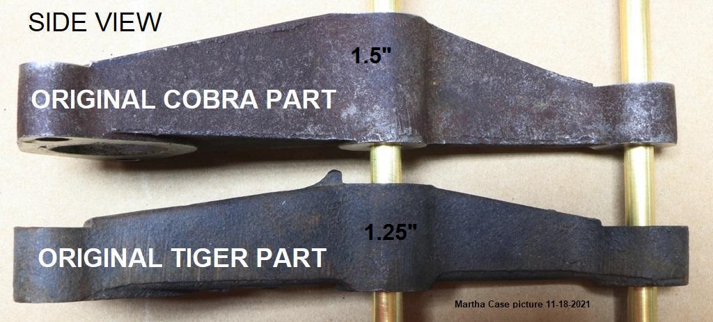

Here is a comparison photo of the Cobra and Rootes bracket - from a pdf compiled by Dan Case.
The Cobra bracket is 1.5" thick, the Rootes bracket is 1.25" thick.
I'm still looking for photo proof of the clutch bracket on the early Tigers. Engine groups T15KL and E7KL.
