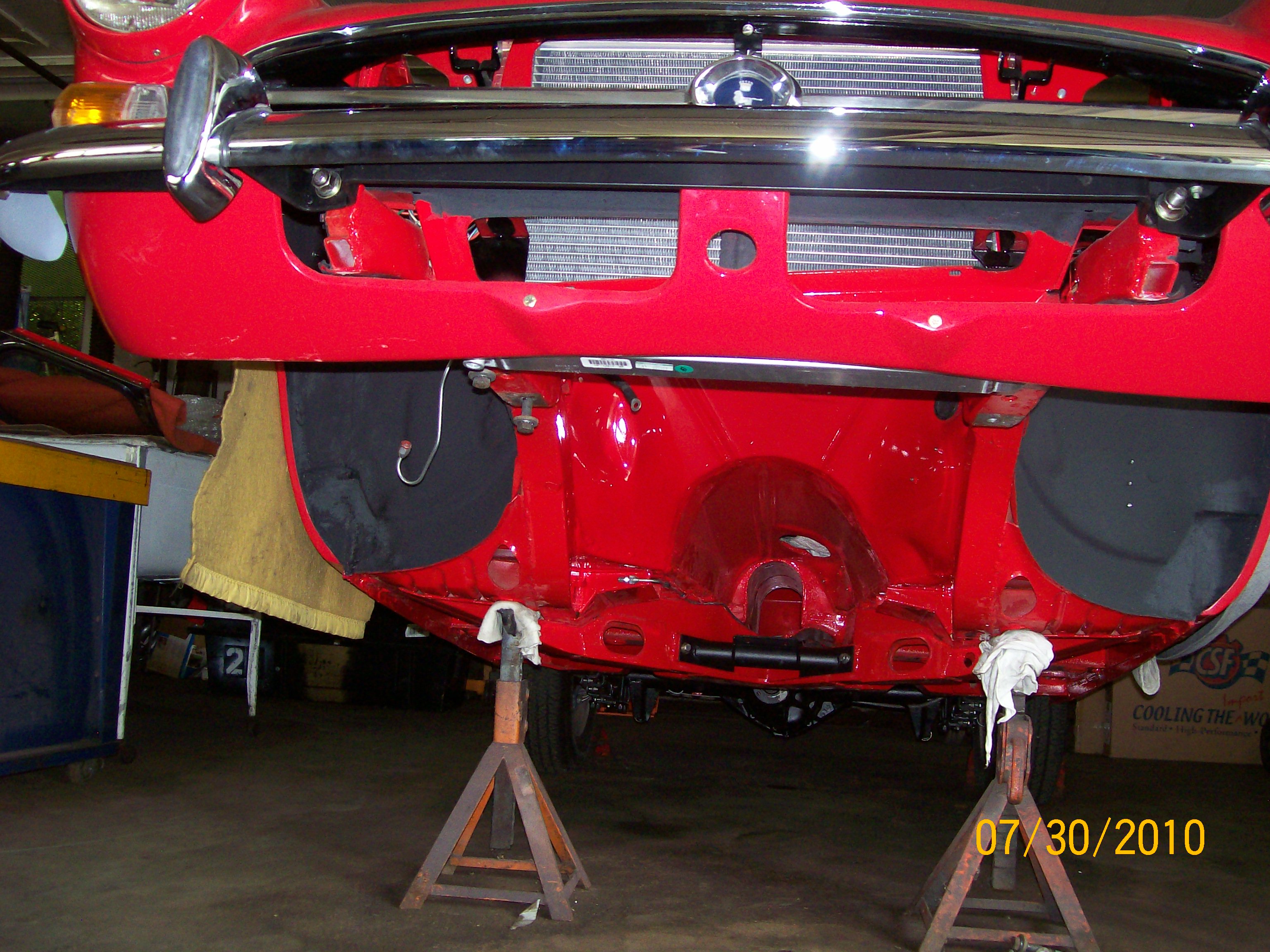

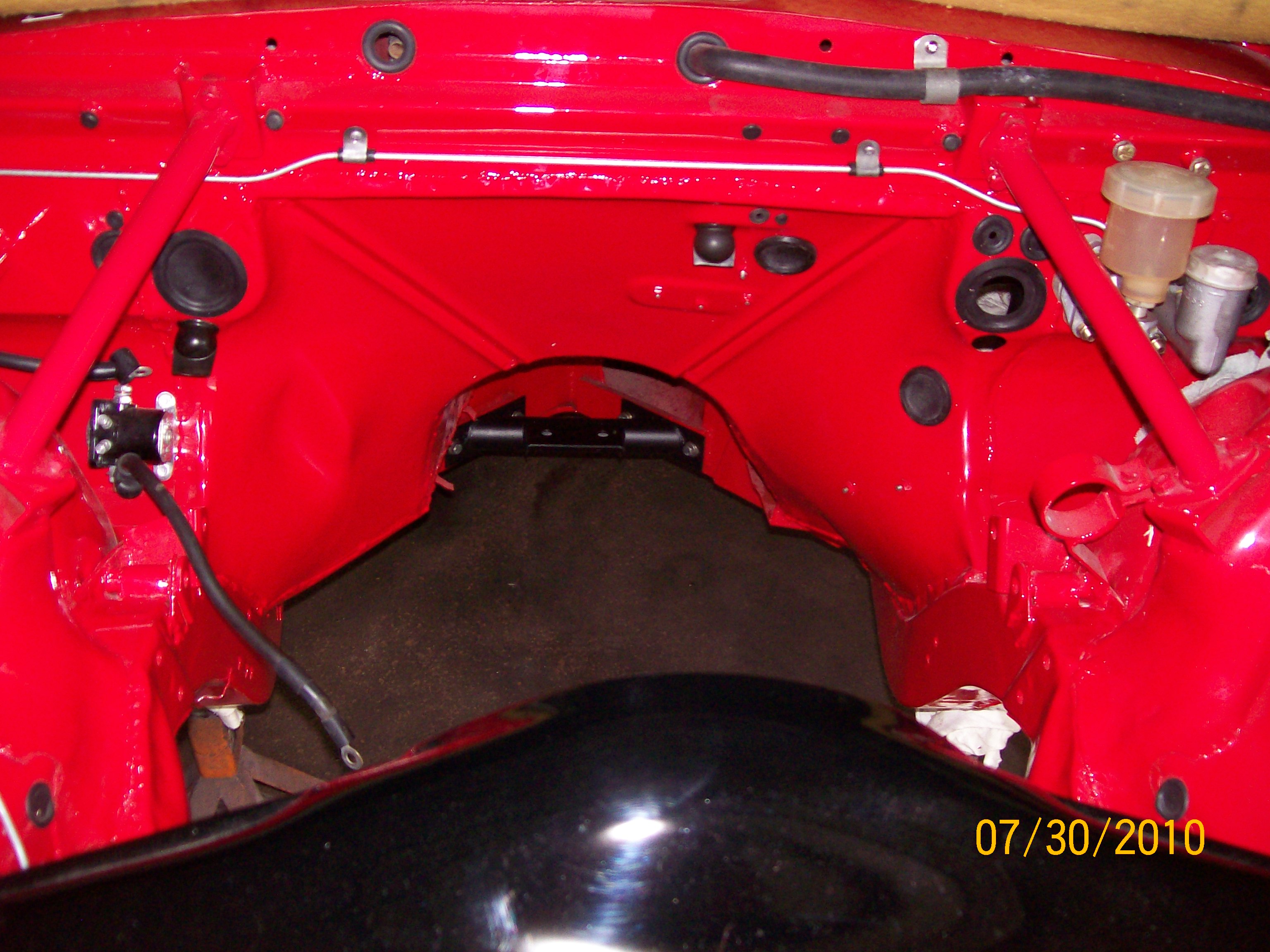

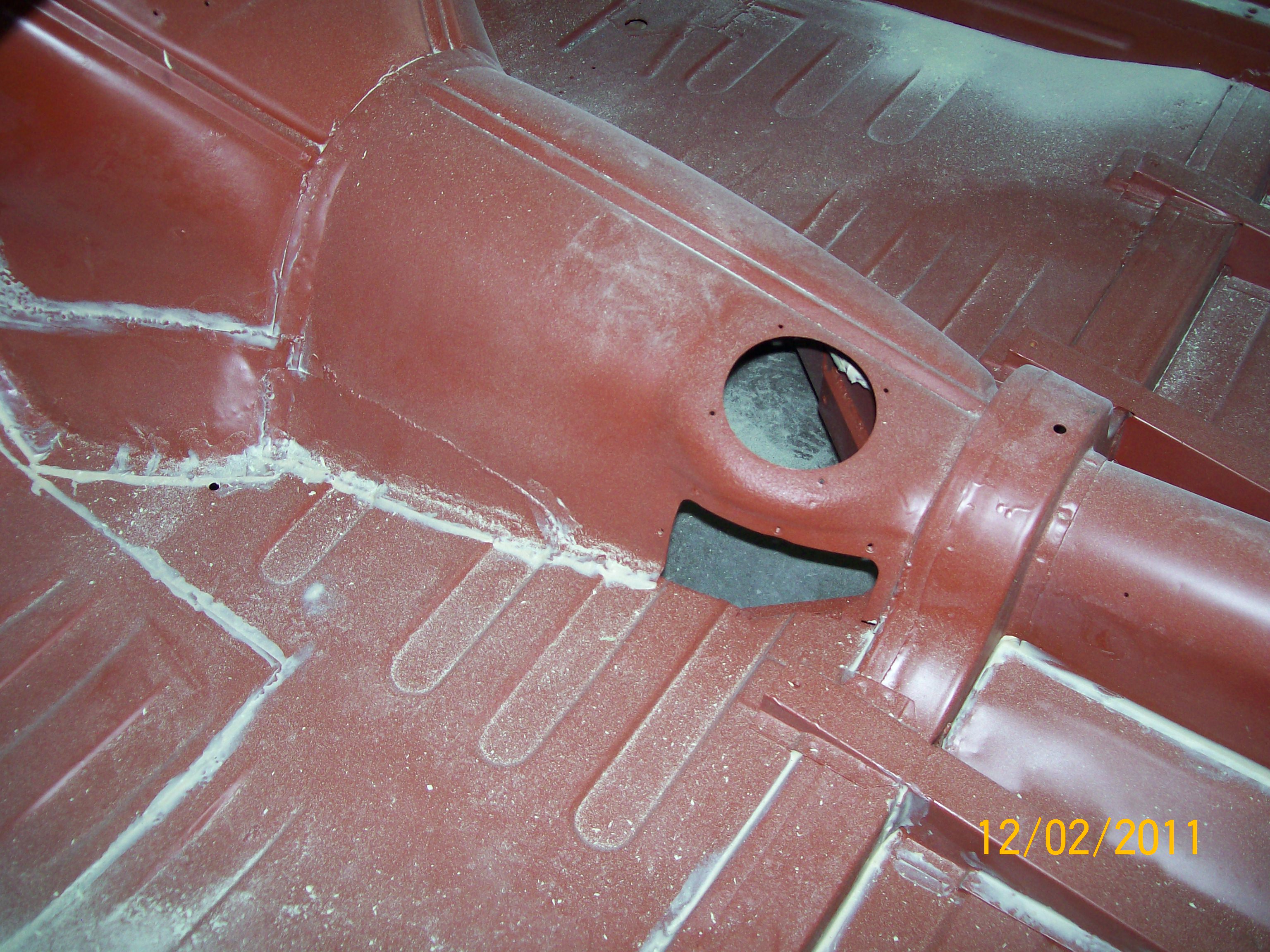

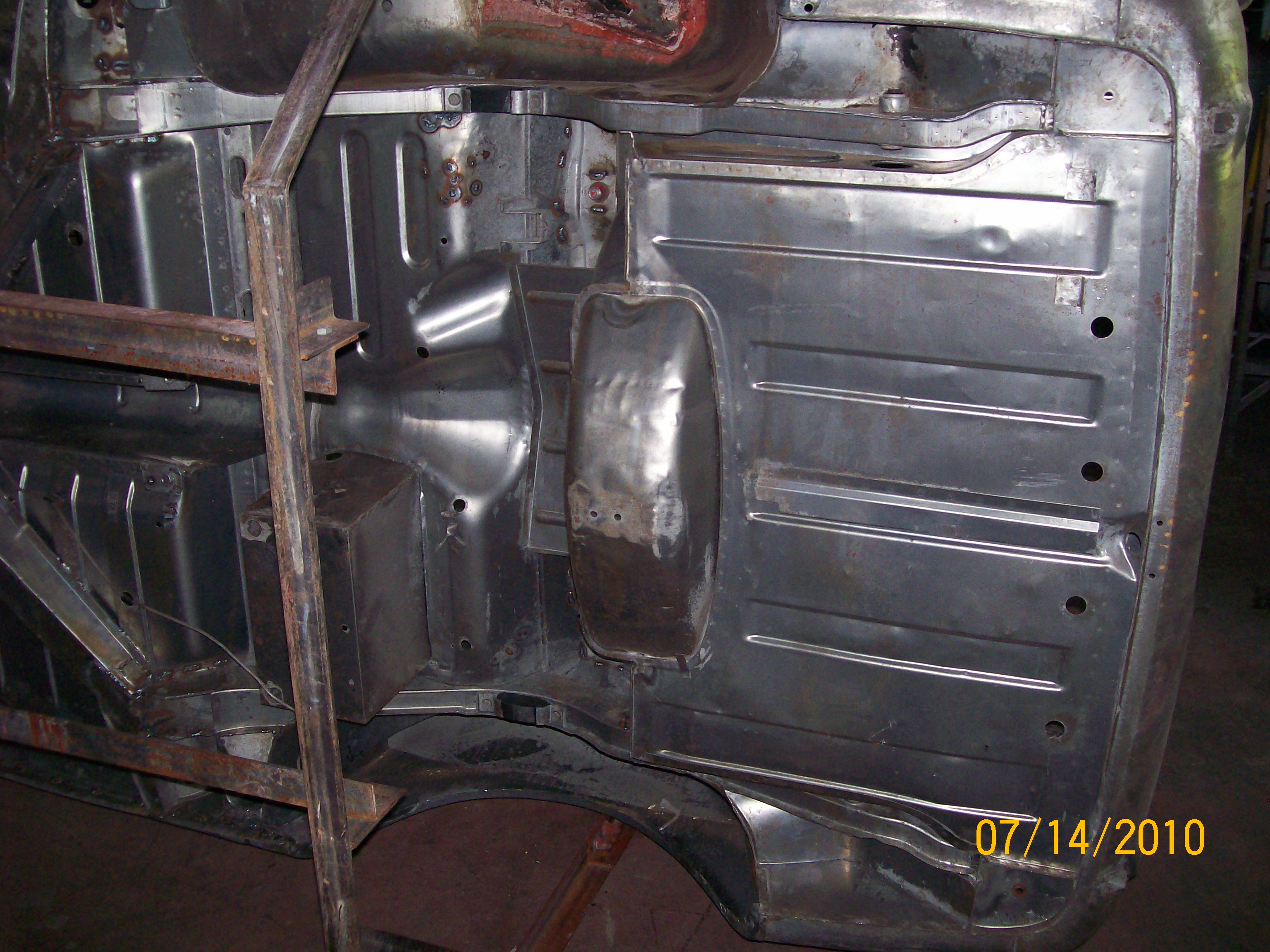

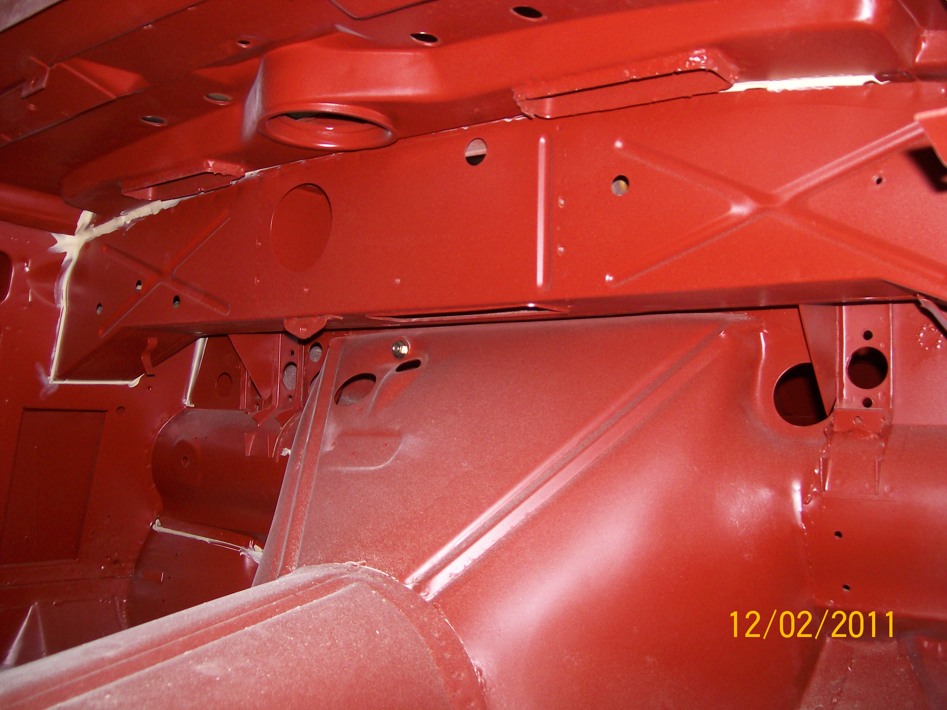

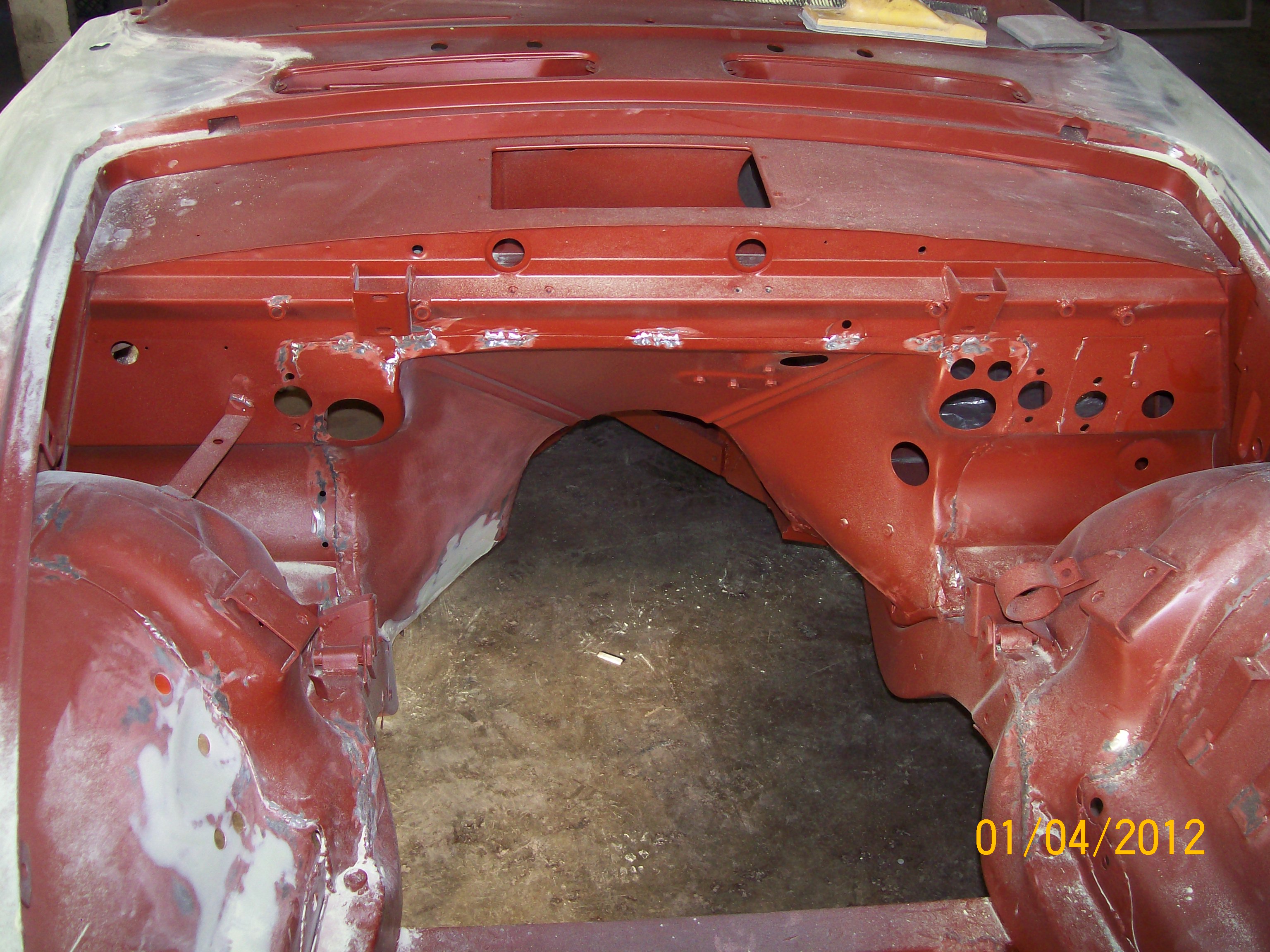

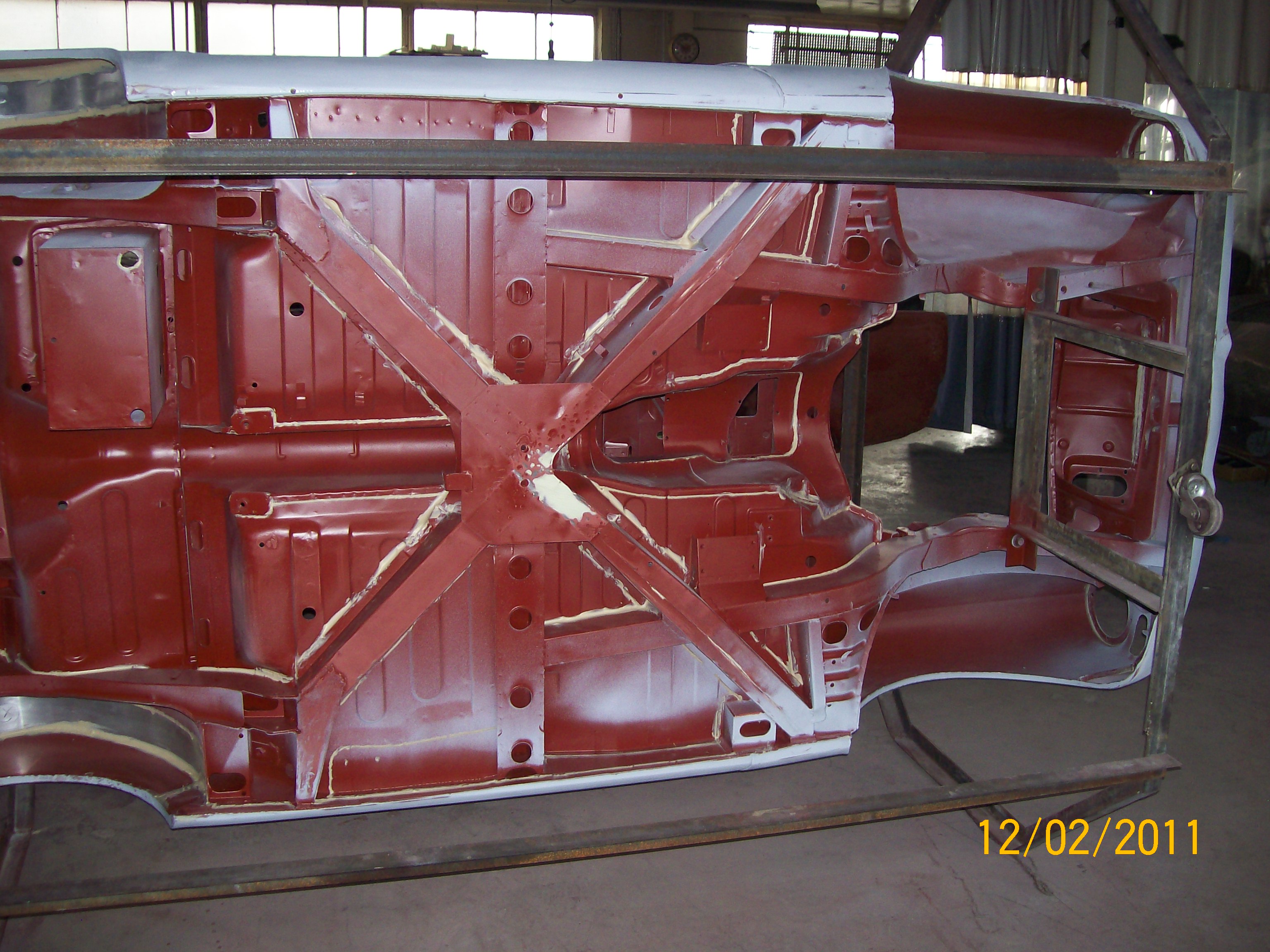

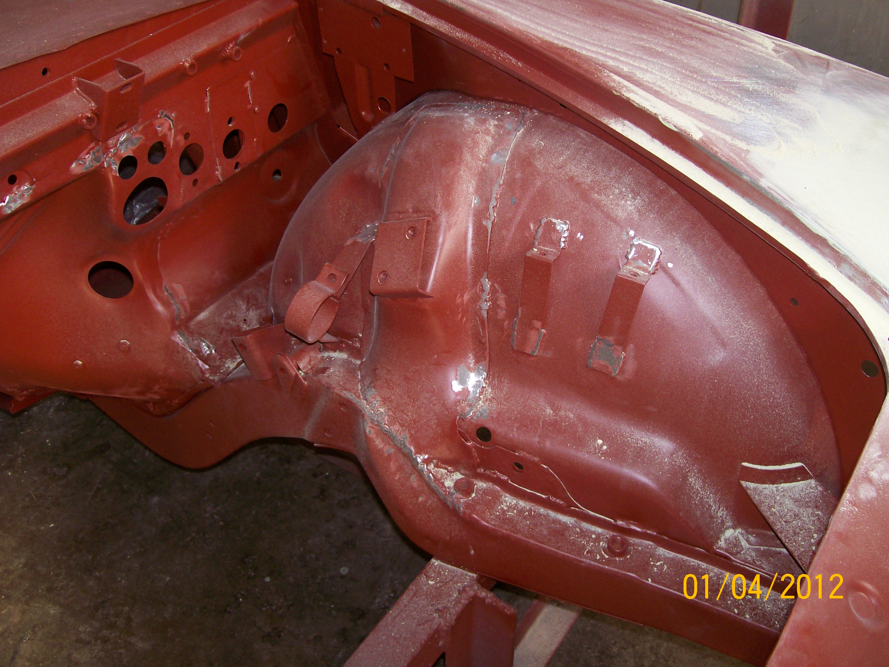

photos
1,928
NOPE! You're seeing two different cars. My series 4 Alpine with no primer and an original Tiger. Both at the same shop. These photos show the series 4 at a later date and the Tiger engine compartment after paint and the start of assembly.

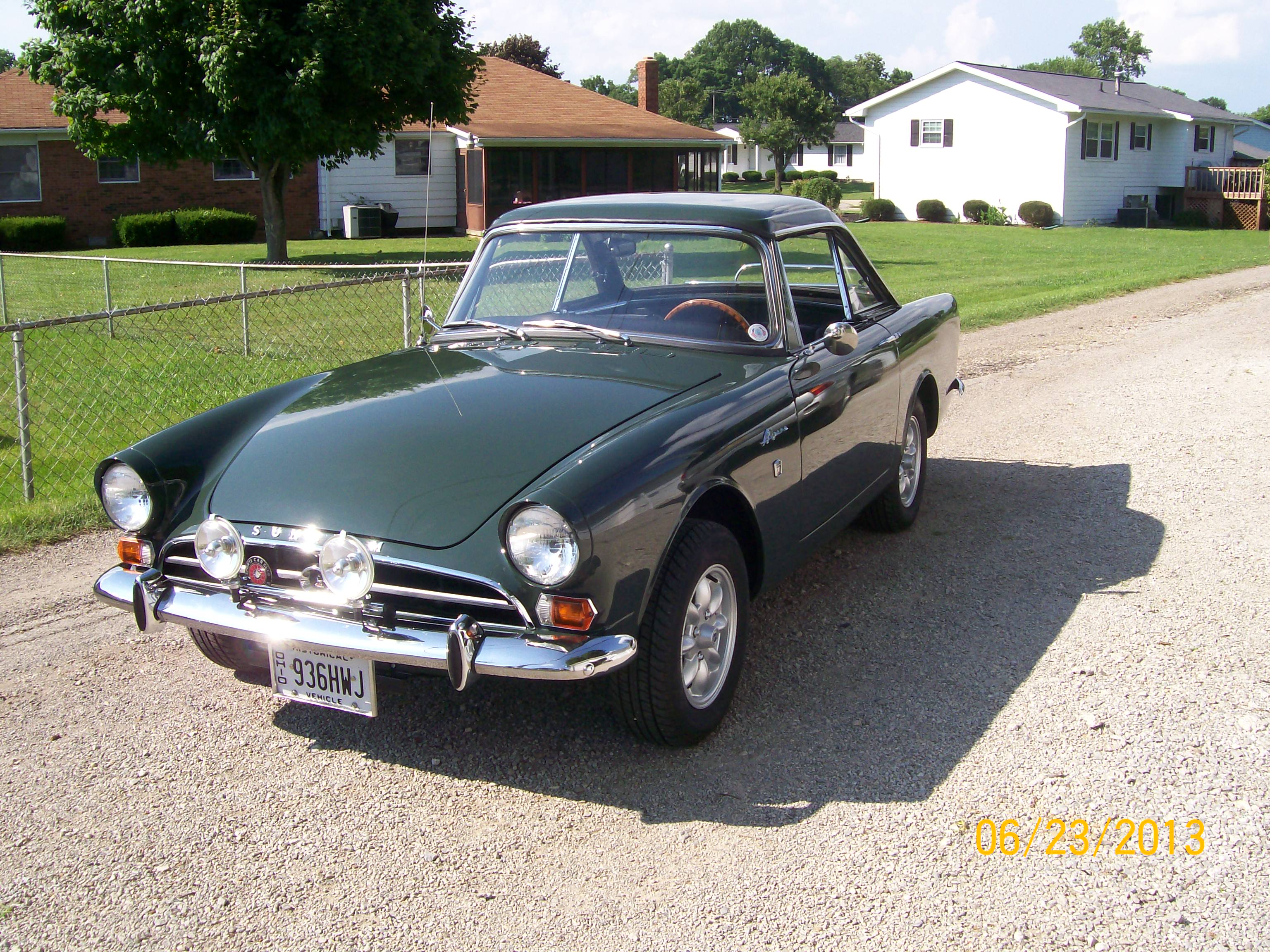

1,532
4,271
This last picture shows an Alpine shell with a Tiger trans tunnel and bulkhead... forgot to flame cut something, Bob!
Not Roberts car, he isn't really a Tiger guy ... But also can't attribute that work to Robert either...he has Doug do all his bodywork... so assume this is his work.
1,532
in any event, I stand by what I said. The lower heater mounting tab is modified on a genuine Tiger shell.
