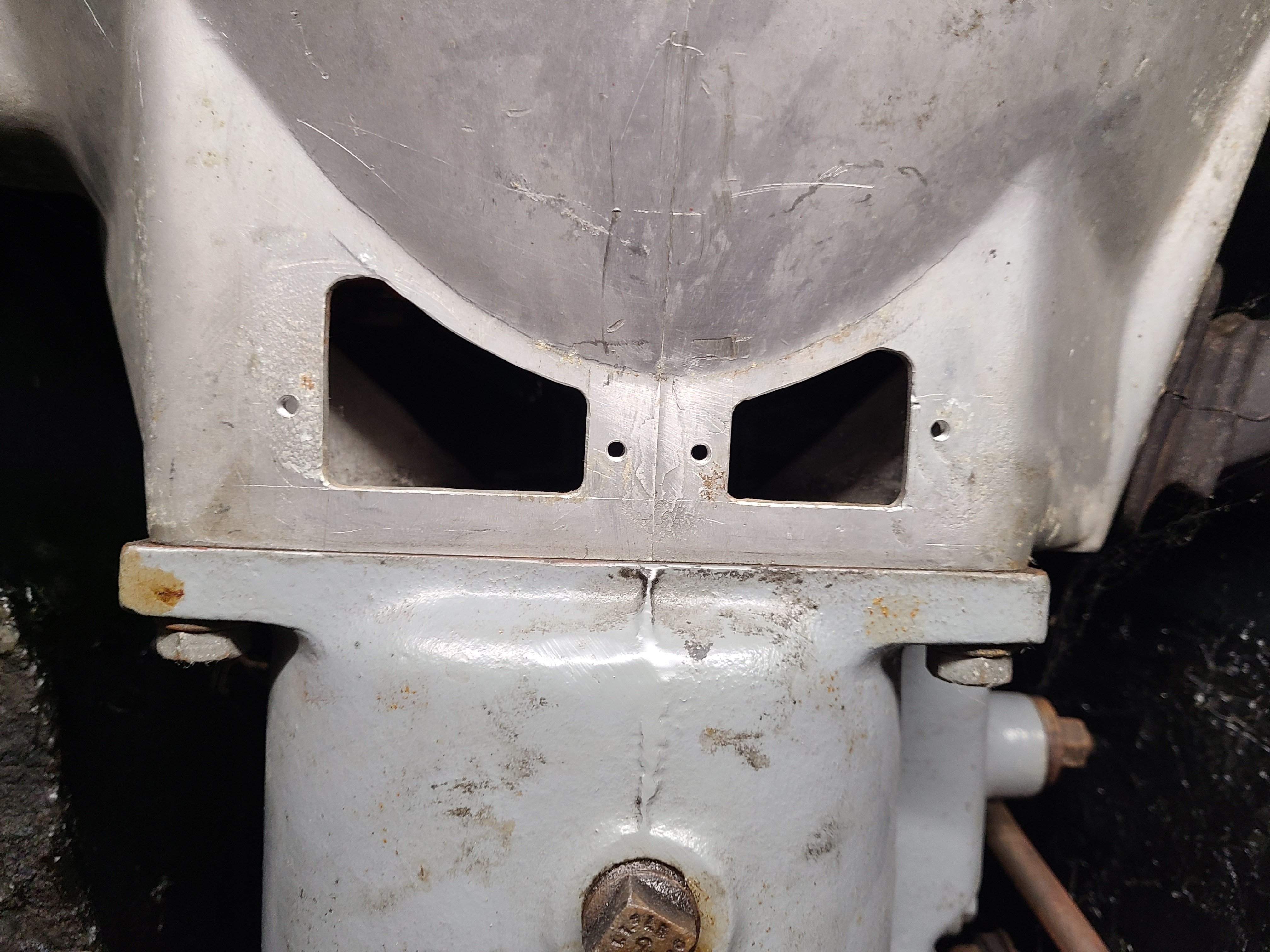

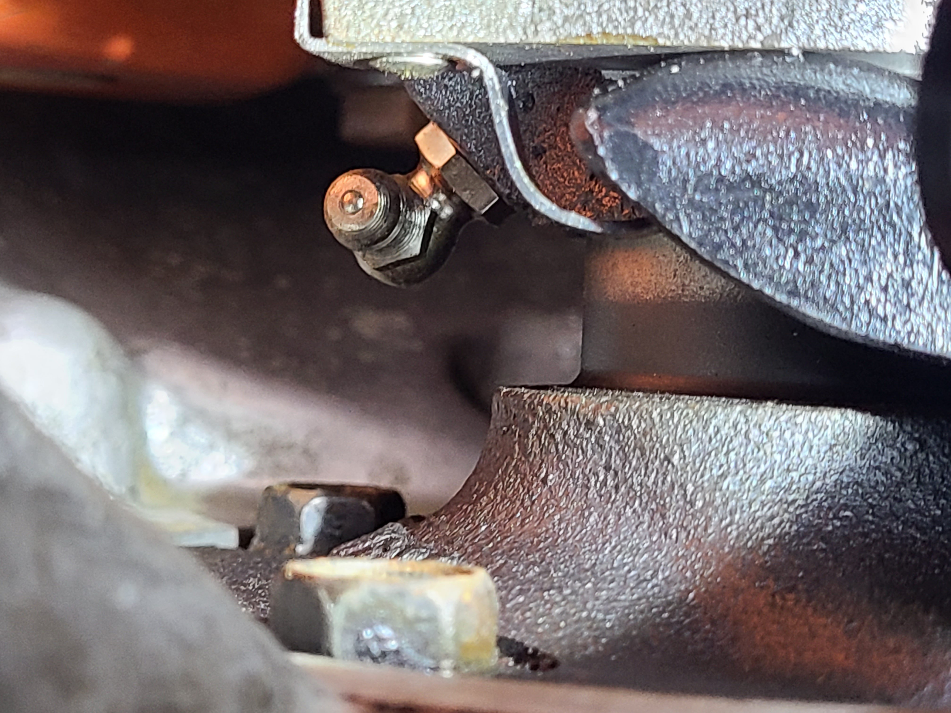

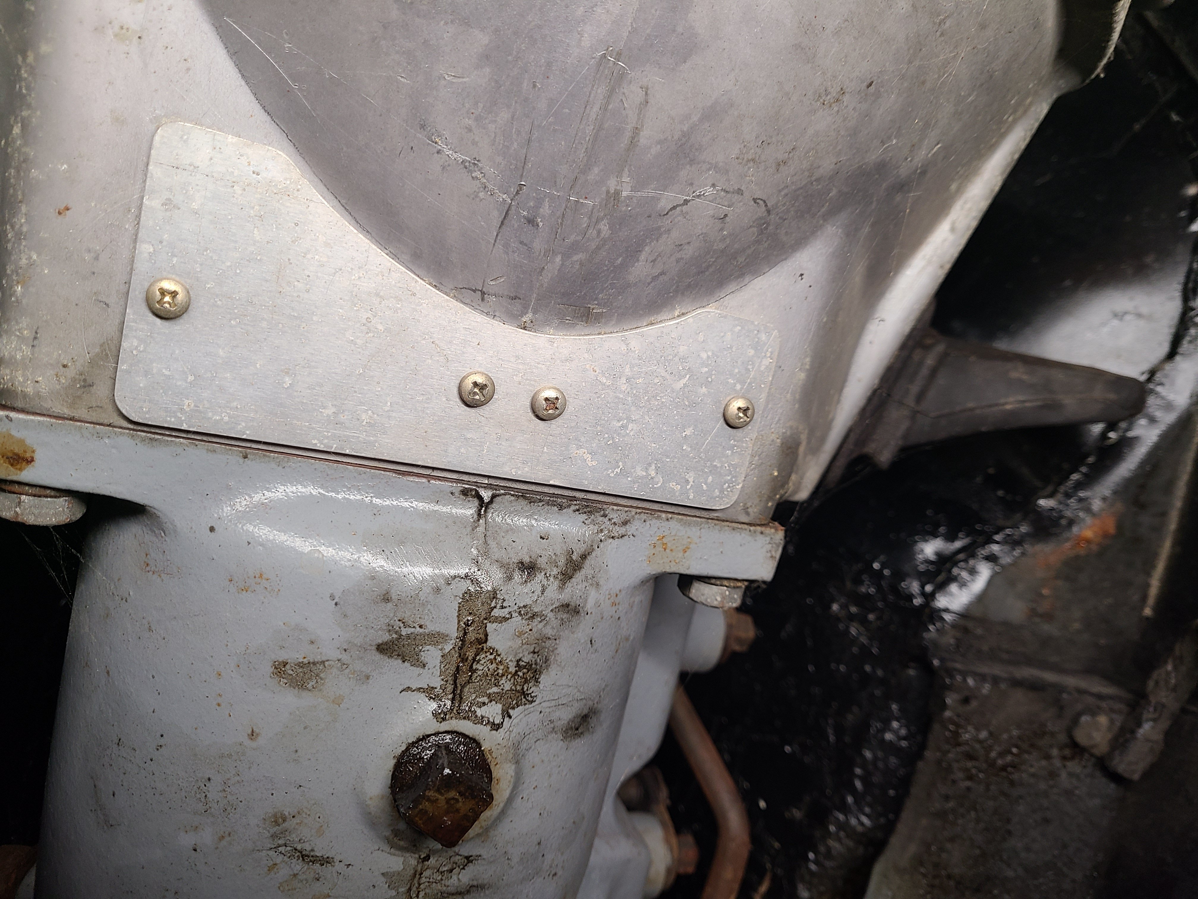

While this will no doubt meet with some disdain, I'll share my answer to the question. Many years ago, I installed a new Mcleod clutch assembly and it's throwout bearing also came with a zerk fitting. Coincidentally, I'd decided to change the clutch since I was going to be in there anyway, to change a noisy throwout. I felt the zerk was a good idea but yes, how to grease it? While a small hole in the bellhousing would work, I felt after looking over the bellhousing's internal webbing, that more area could be safely opened. I've put many miles on this car since, with no issues. Aside from "originality" deviation, I'm pleased that I can occasionally give the bearing a dab of grease while also inspecting the internals. Photos show inspection portal, throwout bearing's zerk fitting and portal cover. Note: I am not offering this as a recommendation. As always, any alterations must be carefully considered.

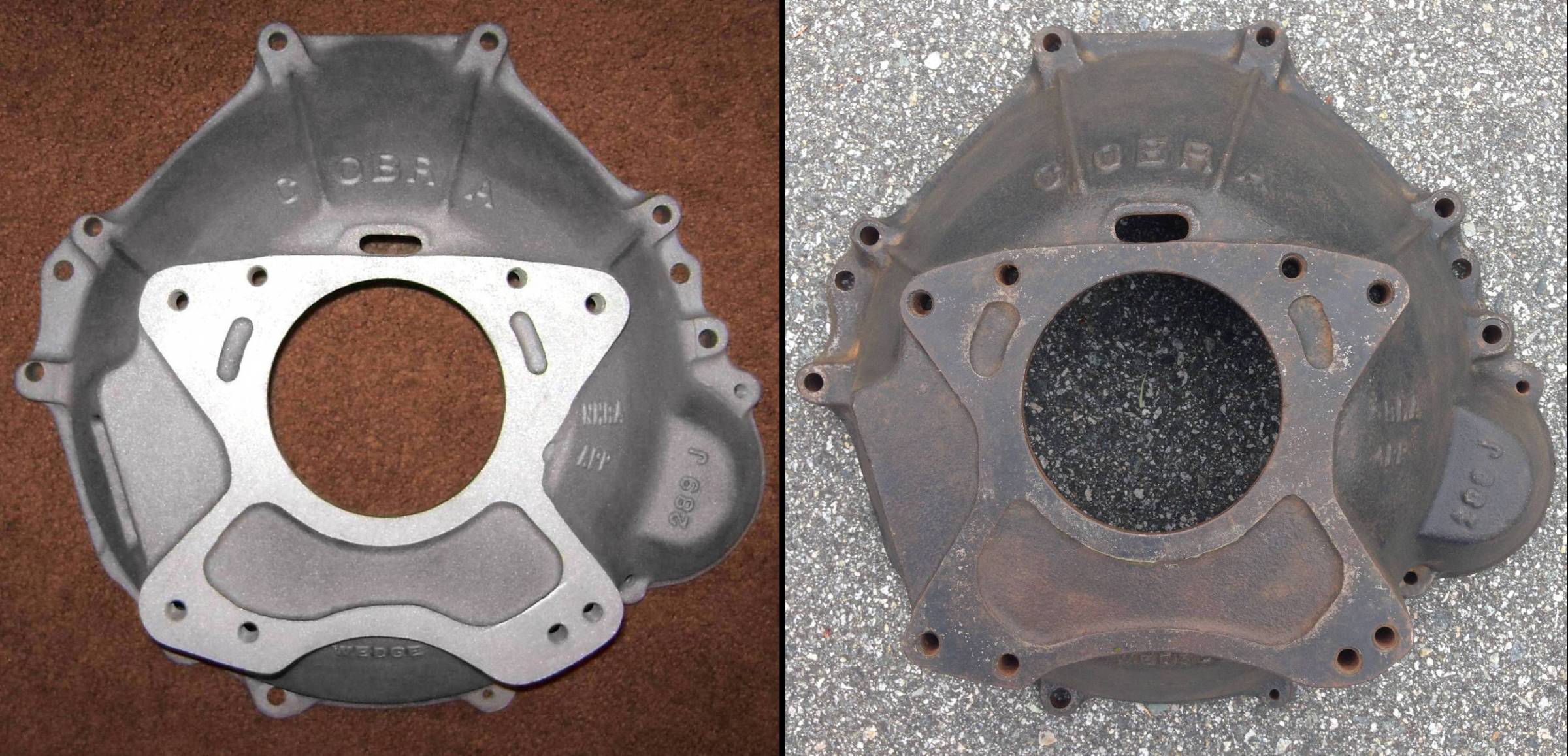

this mod is only possible on the 5 bolt bellhousing... owing to the construction of the bottom of the 6 bolt bell housing it isn't possible on the MK2 bellhousing

My engine is not original and it has a 6 bolt bellhousing. Thank you for sharing.

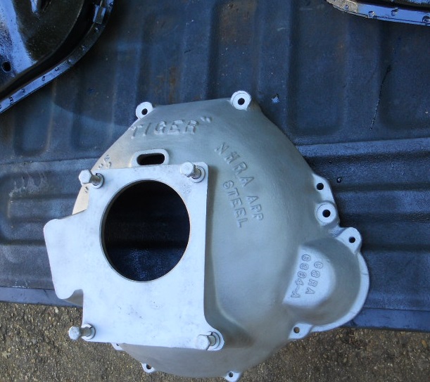

I have a mk1a in the shop currently.... it has it's original narrow case top loader... and a 302. The ONLY Ford bellhousing that will mate the two is a truck cast iron dual pattern bellhousing designed for an 11" clutch. The car in question has a Lakewood scatter shield designed for both the 10.5 and 11" clutch packs and has 2 locations for the starter to suit. The biggest issue with this scatter shield is that it is NOT possible to use the OE clutch slave cylinder mount bracket. This particular car has a welded tab on the side to support the clutch slave which required a 6" throwout rod in order to work properly.
Of course, you can run a wide case top loader or a 5 speed on the 6 bolt bellhousing... The 6 bolt bellhousing does not have a flat portion on the bottom like the 5 bolt bellhousing in the pics with the narrow case box.
There are rumors that Ford produced a 6 bolt bellhousing with provisions for mounting the narrow case and the wide case top loaders as a service replacement part. I have NEVER seen one... but I have seen bellhousing that have been modified by welding additional material to the inside to support the alternate mounting holes. In addition, the front bearing carrier/seal holder would have to be changed to the later wide case version to accurately center the input shaft in the later bell housing.

I ran that grazable McLeod for decades, assumed the zerk fitting was there for a reason, and greased carefully. A ball bearing does not need a lot.
