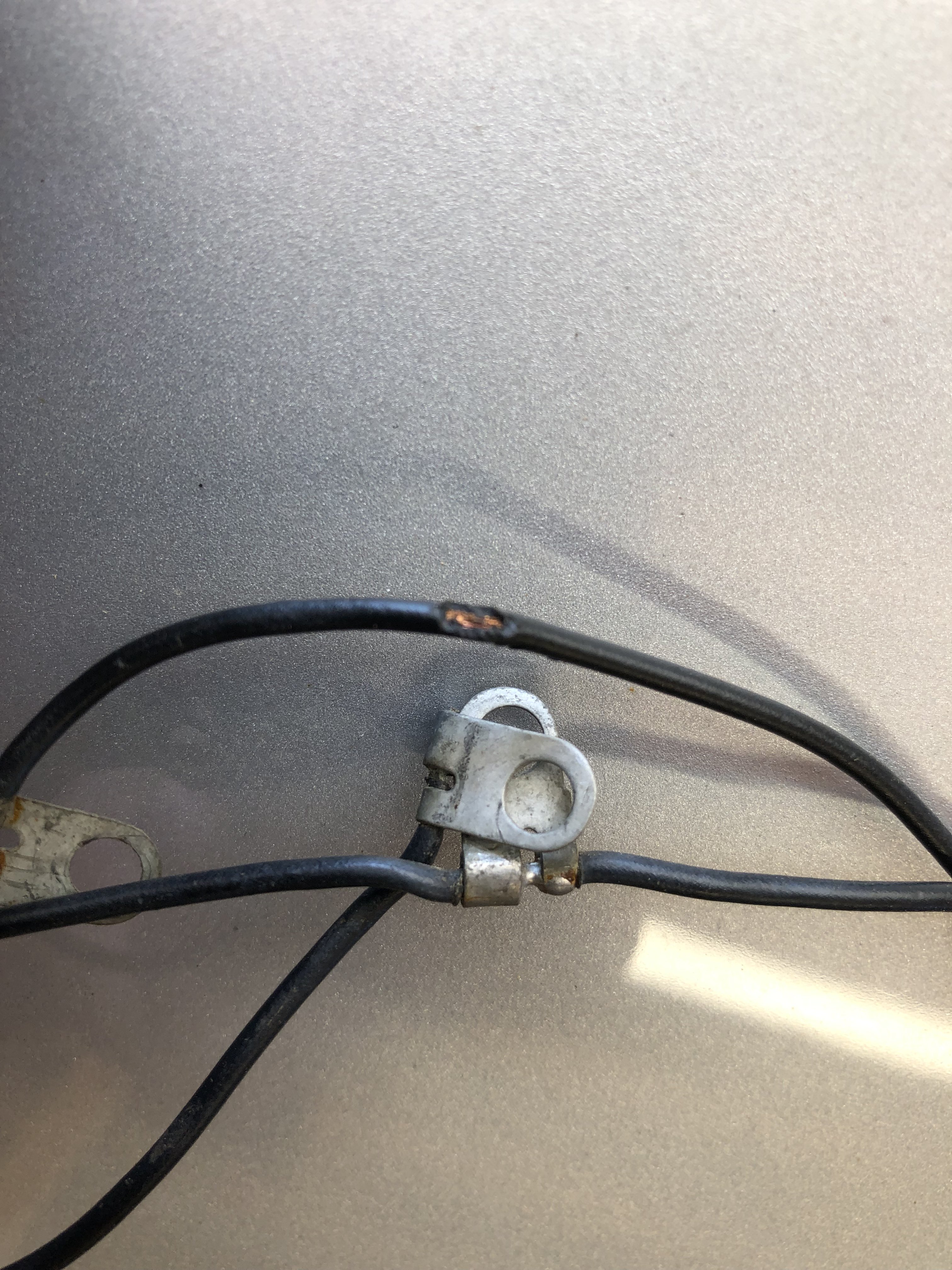

I can’t find the grounding wire harness that attaches all the instrument gauges together then goes to ground I would be interested in purchasing one from you or please attach a photo of one that is not installed alongside a measure so I can replicate one. Also where does it attach to the chassis?

The grounding "daisy chain" is a pair of black 18 gauge (or less) wires that loop from the steering tube mount (base ground) and move left or right. Simple crimp connectors mount under the instrument mounting nuts.

I'm sure I can find a spare original one in my boxes o' bits... there is one crimp connector substantially larger than the rest. This fits under the outboard 1/4-28 bolt that retains the dash extension (from interior bulkhead to dash) on the LH side. if you are running a clock and an ammeter (or voltmeter) you'll need to add a jumper as these were not accounted for in the original assembly

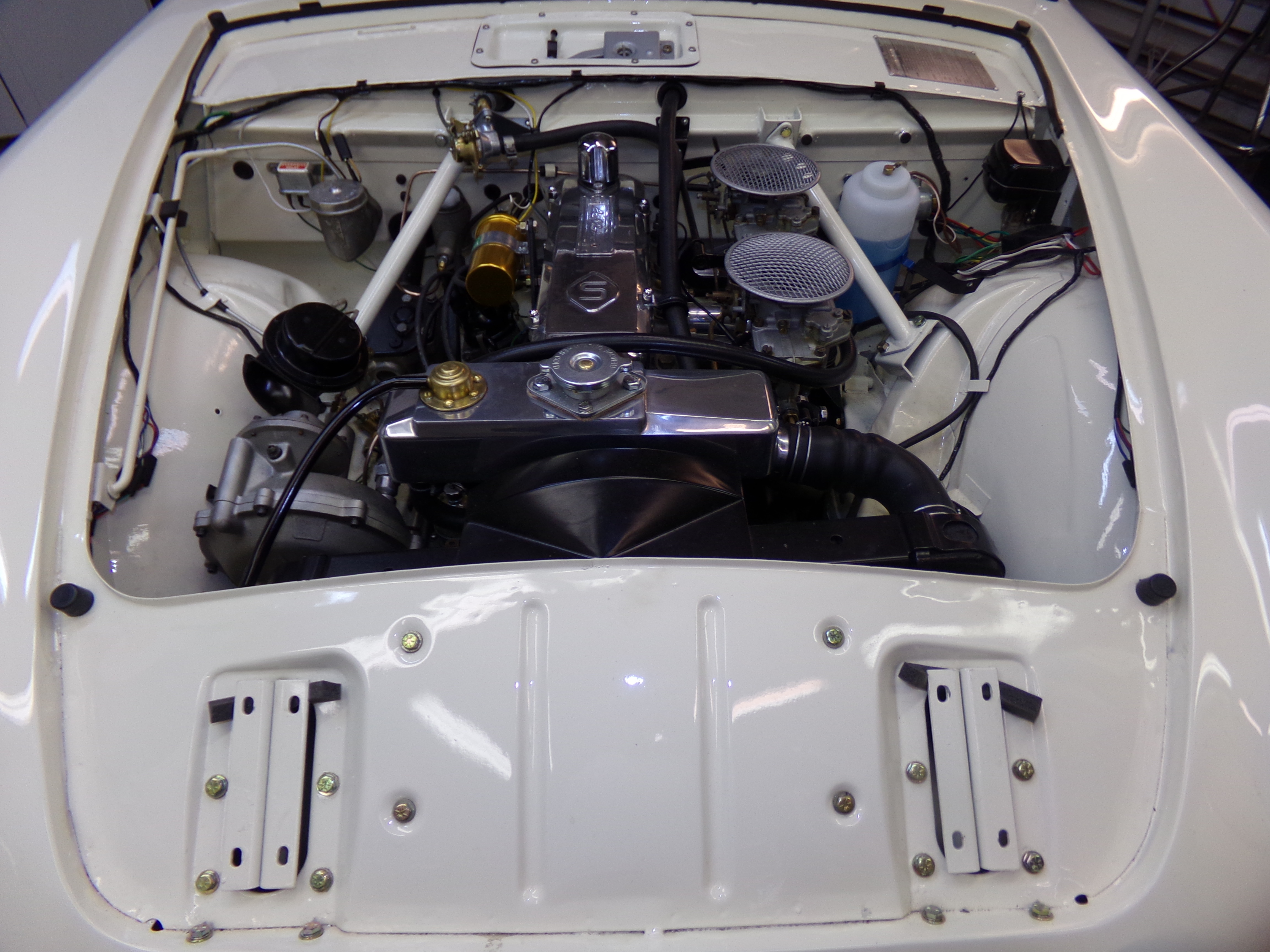

I use facet pumps from Pegasus Racing. They carry several different facet pumps ranging from 2 to 4 PSI up to 7 to 10 PSI. They all pull roughly 1 amp. An SU pump will pull in the range of 5 to 6 amps so with the facet pump the 5 amp fuse doesn't present a problem for me but the original pump pulling 6 amps would require a slightly higher amp fuse. As far as the lighter goes I guess you would need to know how many amps a phone charger or Garmin will pull. If you look at the corner of the bulkhead just above the voltage regulator in this photo you'll see the main Alpine
ground wire held by the large flat head machine screw. It does not serve as a ground for head lights or tail lights

found it ! So did the mouse but luckily he dined out mostly because this is the only wire that was nibbled on 😊
