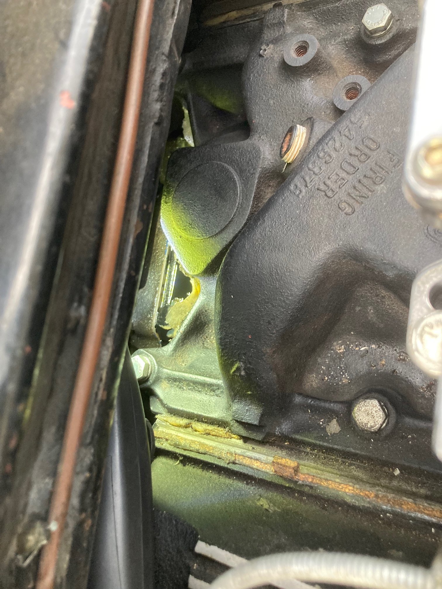

Update:
After renewing the dreaded german TUV yesterday - fortunately with only minor issues - I checked deeply again about that nasty oil leak dripping down from the clutch bellhousing. Carb off and a bright light revealed oil coming out of the rear portion of the inlet manifold (check the picture). Everything off today, thorough cleaning of all sealing surfaces, no more cork strips, thick beads of RTV and hey presto - it seems to work. No more oil - at least so far. Let's see...
