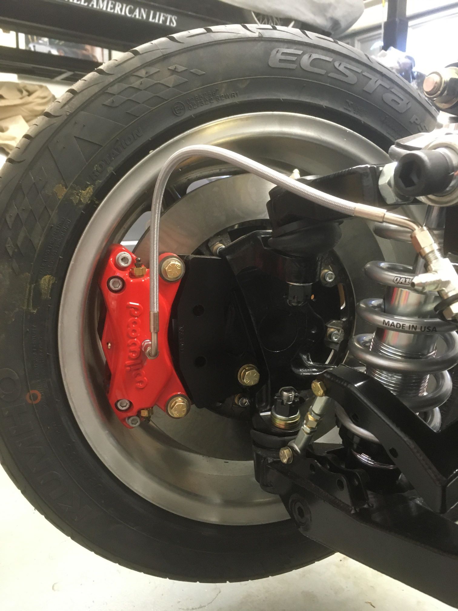

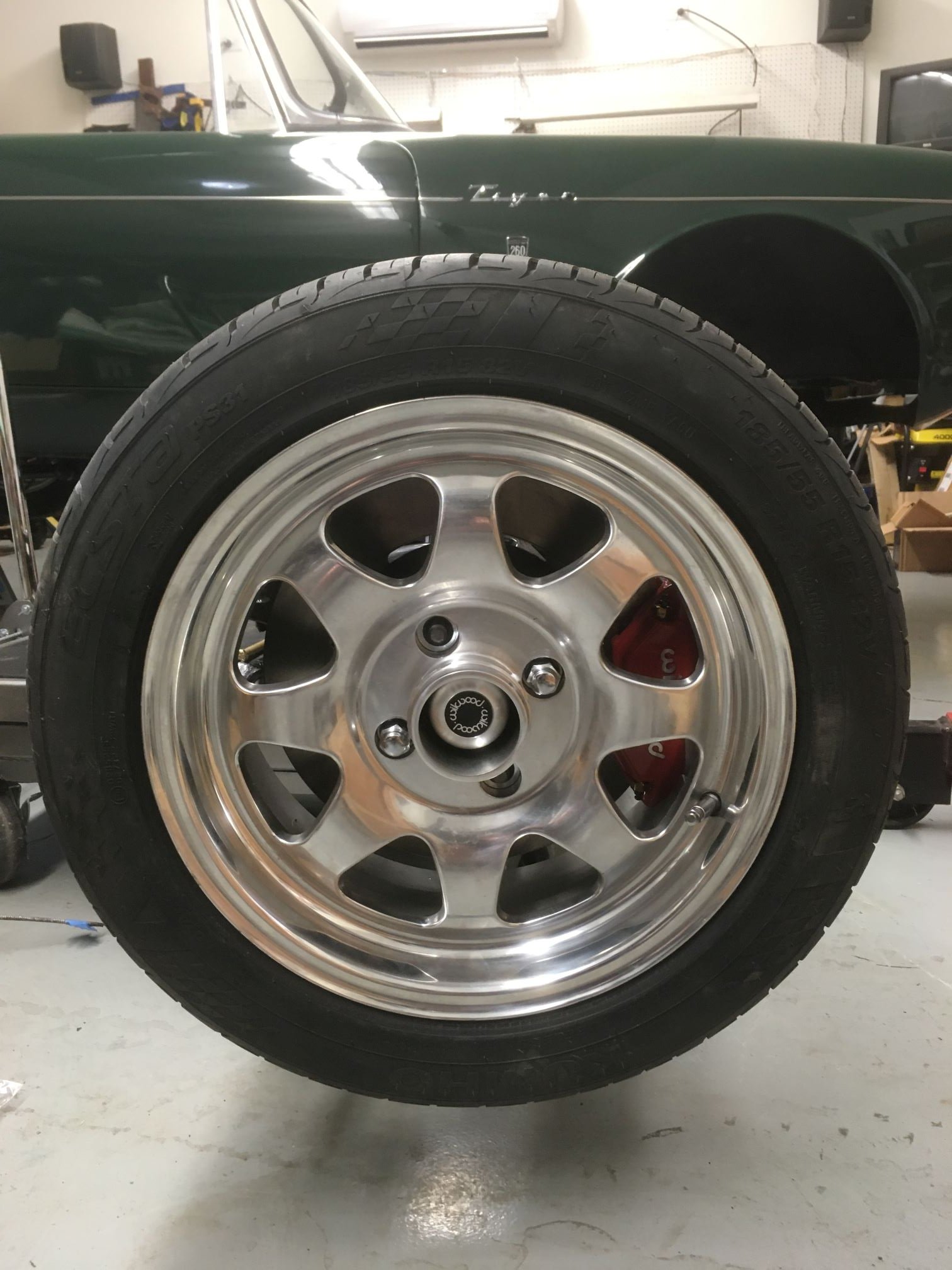

Sorry that I didn't see your post earlier. The 15" LAT 70 tribute? wheels (some are sensitive about terminology here) do just fit, as you have discovered. These are the pics I sent to Dale in 2020.

That is a close tolerance 😮
It is close, probably less than the thickness of a couple of coins, but not so much to be a problem. If I remember, my wheel weights are in the middle, behind the spokes and on the smaller diameter dropped-center section of the wheel, and they do not interfere with the calipers.
