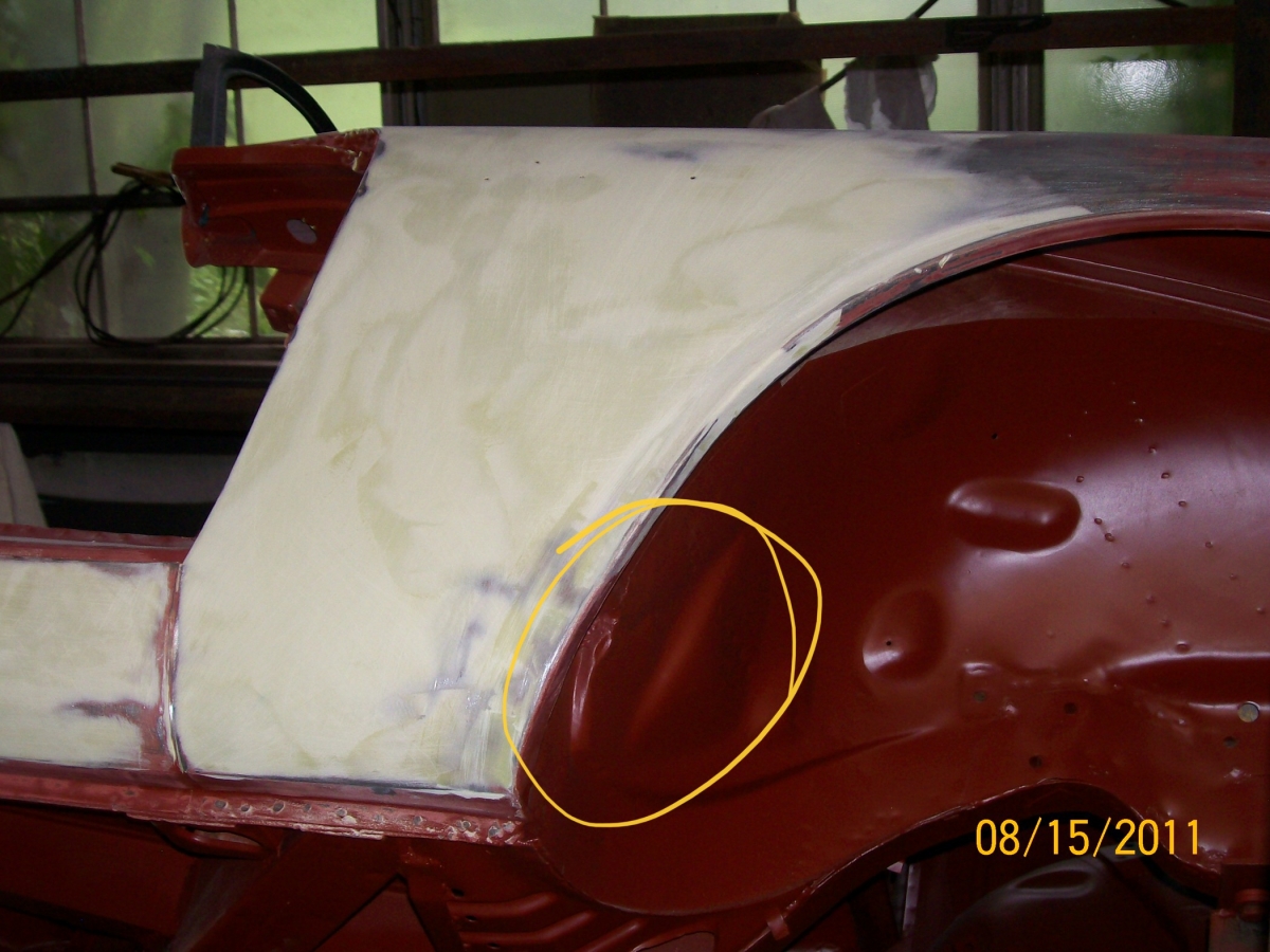

Are you wanting the stepped Fitch panel area where the sills join the inner wheel arch?

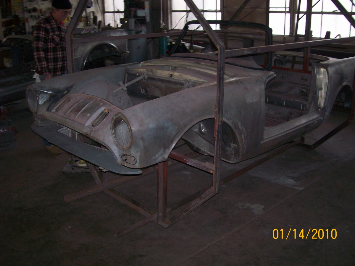

These are photos of the right hand inner fender of one of my cars when being restored at Tiger Auto in Dayton.

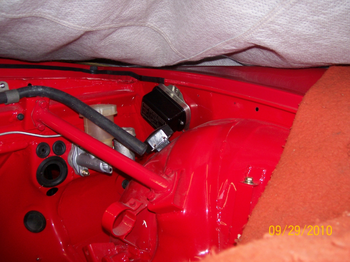

A couple more photos of the engine bay showing the inner fender areas of the Tiger as well as a photo of the inner fender on the left hand side.

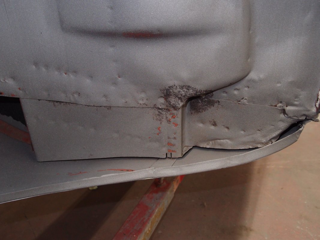

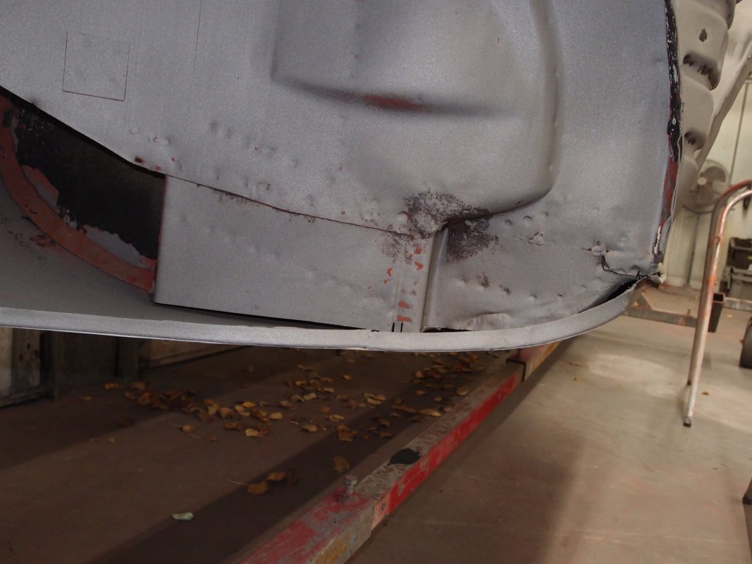

It’s the construction of this area that’s my problem.
i believe this is what you're after... the pics show the area in bare metal so you can see how the individual panels are welded together
