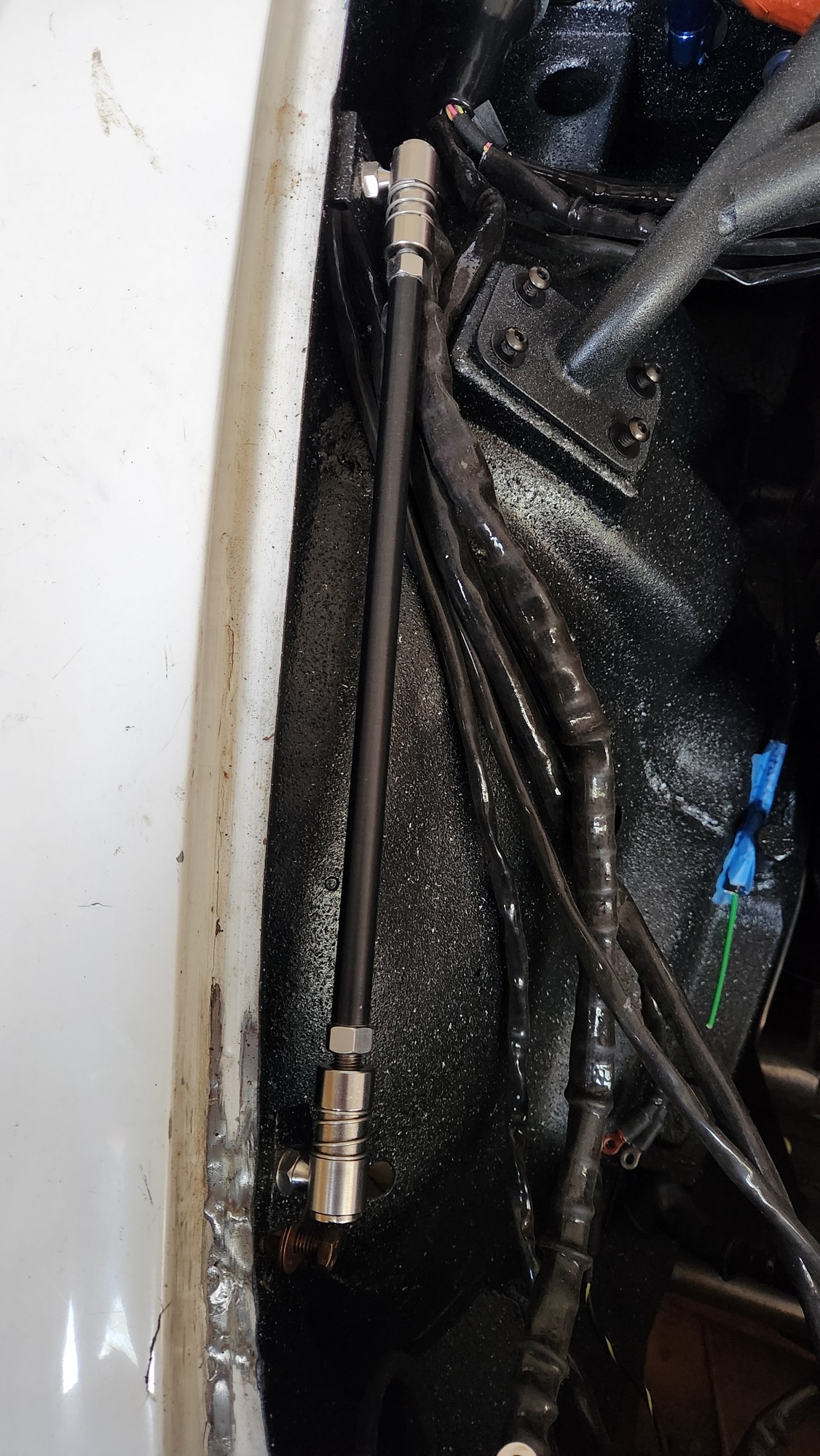

Did the same treatment with the hood prop rod. Used some of the spring loaded rod ends that snap on to a ball stud. Ran into a fitment issue when I started putting things back together with the prop rod hitting the Ignition coil. Par for the course as they say... Otherwise just need to get a hood back on the car to make that part.

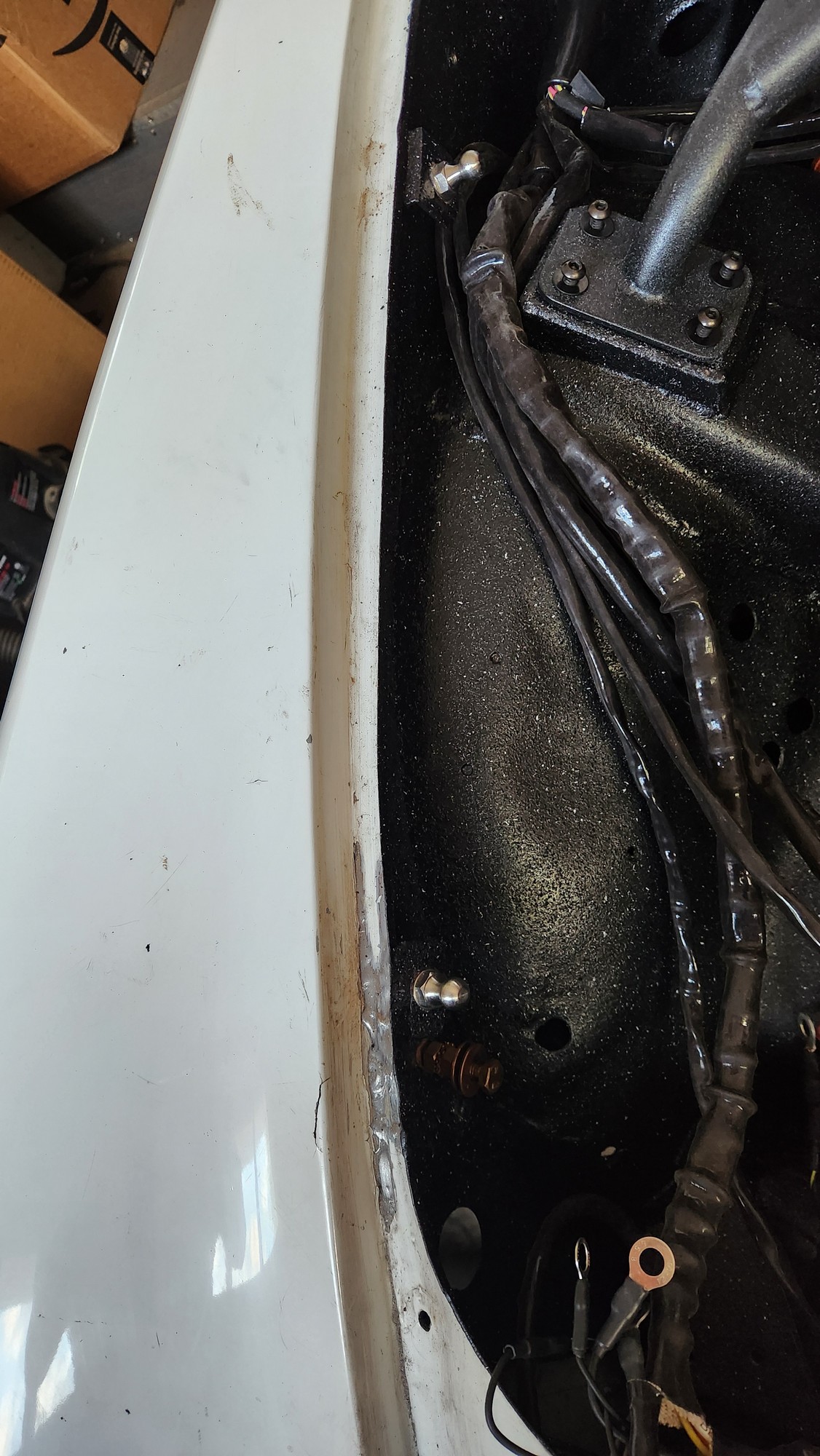

Added the 2 Ball Studs to the existing mounts, the one closest to the front was welded up as it seemed to be loose. So caught that before painting it.

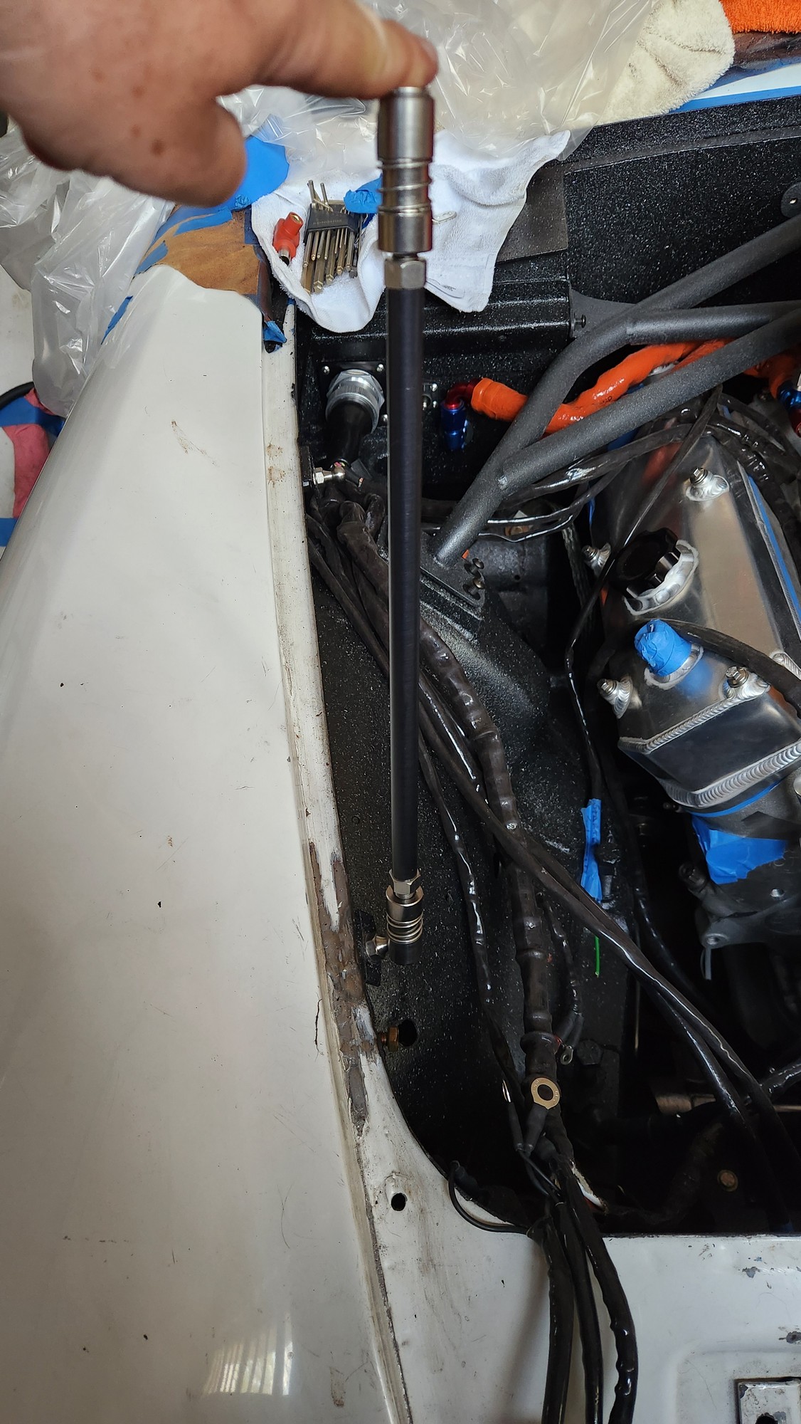

Measuring the length of the needed rod. One side was already done.

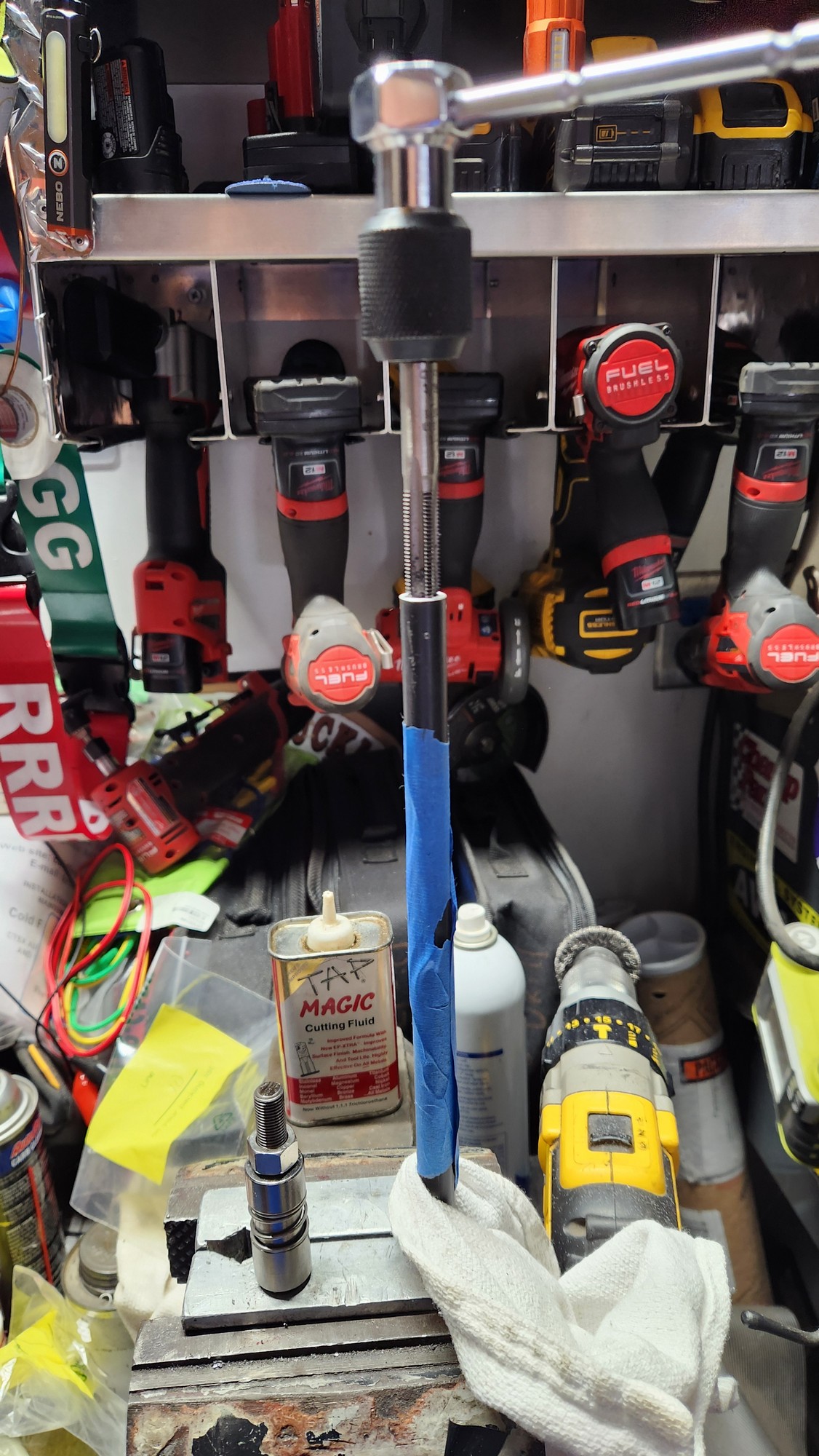

The aluminum tubing was for shifter rods, so the ID of the tube was made for directly tapping a 3/8-24 thread

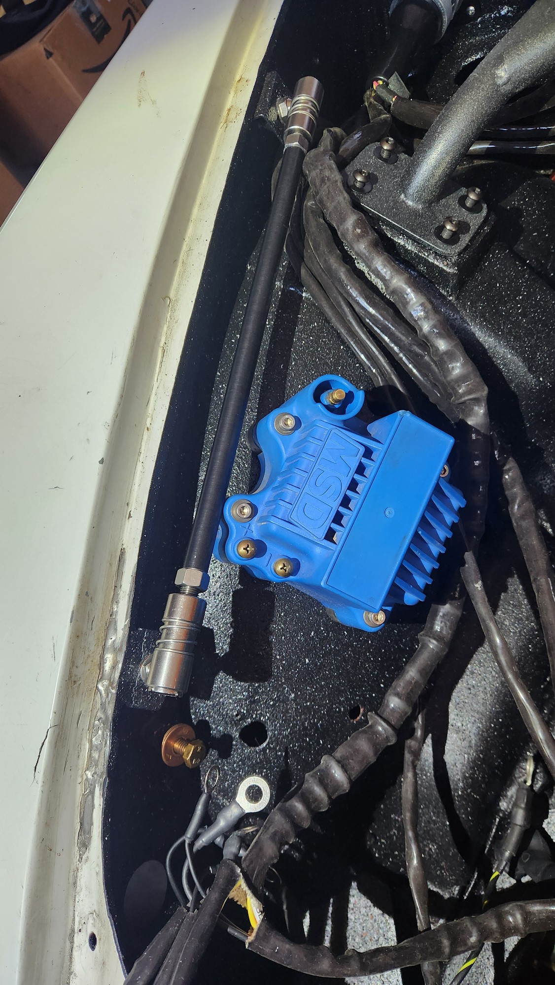

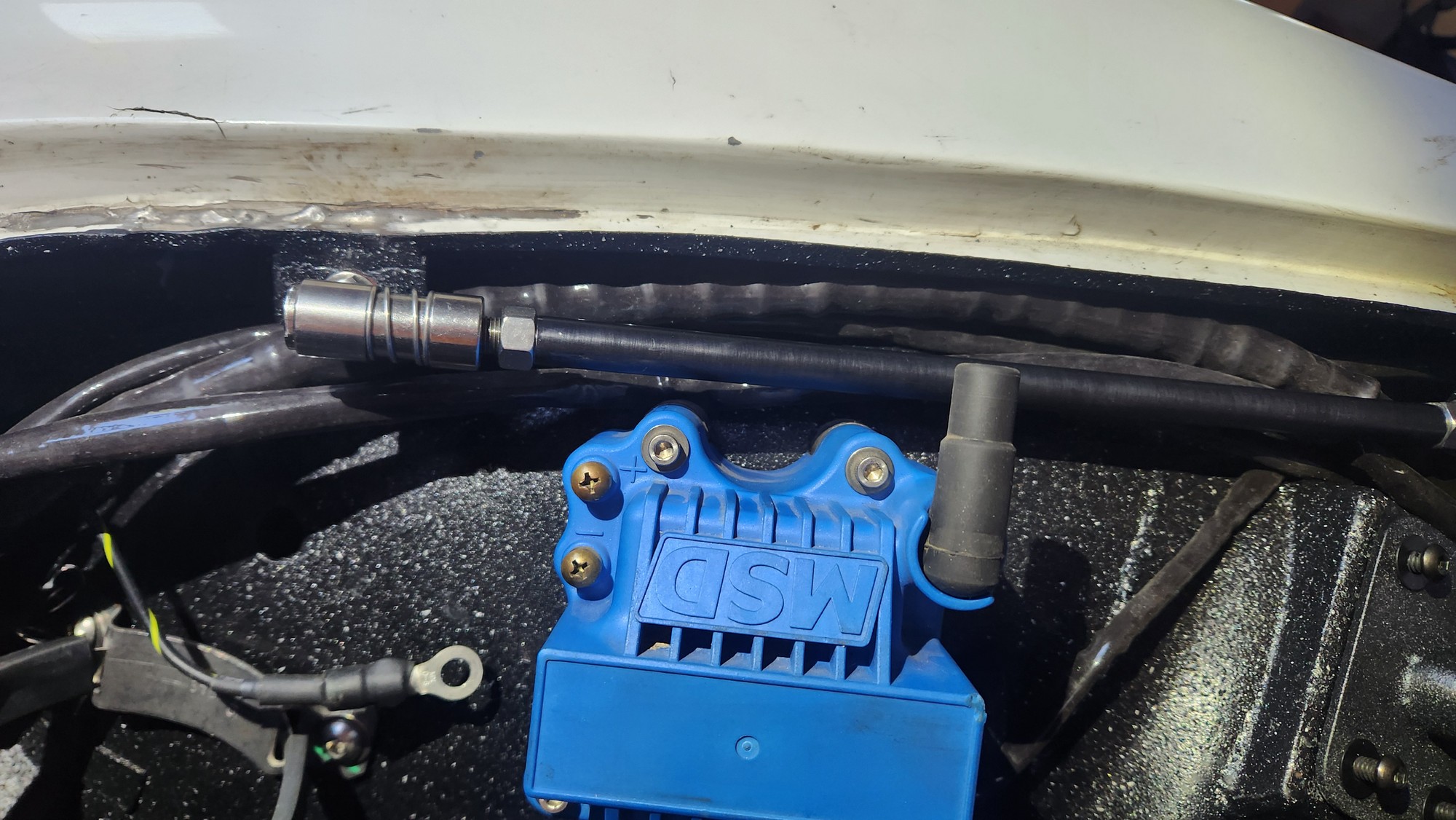

Missed it by that much (picture of fingers close together). Seems I mounted the MSD coil just a bit too high, more holes will solve that problem!
With the coil moved down (mostly twisted) a bit, the prop rod can be removed and now does not hit the coil.

Is the idea to leave it clipped onto the 2 ball studs on the car, and then when in use you release one end and clip it onto a ball stud on the hood? That's pretty cool.
sandy
349
Yes, exactly. I had a snap in plastic clip for one side but I liked the secure of the metal to metal lock. Also it could be used in the Trunk/Boot as a prop rod as a back up as it's almost the same length. The ends are expensive, about $25 each in stainless, much less in plain steel. Likely a smaller size too would be a better choice as these are 3/8" but 5/16" would be perfect.
