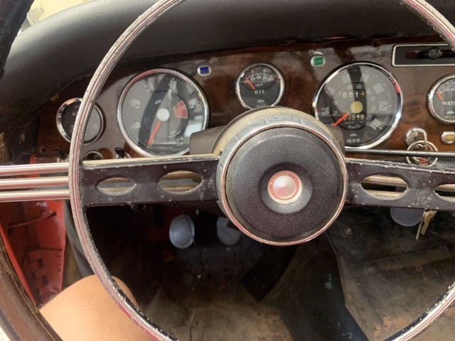

So, I can't get to first base. Does the center foam black piece pull off? If so, mine is really stuck. The chrome ring the foam piece is attached to unscrews a fair way, but it will not remove.
Some guidance would be much appreciated. I don't want to destroy anything.

The center part that unscrews does so in order that you can adjust the steering wheel in and out. Unscrewing it loosens the "lock" and screwing it tightens it up so the wheel will not move.
Yes, the padded part (but NOT the hard, black plastic) comes off. Grasp it by the chrome ring and pull it away from the black plastic. Behind it you will see a bolt holding the black plastic piece to the end of the steering column. Remove that nut and you can remove the plastic adjuster piece. HINT: Tighten the steering wheel adjust before you remove anything. Otherwise, the adjustment dohickey (technical term) inside the steering column might slip down inside and it can be a pain the butt to retrieve.

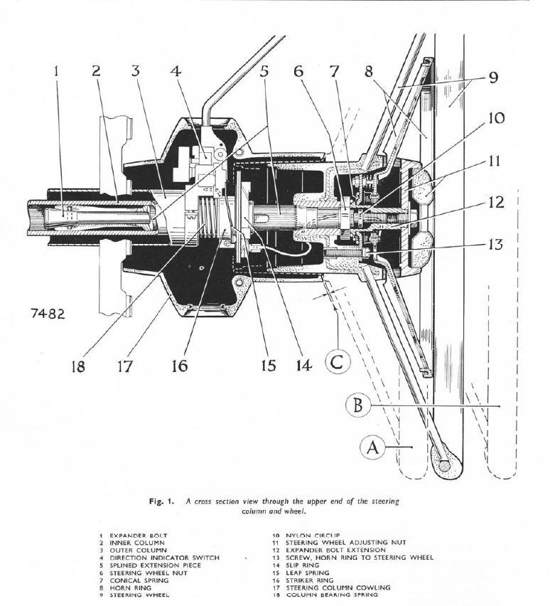

Attached are two snapshots from the workshop manual. The first is of the steering wheel. Note that it shows part 11, which actually is in two pieces - the outer padded section and the hard, black plastic piece. It is called the steering wheel adjusting nut.

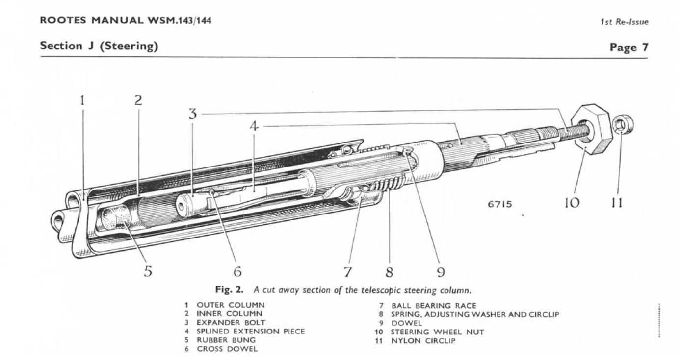

The other snapshot is of the steering column, to give you a better idea about all the parts in it and so you can see the hardware that allows the steering wheel to be adjusted and locked into place.

Thanks David,
The key was grasping the chrome ring, not the soft center. I do have the workshop manual. I says to prise off the motif. I didn't know what the motif consisted of, and online description of how to do this did not say to grasp behind chrome ring.
