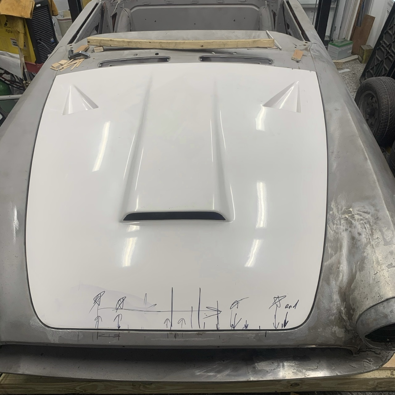

Mine needed trimming and some reshaping of the sides to get it to fit. I then addd back the fiberglass lip to the areas I had thinned out to get the gaps correct. The lip in the front was completely eliminated because the hood would not open with it in place. The gap required for the hood to open with the front lip in place was enormous.
Also, Jeff used metric threaded inserts for the hinges and lock so that took a while to figure outšŸ˜Š
I am pretty happy with it. I just need to paint it. I am getting close.
