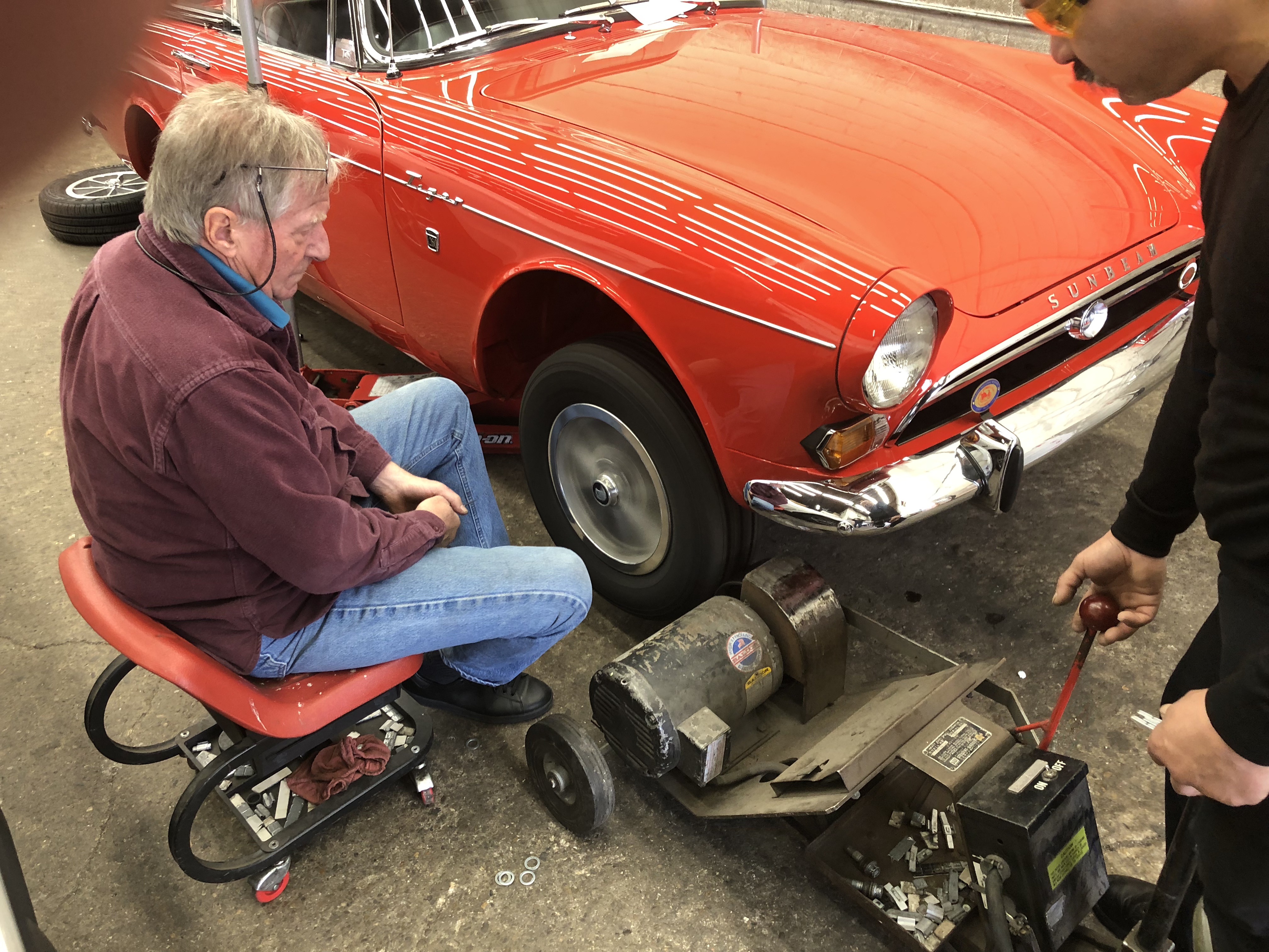

Just went through this a couple weeks ago. I s visited several shops and all said no way. You need to find an “old school” guy to do this. My guy balanced the wheels on the car. He uses a machine to spin the wheels and he adds/moves weights until he cannot feel any vibration in fender. It was a slow, tedious process. See photo. I am also told a bubble balancing machine would work. You can buy them online, but I did not want to go that route.

I just went through exactly the same process. The tech who has been using the same machine for over 40 years could not dial in my left front. Right front trued up fairly quick and easy and he didn’t even attempt the rears. He had two hours on the left front and got a fair amount of vibration out. I refuse to ruin these wheels by cutting off the caps. There must be another alternative.
