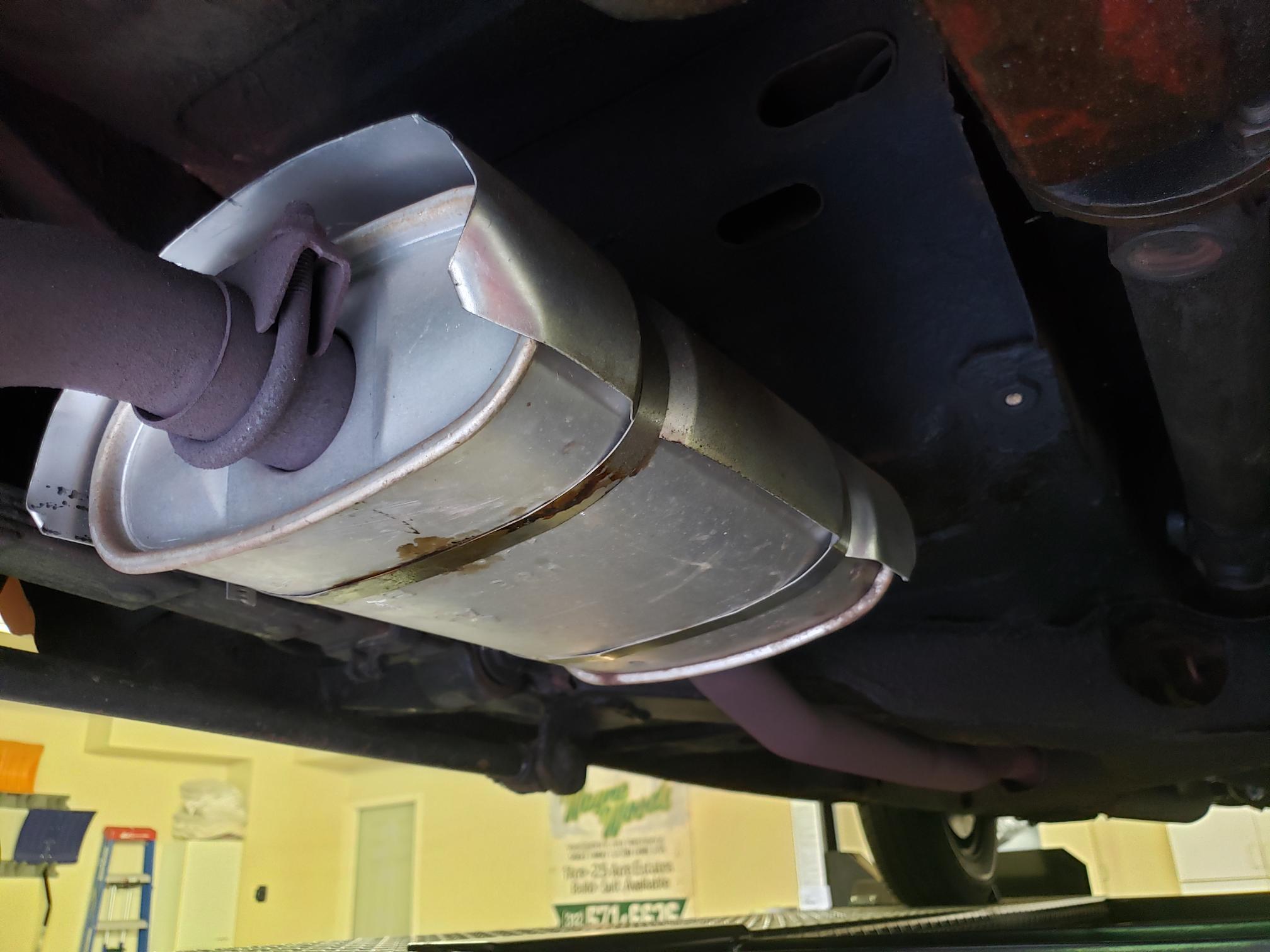

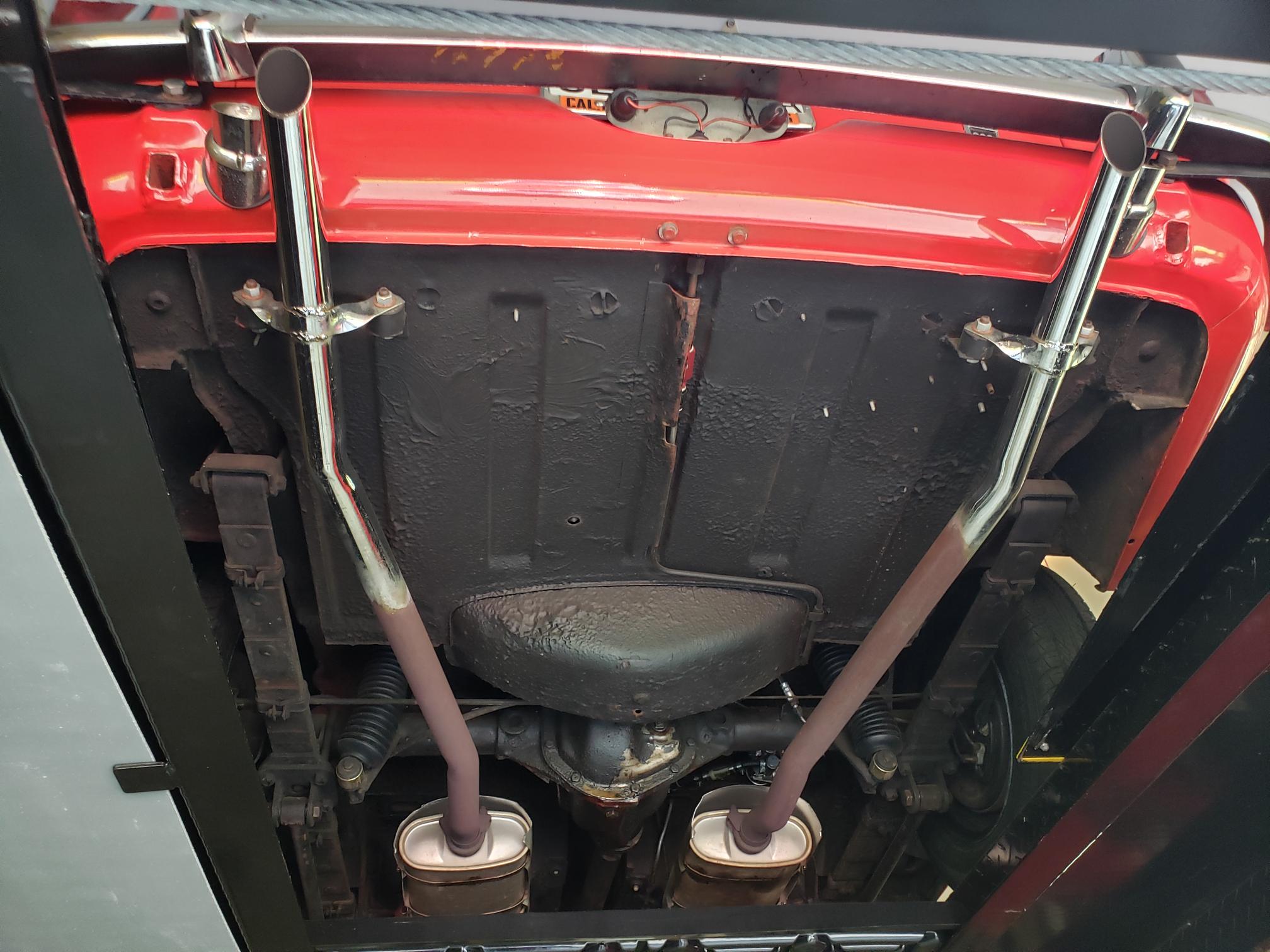

I have a pretty stock muffler system and need to replace the muffler and can't find a size small enough. Here is that I see:
*Exhaust pipe measures 1.770" outside diameter on both sides of the muffler
*Muffler case is 11" long, 8.5" wide
*Inlet is offset
*Outlet in centered
*Pipes slip into each end of the muffler and are clamped
Is this fairly stock and any ideas on where to get small 1.75" mufflers?

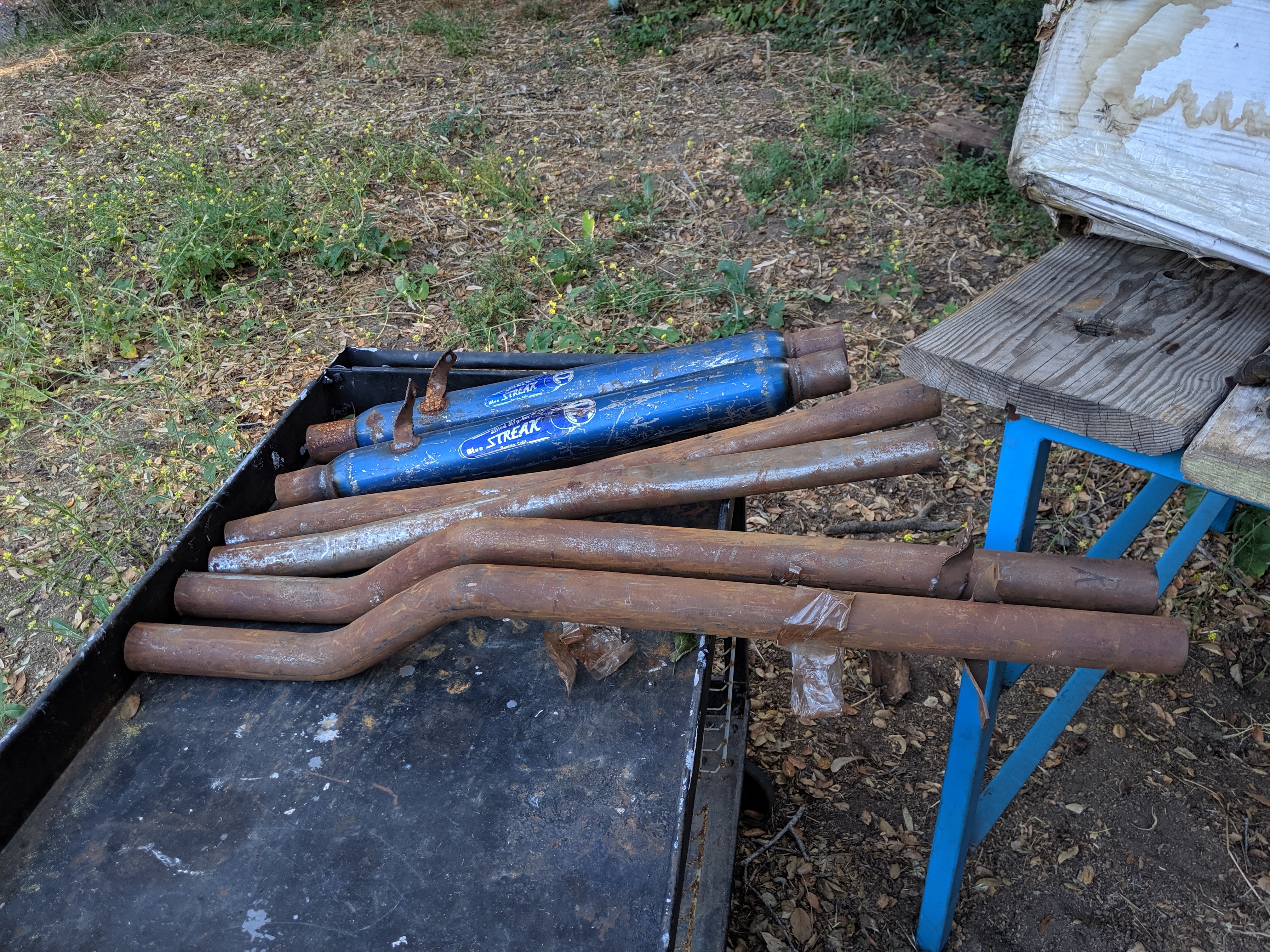

Having seen a set in the rusty pile of stuff outside Dale's....
I'm wondering is the only reasonable facsimile a S.S. stainless set?
I'm very interested in this topic as well.
The picture below are these hot dogs?
Do have a picture of what's said to be LAT 2" pipes and mufflers .

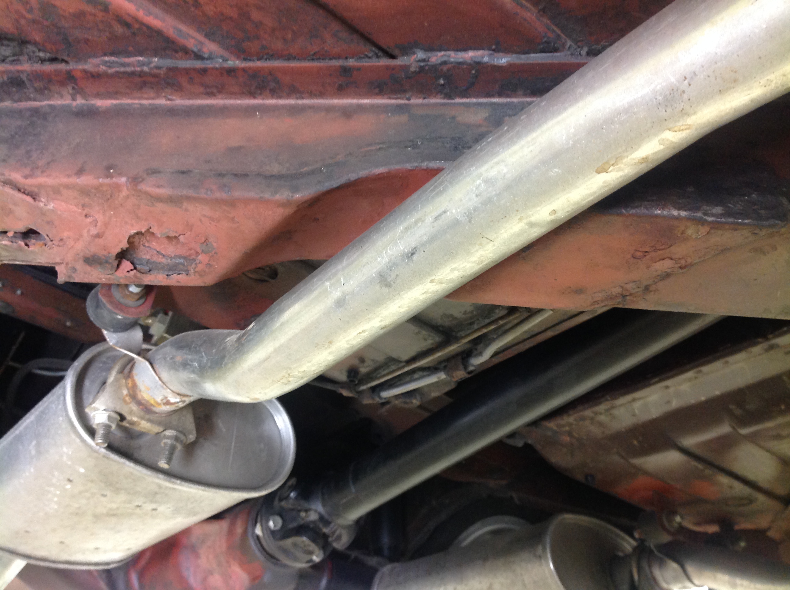

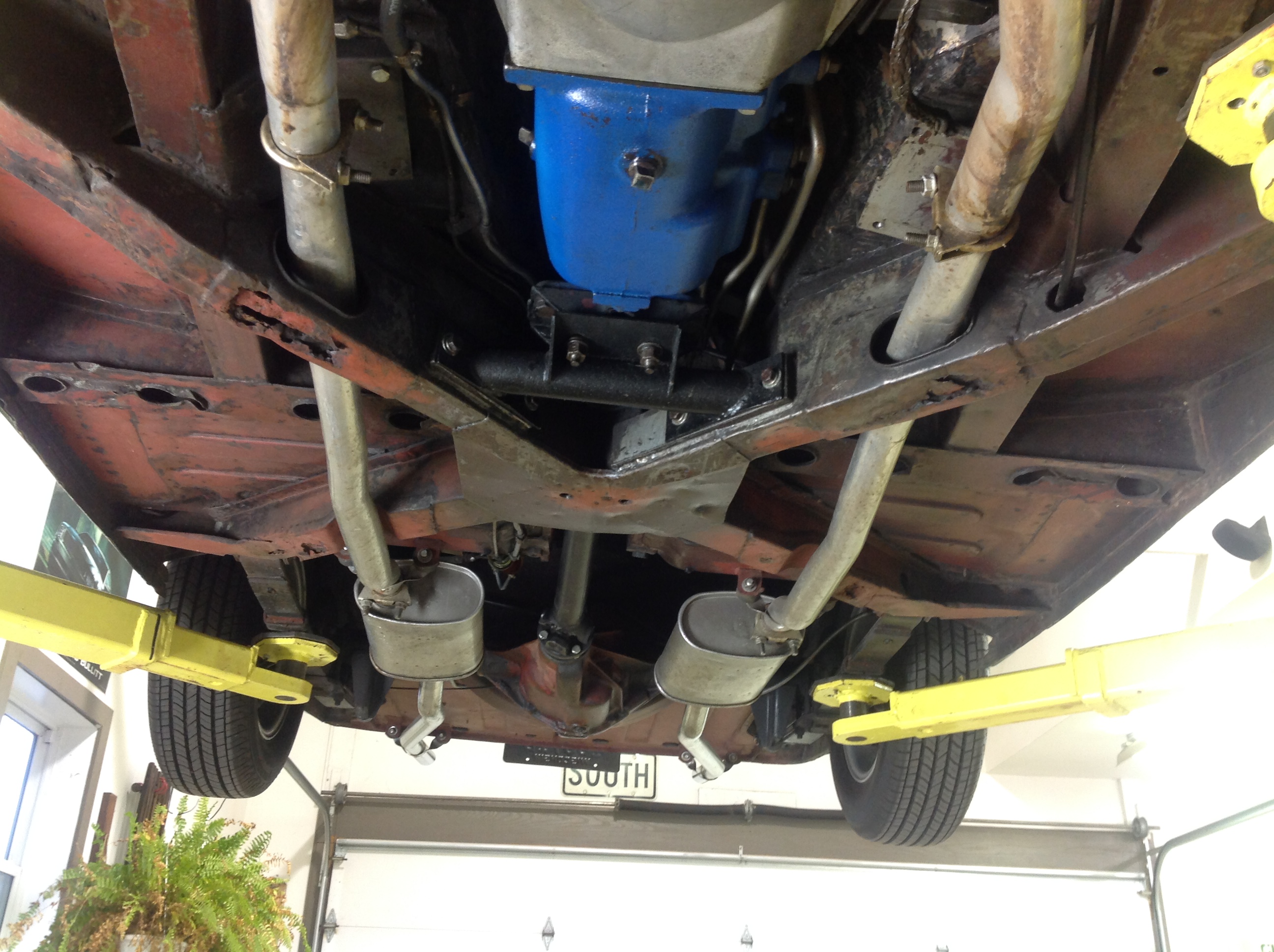

Arnie-I purchased an exhaust system for my Mk1 in 2010 from Laurent Parquet I believe he is near Quebec. He made custom systems and showed them at the United in Maine. I don't know if he is in business but some Canadians may know of his system. The muffler had an optional baffle to quite it down if wanted.
