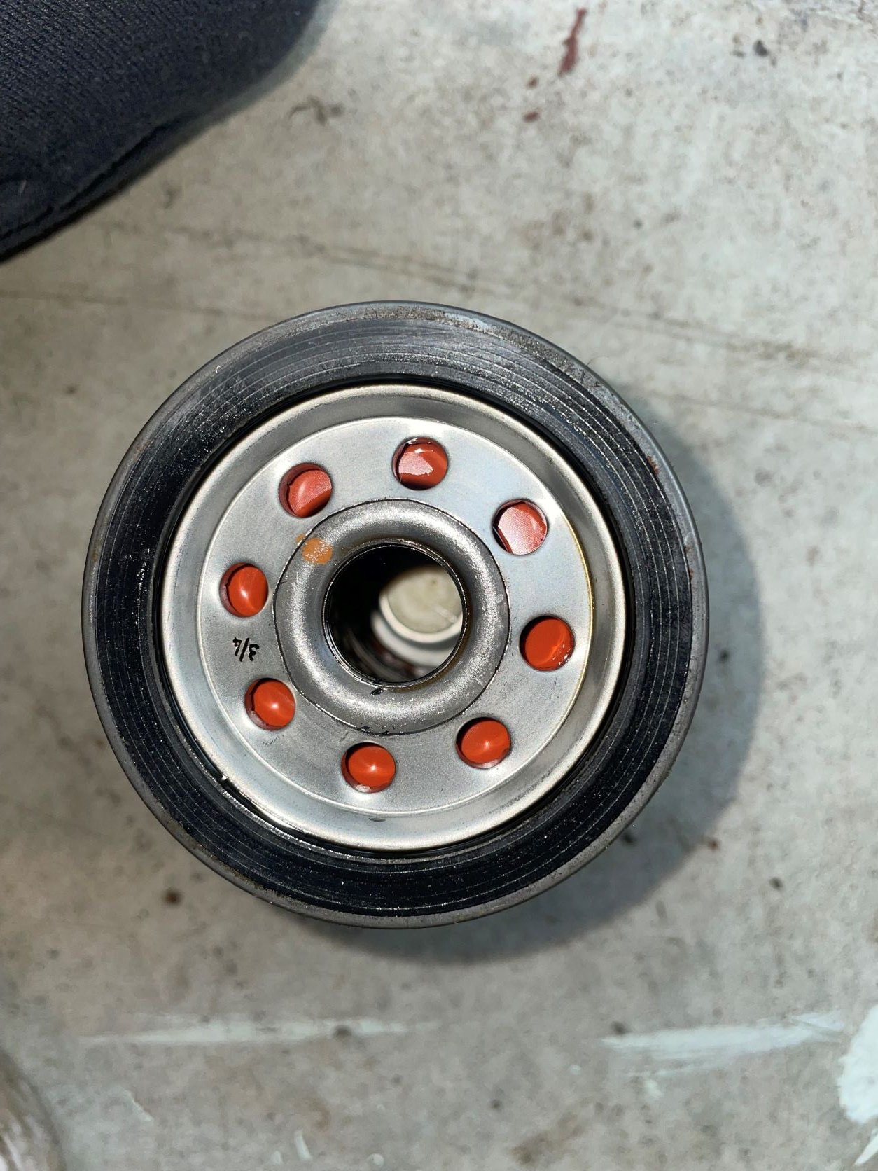

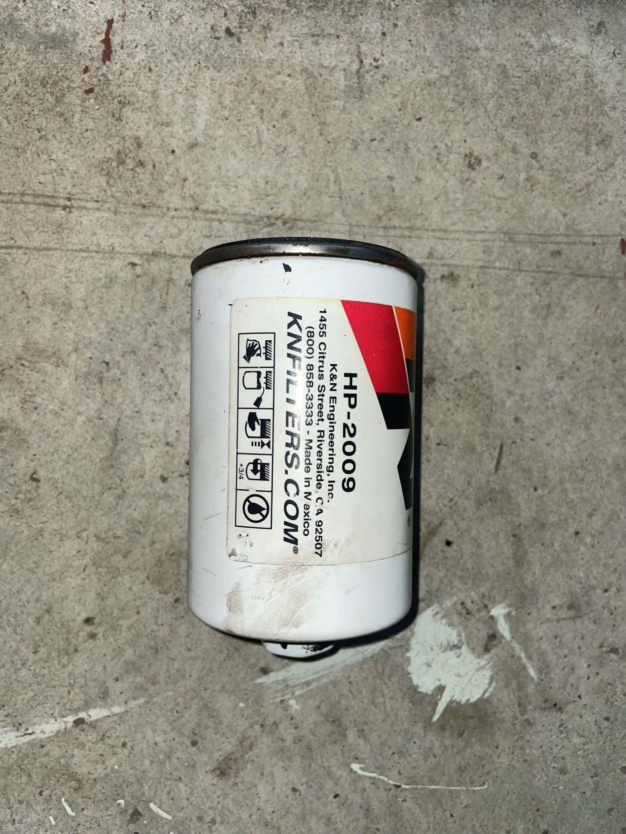

I went to change my oil in the Tiger today and on removel of the oil filter I found it bone dry inside and as clean as new.
It has never had oil passing through it. The engine is a 5.0L with a Ford motorsport angled adaptor on it with a K&N HP-2009
which is a narrower dia filter to fit in beside the chassis rail.
I think it must be the oil pump pressure relief valve which is not allowing oil into the filter. From what I have found out googling the valve is part of the pump and I will need to remove the pump to check it.
It has always had good oil pressure and in the past oil changes oil in the filter. Any advice or thoughts appreciated before I tear it apart.

The pictures didn't load for me intially, so my thought was perhaps and anti drain back valve in the filter being stuck and not letting oil in...
But perhaps more likely the bypass valve in the filter was faulty and stopped oil ever going in.
I'd take/ send the filter back to the supplier and get them to inspect it... Id suspect that could be the issue...
if the ORPV was stuck you would have had issues with oil pressure.. I suspect this might be an issue with the filter.

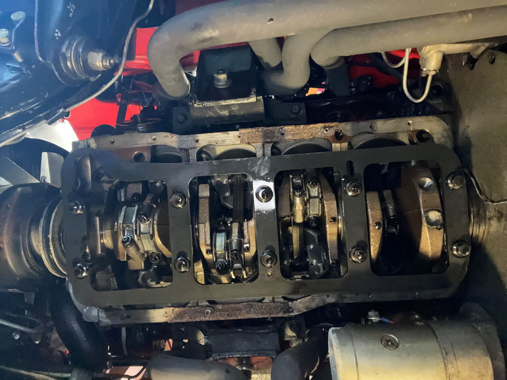

Michael. I didn't record the milage at the last change. I think you are correct with your theory of a bad filter. I ended up droping the sump and removing the pump and everything seems fine with the pressure relief valve. It's an easy job on my Tiger as i have a smaller high torque starter so there is nothing in the way.

Oil filters flow the opposite way most people think: oil is pumped into the small outside holes and comes out the big middle hole. A faulty anti-drainback valve (orange in the picture above) on the filter can prevent oil entering it; you can test that with a punch pushed into the holes. If it seems ok then you can disconnect the coil and crank the engine briefly with the filer off; it can be messy depending the the filer arrangement on your motor. Or you can just try another and see if the filter gets warm when you run the motor.

I took the K&N back to Repco where I purchased it from over 2 years ago. They are going to return it to K&N and see what they have to say.
They did have a Napa gold filter the same dia etc which they gave to me after all that time, so thumbs up to Repco. I fitted the pump and sump and
filled it up with oil, took note of the level on the dipstick and fired it up. The level on the dipstick dropped so I figured it went into the filter.
I took it for a run and all seems fine and the filter is nice and hot so it must be full of oil.
