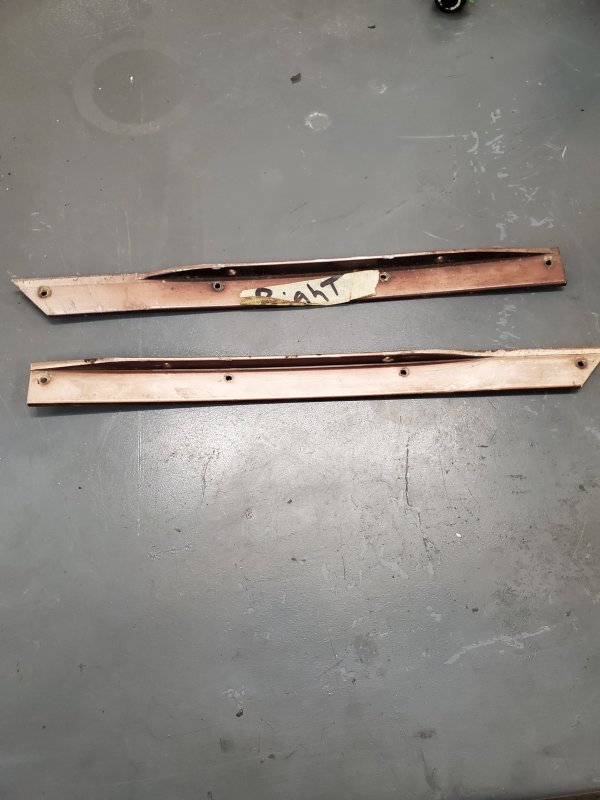

I am at that point in my restoration that I need to install a convertible top on my MK1a project. I want to go with a Stayfast (canvas) type top. A friend of mine has a Stayfast top on his car. He told me not to use the side mounting rails, because they would make it impossible to fold the top down into the well.
Have you found that to be the case on your car? Please let me know if you have the side mounting rails installed and what type of top do you have. Any issues in being able to properly fold the top down?
if you try to use these to secure the sides of the top, whatever the material, the top will rip.... these are not supposed to secure the top.....
These retaining strips on the sides secure the rubber seal to the body and provide a ledge for the MKI side covers to rest on.
On no series of Alpine or Tiger should the soft top be secured behind the side retainers...only the rear one.
So, these strips hold the rubber seal to the body. Then does the top material go over the top of these strips? I am having trouble understanding the relationship between the top material, the strip and the rubber seal. Can someone provide a picture?
