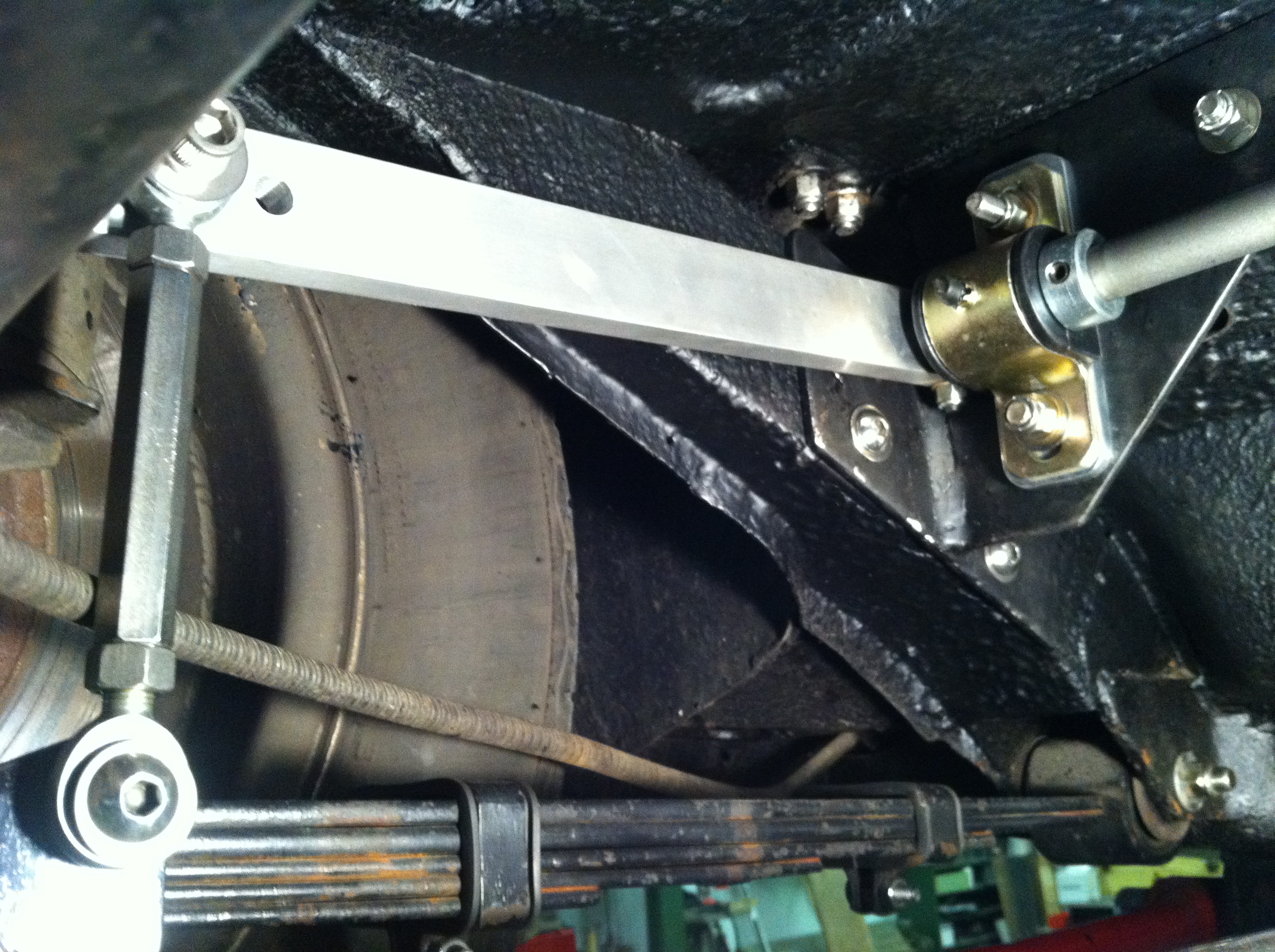

My car has a huge ( 1 1/8") solid front bar so I thought I would make a rear bar for years ago
Mine is 3/4 solid and I think the holes in the arm are 11",12" and 13". On the 'stiffest' setting, the rear definitely wants to come around so I set it a little bit 'lighter which is 892 inch-pounds ( about 75 lb.ft. ) and it seems about 'right ' I have staggered tires 245/50 on 8" rims rear and 215/60 on 7" rims front both with 4" backspace
Also have weld on traction bars , Minx spindles and the 'old' front suspension mod of dropping the upper a-arms
I haven't driven a stock Tiger since 1976 so have nothing to compare to.
One thing I'm curious about though is my car ( with aggressive driving )seems to oversteer slightly on right turns and understeer slightly on left turns
I have a bone stock panhard bar in the MK1 position. Is that what makes it do that ?? it's the only thing in the 'suspension I can think of that would cause it Anybody else notice that ??
