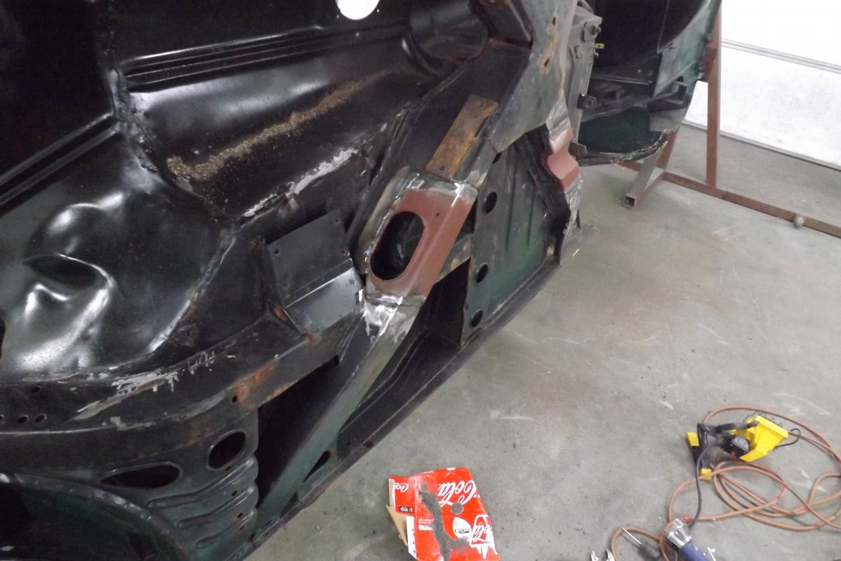

The tiger has sets belt mounting positions from the factory.
In the rear wheel arches in the back parcel shelf there are captive nuts welded on for the shoulder belts.
You can see them from inside the rear wheel arch...of belts were not fitted there is usually a nylon scree plug in there keeping the threads clean. You can poke a small sharp object through and that will locate it for you in the interior.
There are also captive nuts each side of the seats for the lap belts.
The issue with the shoulder belts is the low position of the mourning angling down from your shoulder. If you have a roll bar it would be better the shoulder belt is mounted there.
