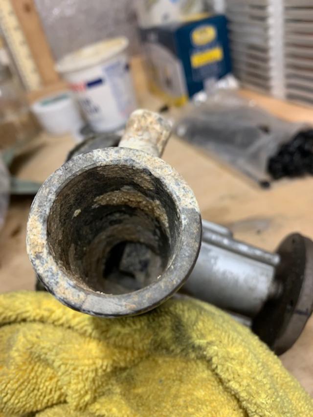

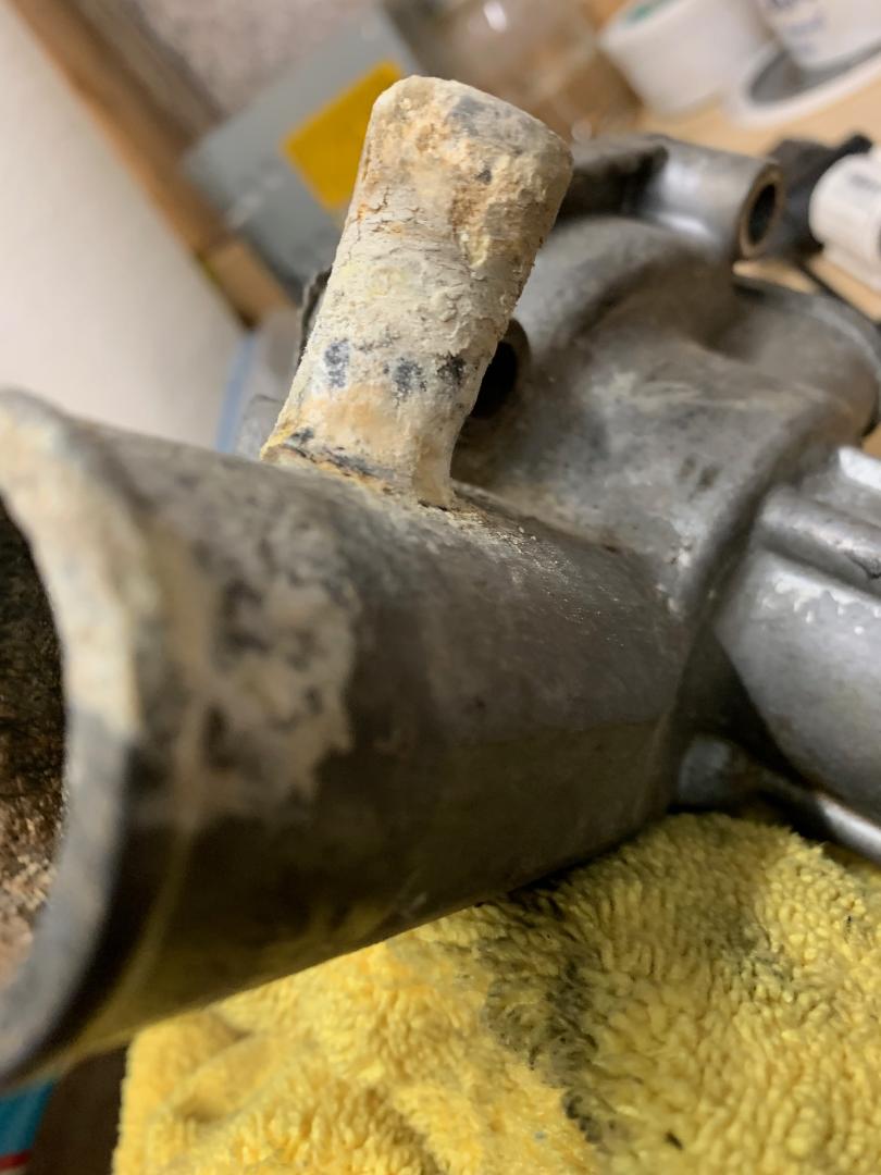

So, changed out my water pump, and discovered that it was an aluminum pump versus the cast iron one I installed. The aluminum one had a lot of corrosion. I was running 50/50 coolant. Any reason why there was all this corrosion?

Jim,
The alpine blocks have a habbit of build up of sediment in the rear coolant passages in the block and also casting sand. this leads to hot patches in the rear of the head but also more buildup of contaminated coolant.
Secondly the coolant will have an impact.. Was it a high glycol coolant ? The coolants with high temp resistance sometimes offer less protection against galvanic corrosion.
What i would worry about is if the pump has corroded like that is that the water passages in the head might have been corroded too.

The use of a preblended 50/50 conventional ethylene glycol coolant has rust and anti corrosion additives in the mix. Use of this coolant prevents problems like this. I've heard so many folks from warm climates that say the don't need to use anti freeze. They should use it to protect their aluminum heads and water pumps. It's not just an anti freeze.

I had also removed the thermostat housing, and the head didn't look too bad. There was some corrosion, now the question is; what to use to remove and deter any further corrosion?

I don't know how long you've owned the car but if you aren't the original owner then it's hard to know what coolant if any that previous owners have used. I've been involved in the Lube/coolant/etc. business longer than I want to admit but I've never seen a coolant additive that will clean out and repair previous corrosion but you can help prevent future corrosion by using a premix coolant which is blended with water that has had the minerals removed. Gosh only knows what is in the water you're using. Keep in mind that you need to change out coolant just as you do engine oil.
Thanks Beam, just what I was thinking, I thought the coolant I removed was pretty dirty looking. Something to watch and change out. I rebuilt this engine, so there wasn't a bunch of crud. That was 5000 miles ago, so shouldn't have been too much problem, but obviously it is. May have to think about a distilled water or something or just use the premixed product in the future.

If the Alpine engine is grounded like a Tiger then it is more likely an electrolysis rather than coolant issue.
A 50/50 ethylene glycol mix is great as protection against freezing, it is not however the ideal mix ideal for cooling, given that straight water is better for heat transfer. As pointed out, water however will raise corrosion issues if not used with a corrosion inhibitor.
If max freeze protection is not your goal, and overheating is a concern, then I would suggest a lower concentration of antifreeze, and/or a modern coolant alternative. Since you do not have an overheating issue, then carry on with the 50% mix, as the added corrosion inhibitor is a bonous
I have a sacrificial anode in my aluminium rad to guard against electrolysis.

T stat housings can be really bad too. I'm sure that P.O.s used tap water. My home water is so hard it cakes up on colored sinks. West Marine also has threaded pencil zinc's if you want to go with a hand made set up.

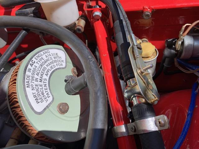

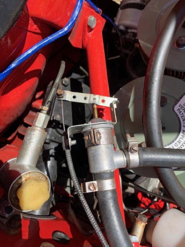

Well, after making a big deal of my engine not overheating, I noticed Sunday when I came home from Channel Islands British car show my temp was up more than I normally run. Sure enough it was a bit low on water. No big problem right? Well, yesterday after a little longer and harder run, I noticed the temp was now going way past my comfort level, entering my WTH!!!!!
The radiator was down about 1/2 gallon. With nothing showing as far as leakage. My first thought was head gasket? No, not boiling over or anything, nothing coming out of my exhaust.
Then I noticed overspray on the drivers side inner fender, and some drips coming out of the Heater Valve. Yep, imagine under a load and high temp and pressure, that coolant was coming out much faster than a drip on the freeway.
That's my third valve, time to locate something different.
I sure do like the original look of the Sunbeam valve, and I've tried the Honda valve, but this is getting pretty bad. The big thing is finding a Push to open valve. Most of them are Pull to open. I've seen all the postings on MGB valves and earlier Sunbeam valves, not too excited about them either. Will let you know what I find.

Interesting situation with dealing with the bad valves. I put a manual shut-off valve in line where the valve was, and my car is now actually running cooler than before. Pretty warm California day, and took about a 30 minute drive in the hills, and the gauge never got above about 80-82C. Normal running temp has been about 87-88C by gauge and temp. gun. Does that make sense? Right, not me either. But maybe????
In theory with the heater valve open and a core the cooling system should have more cooling ability. An additional radiator ( the core) additional capacity.. The core +extra hosing and also a longer circulation path to allow the water more time to cool outside of the block...
Is it possible you were always leaking a little and hence the system was not fully sealed/ pressurised or perhaps the heater core is a bit blocked and restricting circulation?
Just thinking aloud
Michael, yeah, about the way I was thinking. Certainly don't mind the unexpected cooler running car, but I guess the way to test it a bit more is to open the manual valve all the way and see what happens to the temp then. Will report back after my ride this morning.
(or maybe just magic?):p
Well, after about a 70 mile trip, up hills, down hills, freeway driving, street driving, stop and go driving, shutoff heater valve open, valve closed, this car just runs about 5C cooler than before I changed valves.
Gotta be something to do with radiator pressure? Only thing I can come up with.
Better colder than hot. (Not complaining) If it ain't broke.....
Fortunately here in So. California you don't need much of a heater. And I only drive with the top down, so I think it's fixed good enough for now.
I found a (push to turn on) heater valve that I'm going to look at, but after ordering it, I see it has 3/4 in. inlet and outlet. Way too big for our alpine hoses. Will need some reducing, but don't want it looking all clunky.
Continuing on, I used this heater valve and adapted it to the Alpine. I mentioned previously I've tried three of the "reproduction" heater valves, and each one failed, and this has been over a period of three years and at around $90-$100 each, kind of frustrating.
This is a push to "on" valve, so that worked out well. I've had to reroute the hose, but overall the function is good, and presents pretty well. Being a "ball" valve, I'm sure there's not going to be leakage, but only time will tell. Tried to bring the engine up to temp yesterday to check for leaks. And sure enough, I looked and there was a small drip going on. Not to worry, it wasn't the valve, or the hoses.

I got this one from Car Quest/Advance Auto Parts, but I believe readily available through most suppliers.
4 Seasons #74678.
Remember this one is a Push to Open valve. Still looking for one with smaller nipples, but haven't located one that's Push to Open.
