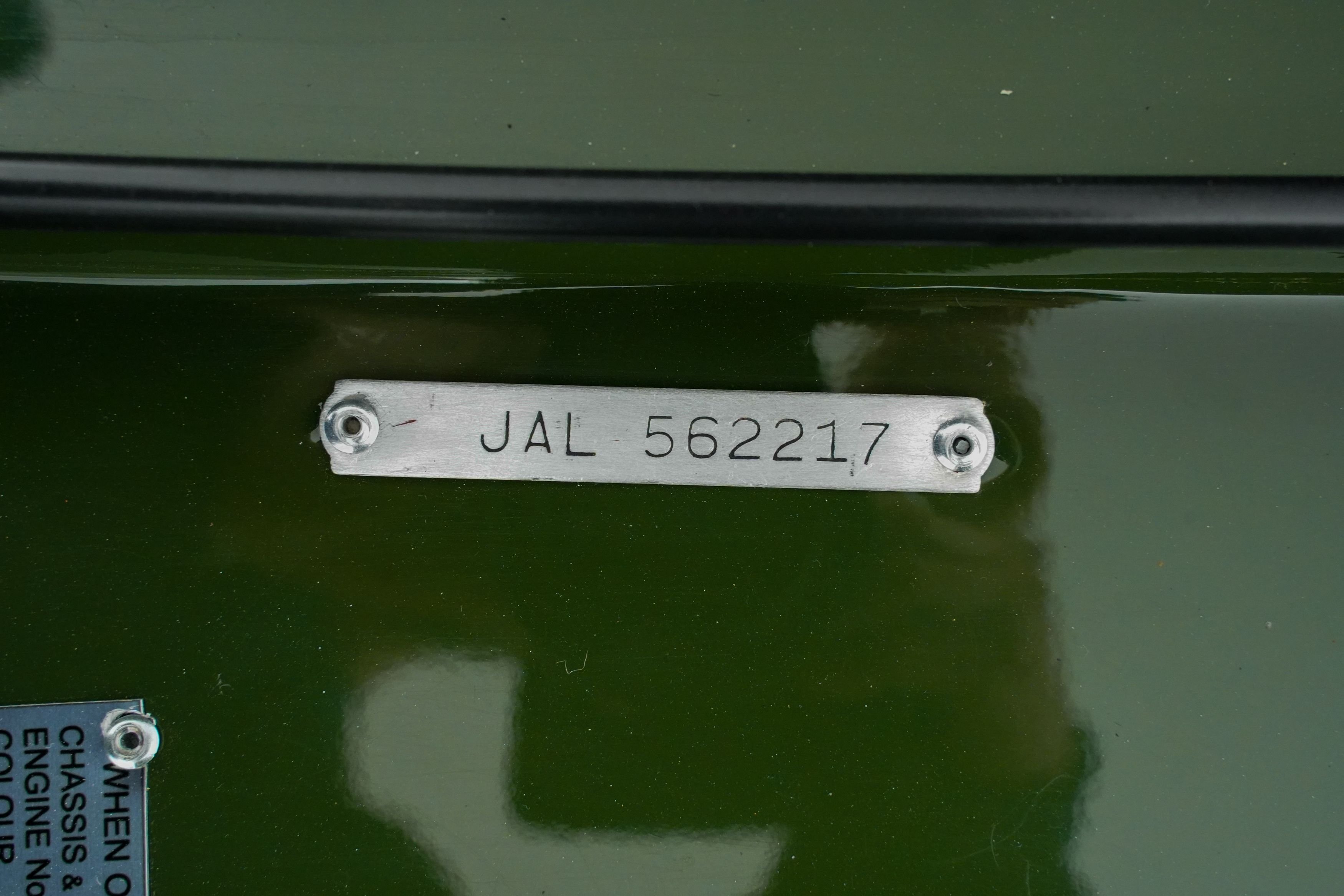

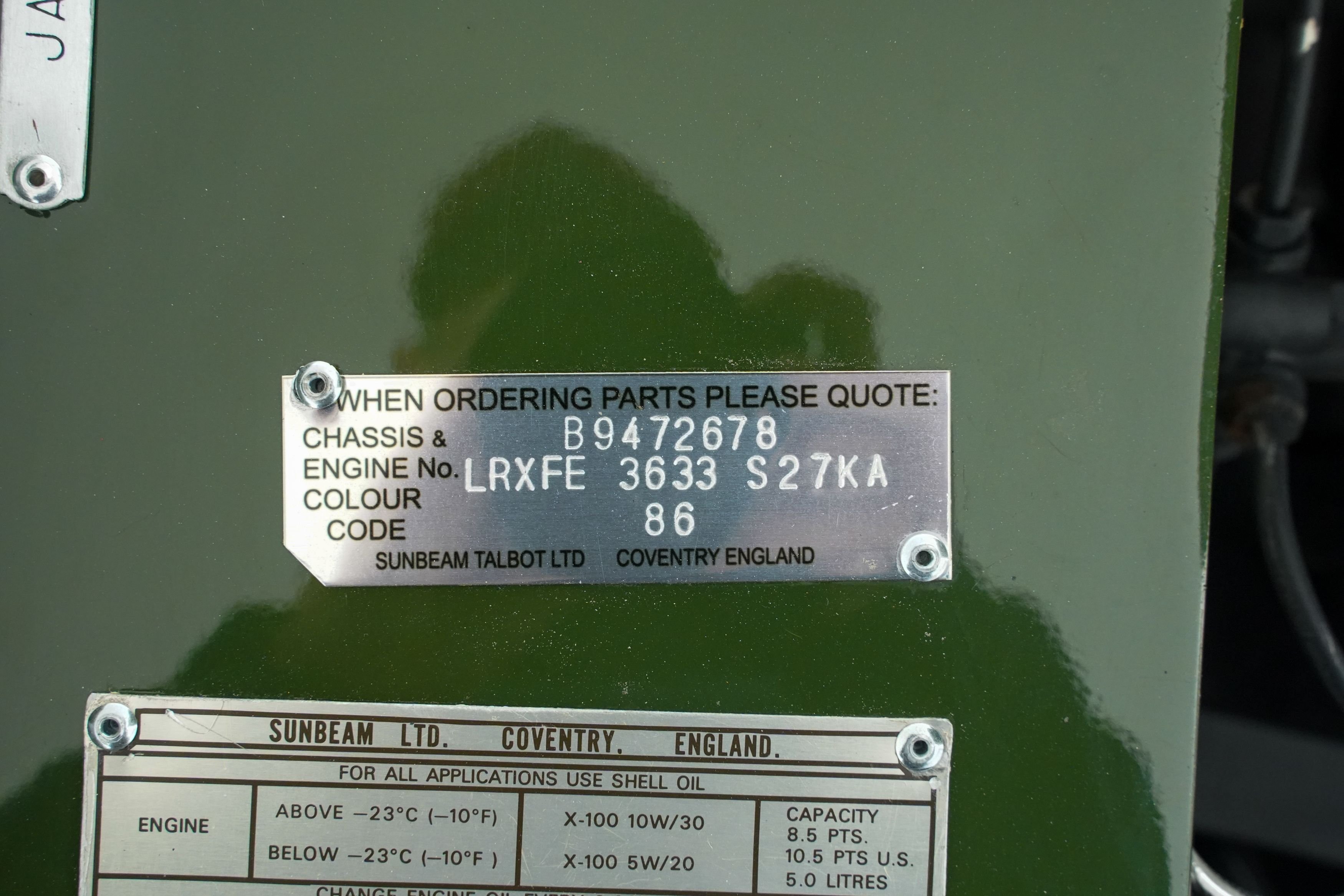

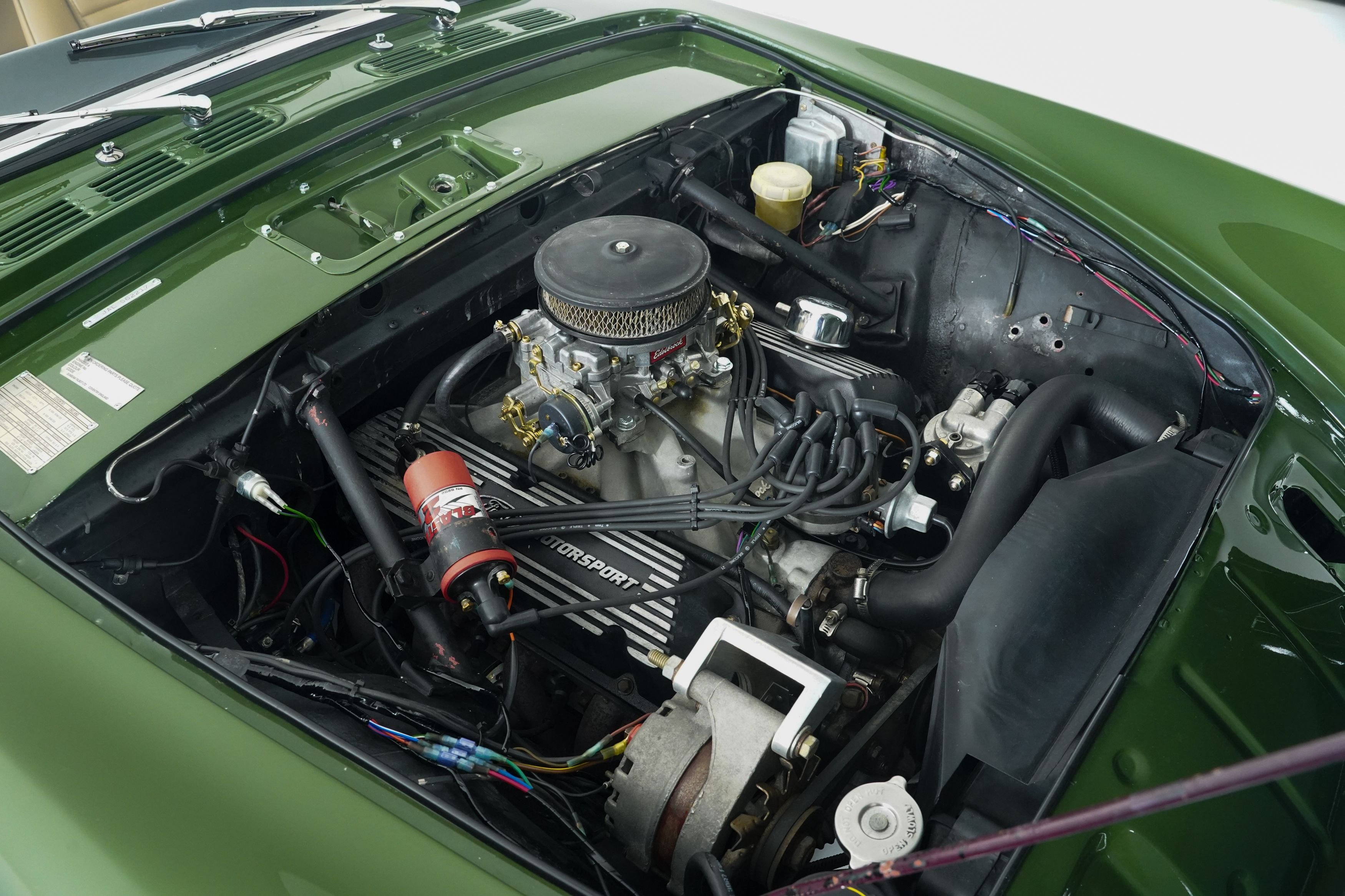

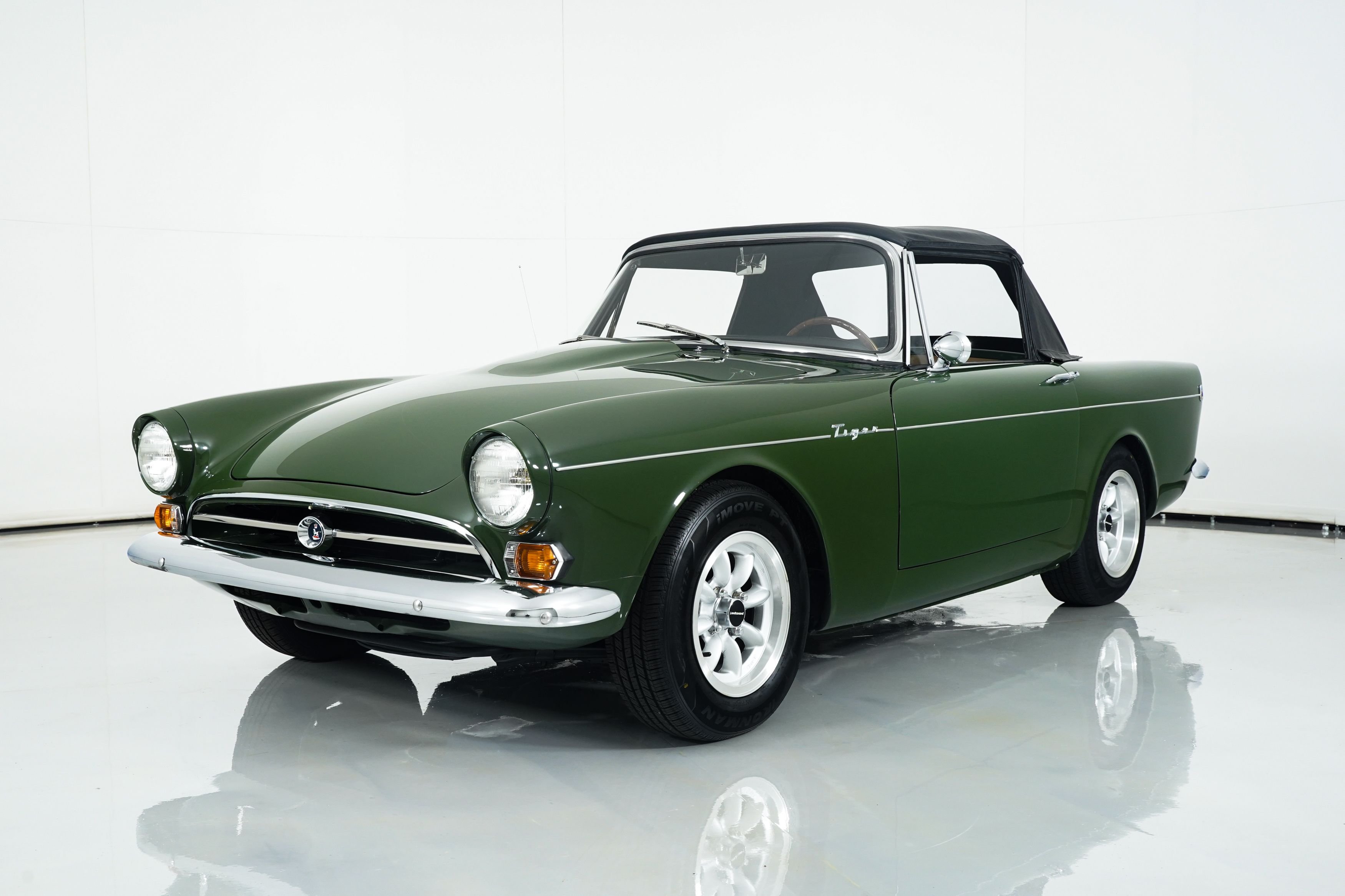

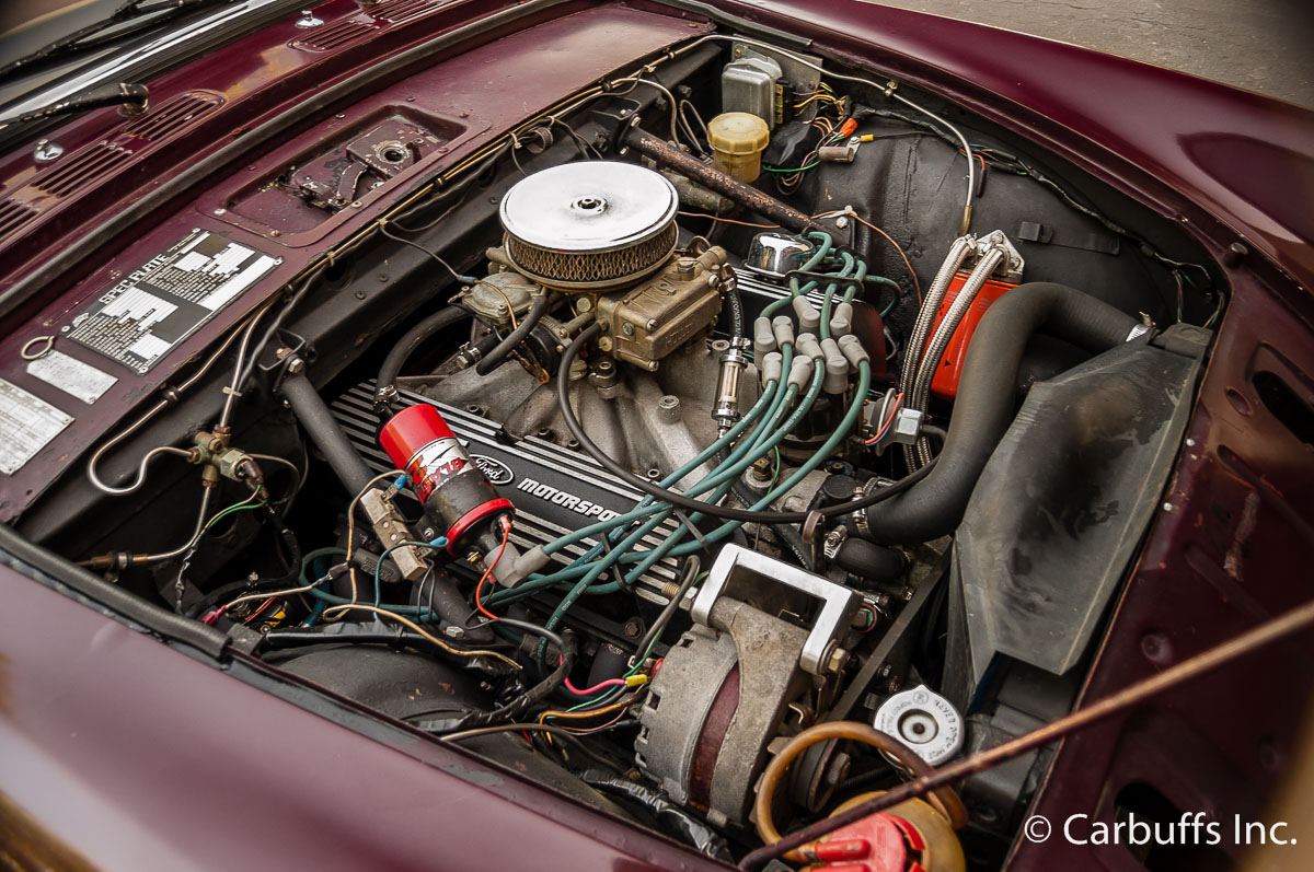

Well a dealer that has a well discussed midnight blue Alger also has another Sunbeam V8 in their inventory... Interesting tags on it... very straight engraving...and I Like where the LRXFE was engraved ... Didn't even have the original VIN tag to copy?
https://www.fastlanecars.com/vehicles/3109/1965-sunbeam-tiger-mk1

Granted, there are incorrect things about the car but the previous owner had to put a lot of time, effort and money into the build.

Looks like a similar quality of build as the green aloke you often post photos of, very similar looking car.
