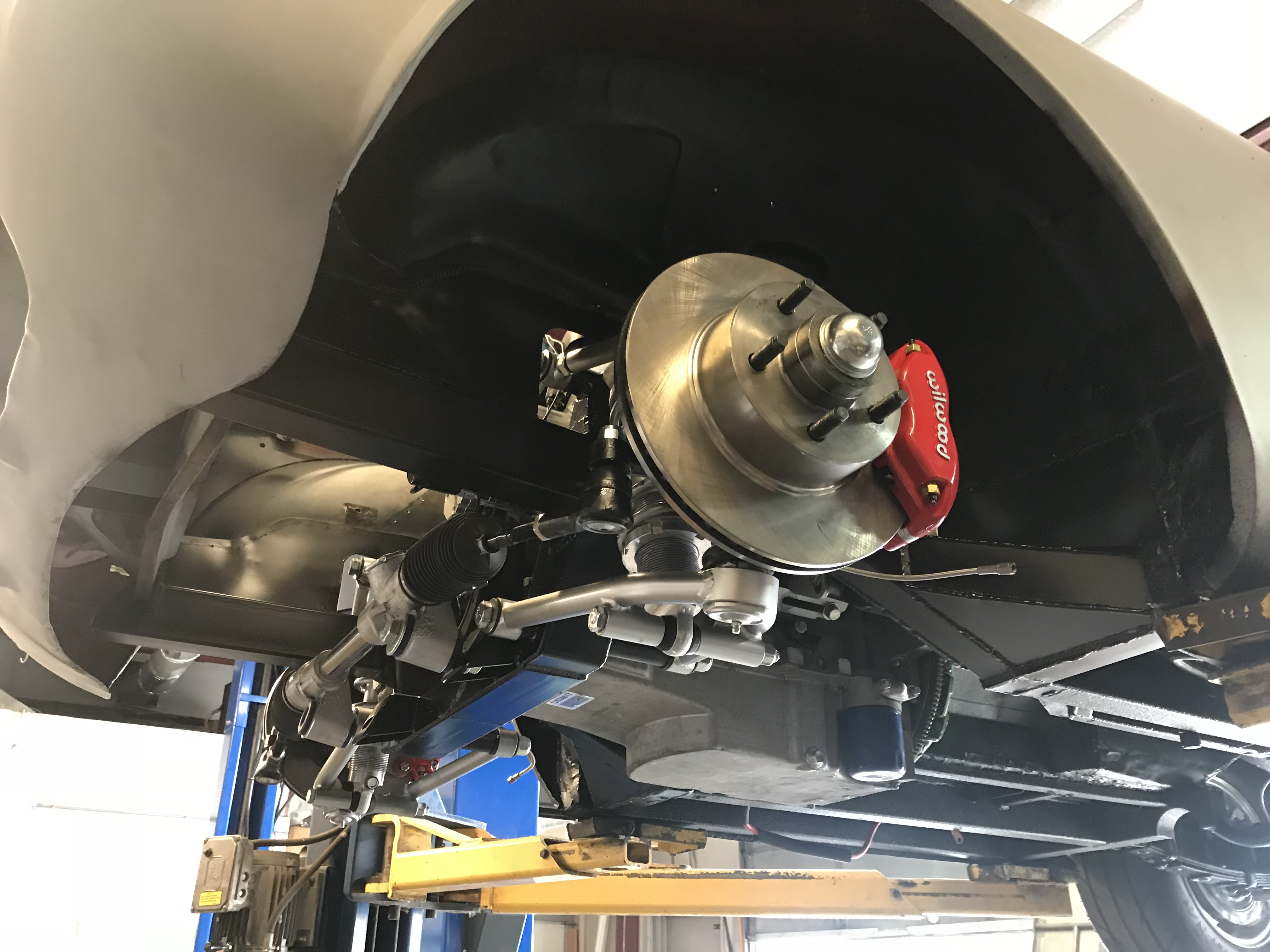

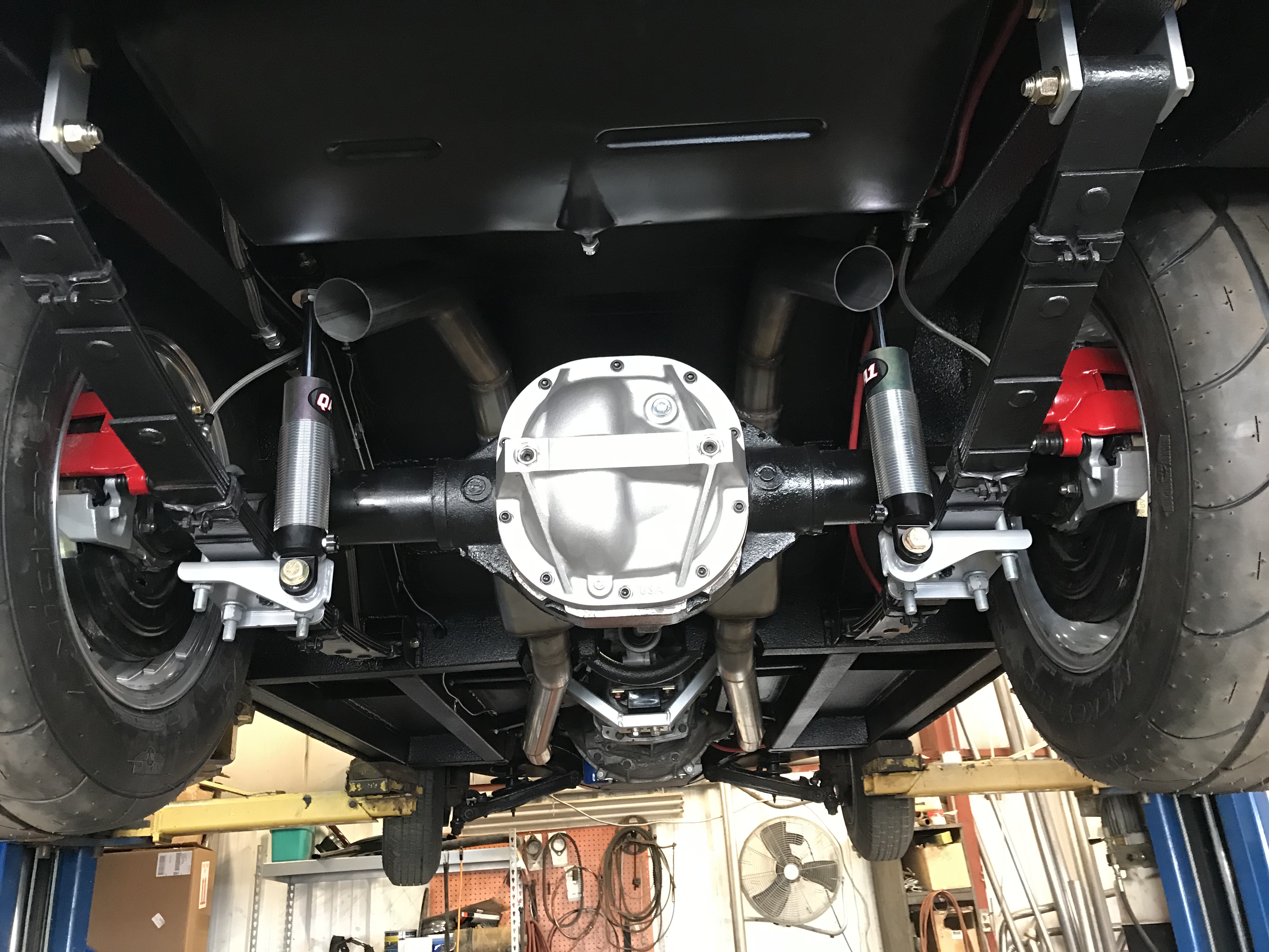

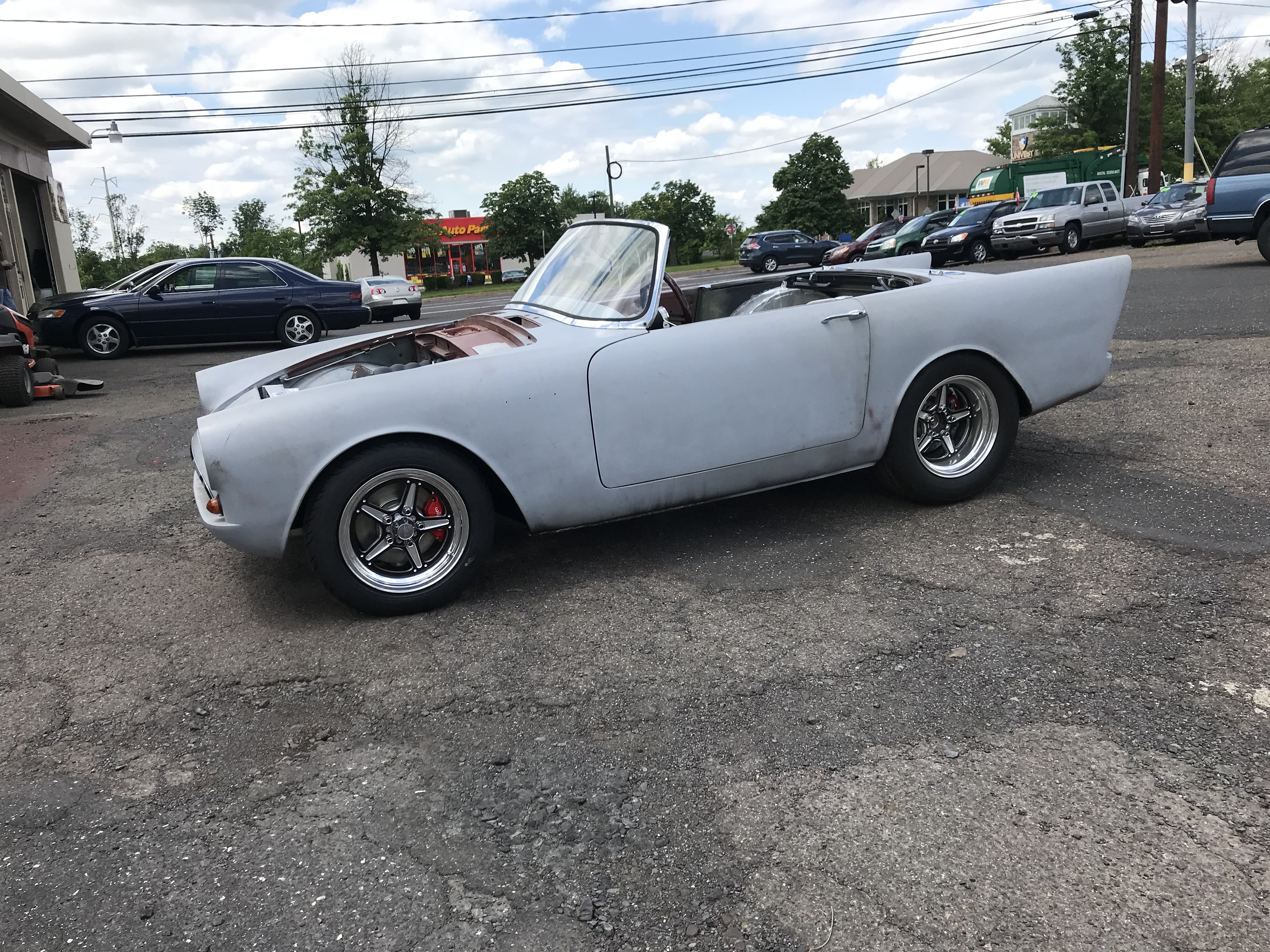

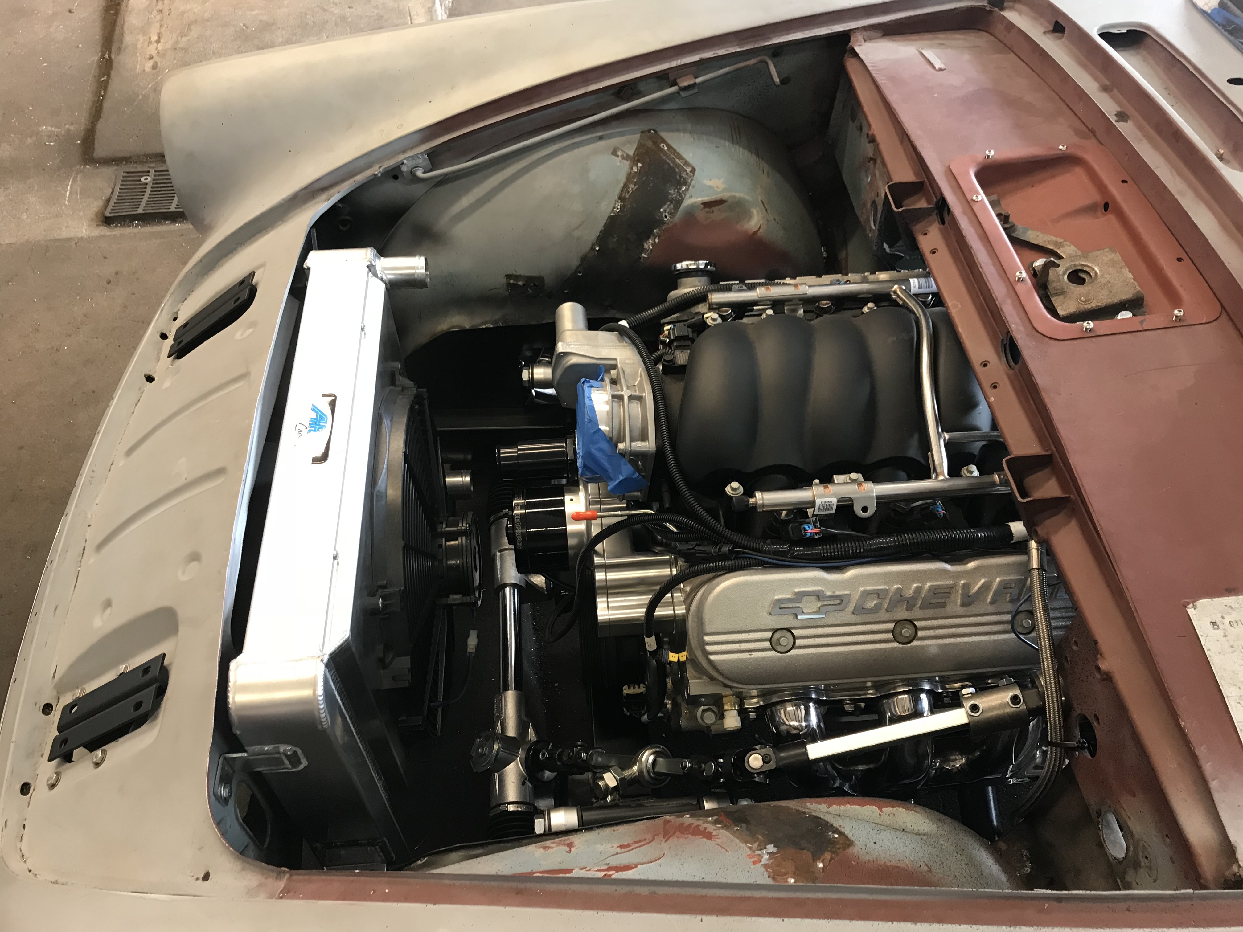

this project is 1 1/2 years old so far
removed floor and firewall and made 2x3 square tube frame then skinned body to it
installed crate LS3 /525 HP ENGINE using gm aftermarket harness
tremic 6 speed trans with monster clutch
ford 8.8 narrowed rear with 3.73 gears
4 wheel disc brakes
stainless exhaust
narrowed heidts mustang 2 front end with coil over shocks
billet specialty wheels
just started it last weekend
now onto finish wiring,dash install and brake ,clutch and gas pedals

Very interesting car. Keep posting progress. How are you controlling wheel hop? Cliff

Needs a new name
From the picture, it looks like a series III Alpine body, so it was never a Tiger. A Tiger is a specific series of cars produced a certain way with corresponding serial numbers with a starting and ending date, At United at Sacramento several years ago, a couple came over from England in a Sunbeam that had a "Tiger" title. It was a unique car which appeared to be an authentic Sunbeam which had an official title of "Tiger." Then couple tried to get it authenticated but were told that Tigers are only those specific cars, etc.
The point is this looks like an interesting well done modified Sunbeam, but it was not a Tiger, and should not be called a Tiger." If we step away from the Tiger name, it can be appreciated for what it is. My thoughts, Cliff
