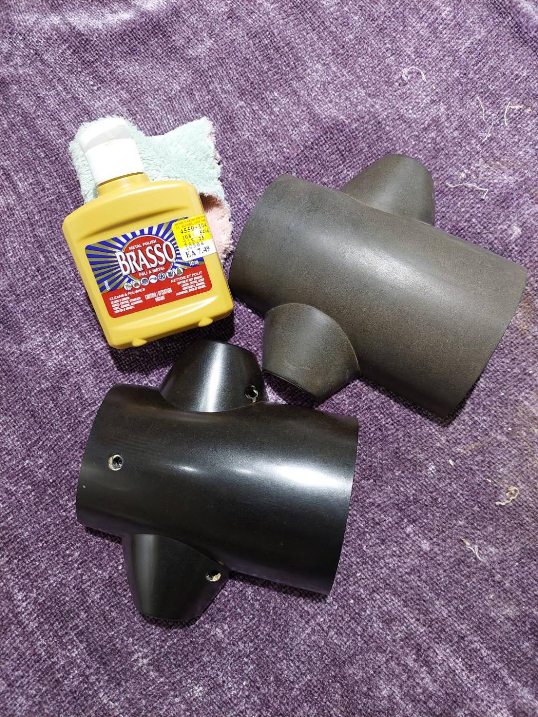

Switch cover restoration
Hoghead
598
I googled Bakelite restoration and Mrs Hoghead supplied the elbow grease
1,292
Many years ago, I bought some plastic rouge (polish). Used it with a buffing wheel on an electric drill mounted to my workbench and really did a great job on the various lenses on my car. I did not think to try it on what Rootes calls the upper and lower cowl. Would definitely want something that is not too aggressive. Always a good idea to test in an area normally not visible.
Bakelite was used on the shift knob and other places. If it looks too good it's plastic. I'd love to ding a car in concourse stock judging for a plastic shift knob etc. ;)
I have used rubbing compound black shoe polish etc. I guess it all depends upon how bad yours is you could start with 220 or 320 to get the oxidation off then work your way up.
Hoghead
598
I think that you can easily buff through the top layer of the Bakelite, into the porous interior layer. Hence Brasso and elbow grease rather than a buffing wheel
