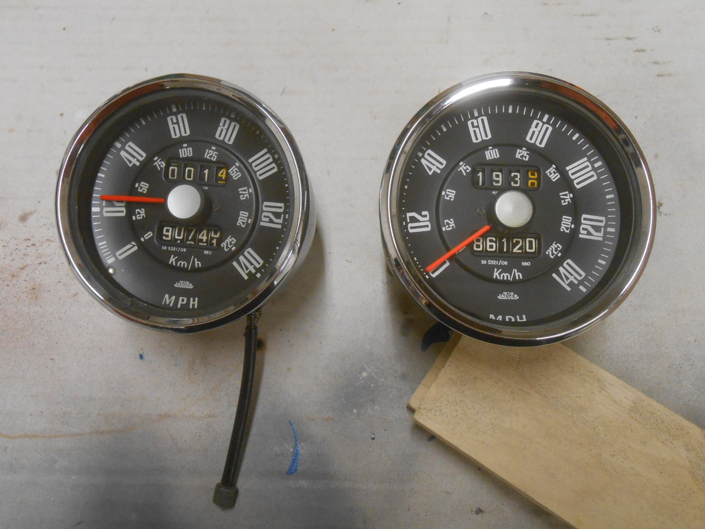

I have two Tiger speedometers, one seems to be working fine, the other was frozen solid with 40 years of dried grease. Took that one apart, cleaned it , replaced a bad plastic gear with an Alpine gear, put it in the car and of course it's not running correctly. (When it's at idle it reads 10 mph, when you're going 30mph it reads 60 mph.) Before I send this off to MO-MA and spend $400.00, I'm wondering: does anyone know of any other places I might send it off to? Also my rear housings don't match, making me think that one of these was put together with parts and pieces. If someone could tell me which is correct (or at least more correct) I would appreciate it.
