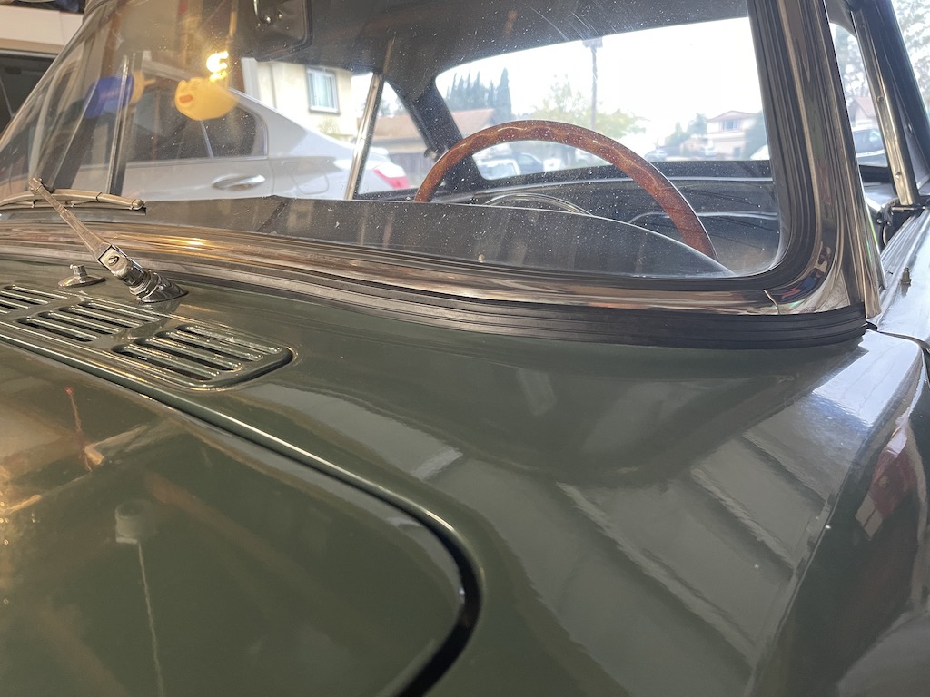

While installing the windshield, I discovered that the frame was badly rusted underneath the chrome, which was not visible from the outside. I had to source a new frame. It was in better condition, but still needed rust repair in a couple of spots. So after a long detour to get that fixed, I installed the windshield last week, using the method showed on the "Life of Ti" website.
As you can see in the attached picture, there is a gap between the seal and the body. This is after being tightened it down quite a bit. It does not seem that further tightening will eliminate the gap.
Has anyone else encountered this and have a recommended solution?
Thanks,
Marty

KenF
397
I did mine a few months ago, not an expert by any means. I found it fitted better without those rear adjusters I had bought from SS. I'd be tempted to set it on the cowl without the gasket and see how the frame gap looks.

On advice from a friend that has restored multiple Tigers, I went with the factory shims over the adjusters. Unfortunately he lives in Florida. I have a message into him for further advice.

Hey Marty, any further resolution? Id like to see the bottom of the frame itself, along with how you sealed/mastic/caulked it AND if i Recall correctly, that rubber seal could be inverted 180deg as well. But, its difficult to see if the frame without the rubber there would really have a large gap (although it does look it from this photo). Finally, the dash pad itself (under the frame) is much thicker when new than the original compressed pad is (was). I shaved quite a lot of foam, almost to the plastic to thin it.
Im not a multicar expert, only had the one car to try and reproduce, but the original had never been removed, hence my ability to duplicate fit. Even then... you run into other potential issues with quarter window and hardtop (you have one?) fit.

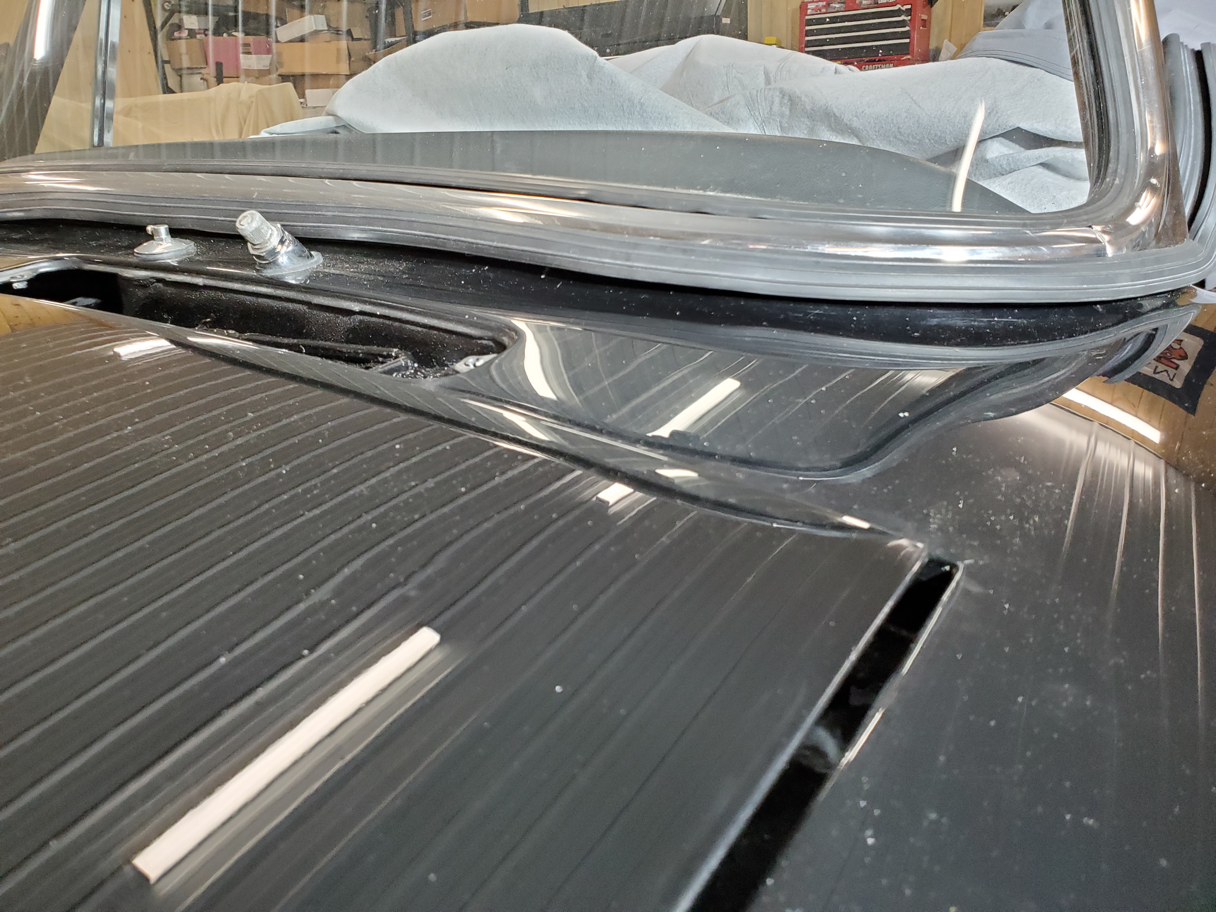

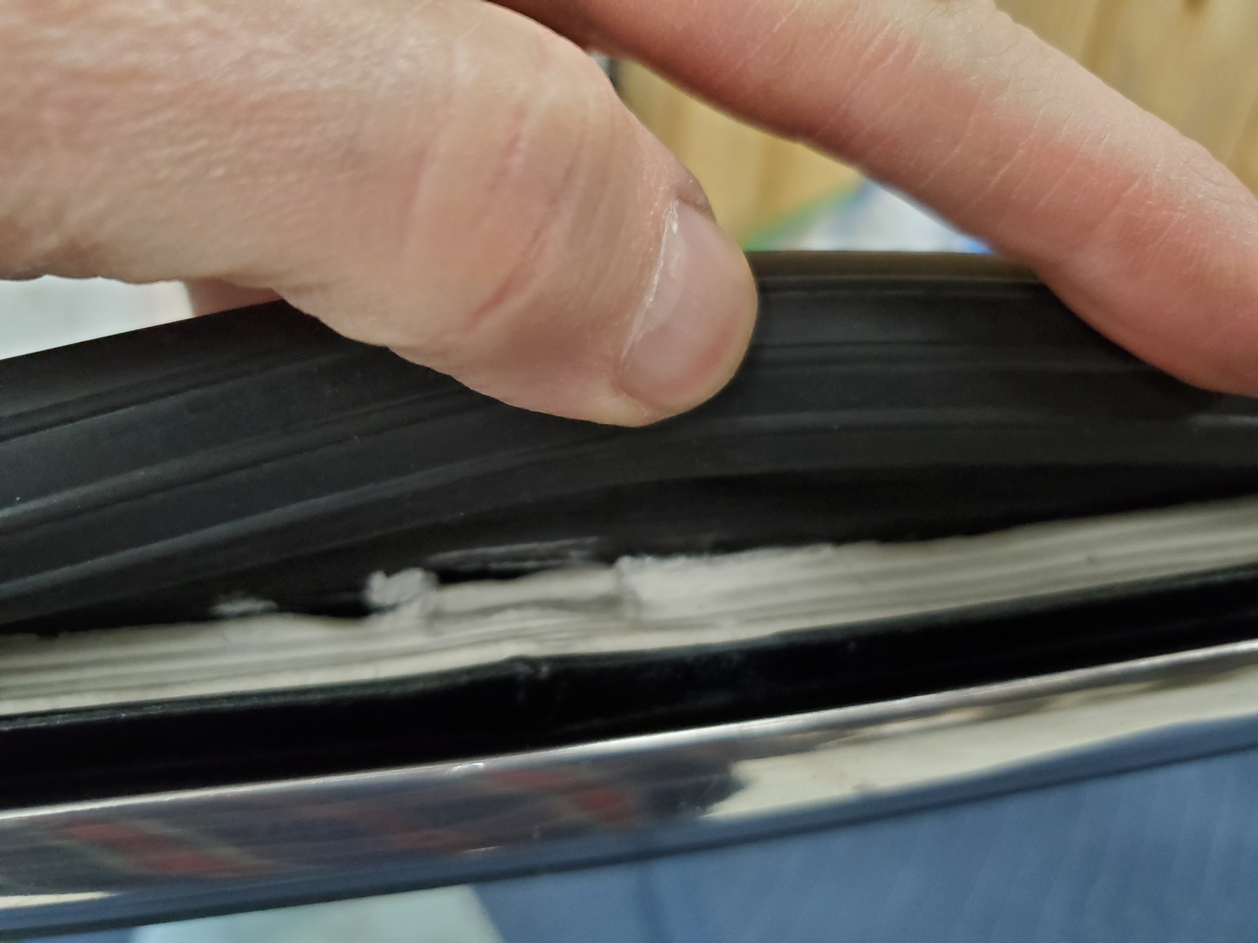

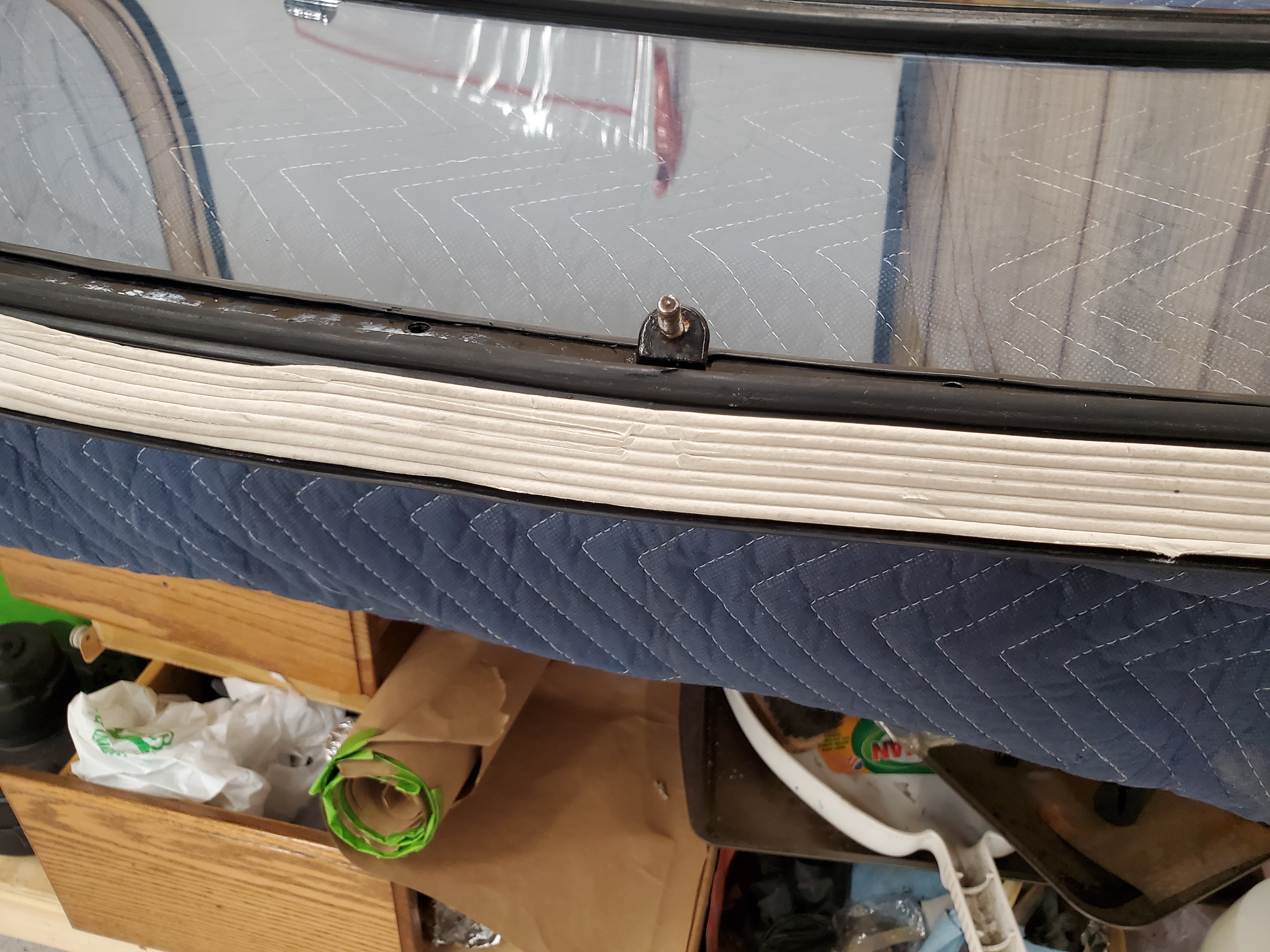

I got out to the barn today and removed the frame. Started hand sanding the underside of the dash pad to thin it out. That got pretty tedious, so I broke out the Dremel tool. What a difference. The Dremel made short work of the foam backing. Without the foam, the pad is quite thin.
I took a few pictures of the seal area. The caulking seemed to compress very little, if any. I think I definitely need to thin it out at least between the seal and cowl. I am not sure if I need to thin it out between the frame and the seal. It seems just to fill the void in that area. What do you guys think?
