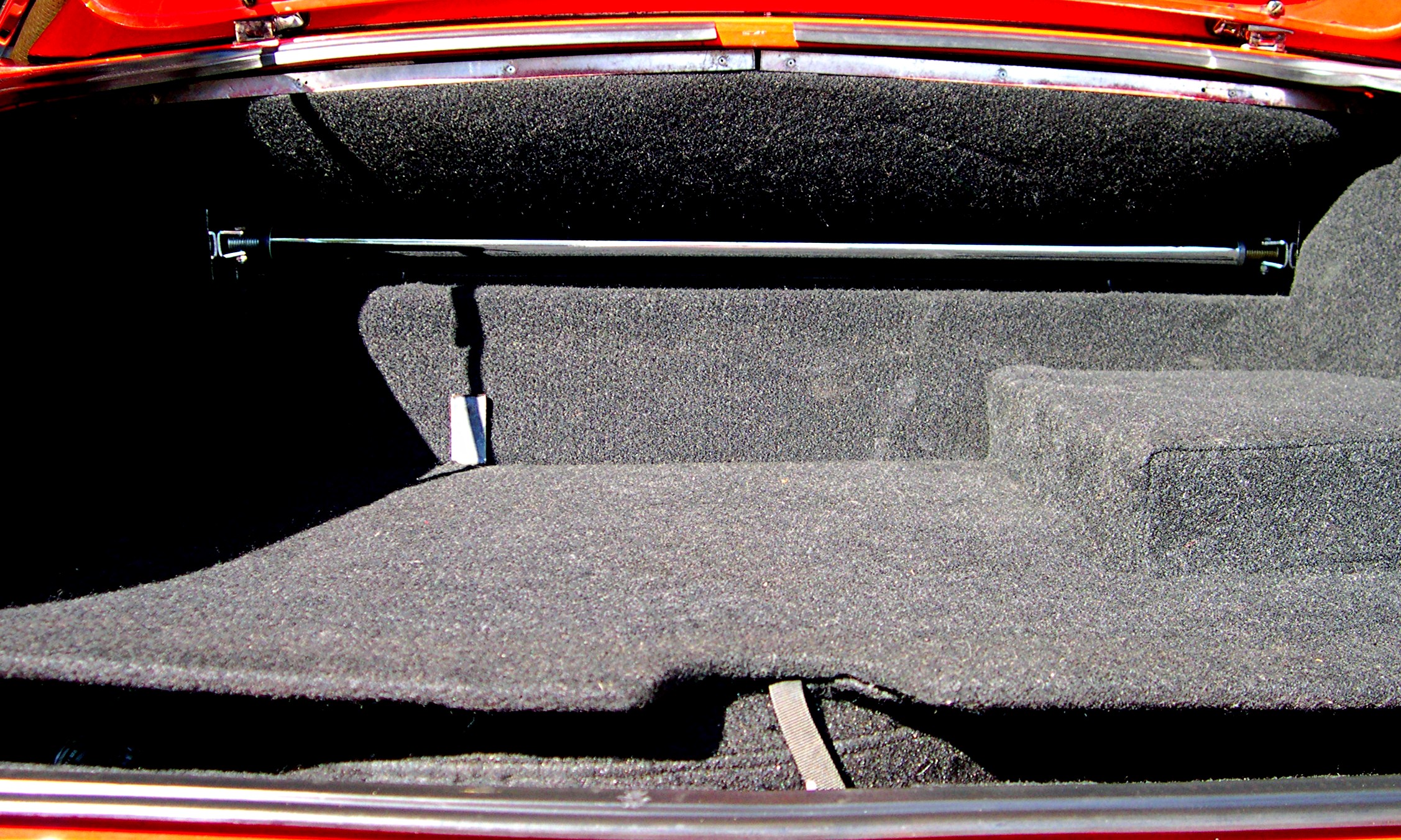

I've been in the same situation for decades- the 'floating' floor- and it hasn't ever been an issue. Because the P.O. carpeted everything, I don't even hook the trunk floor at the back. Super easy to just take the entire cardboard piece out if I need to access the spare or the battery. And, to the point above, I've never used the spare. I rationalize that 'tis better to have the spare the exact same size (and meatiness) as the other tires...who knows how long you'd have to run on that skinny spare? My 2 cents.
